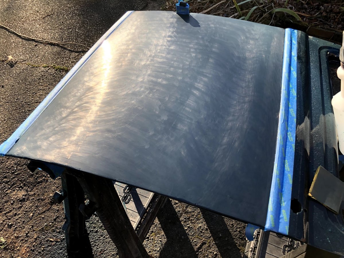

    And so it begins!! I've cut the majority of the runs down and have started color sanding. For some reason I got on a roll and just didn't stop to take pictures. Everything is turning out pretty good so far. My friend C***ie came over and helped me wet sand and we got the cowl all the way down to 2500 grit. It's ready to cut and polish. Just taking it all one panel at a time. I'll get some more pictures for you guys as I go. Sorry for the lack of visuals. I'm pretty excited about how nice it's turning out, though. It almost looks like I know what the heck I'm doing.
    More soon!

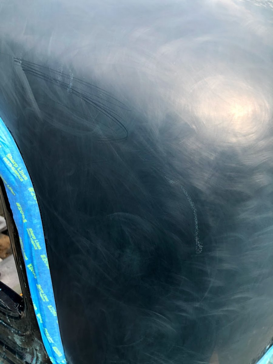

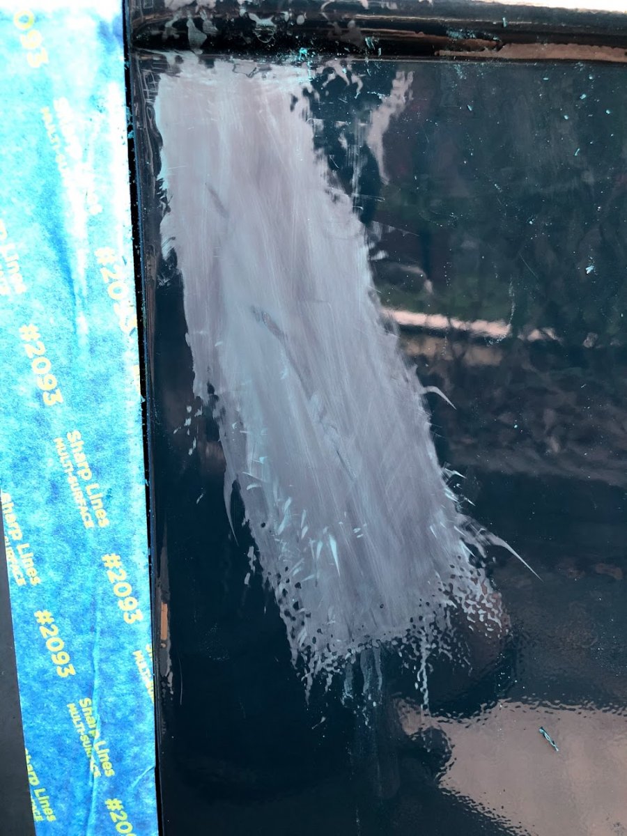

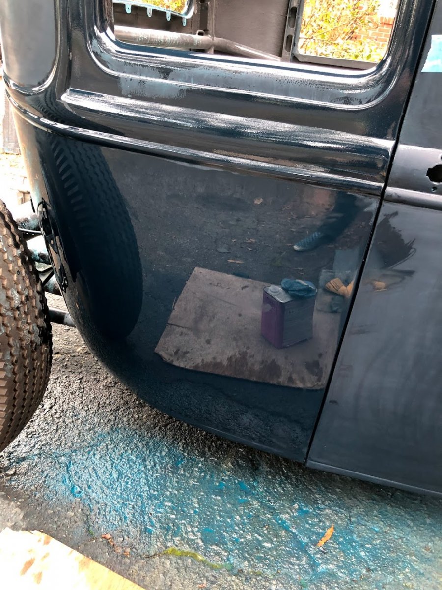

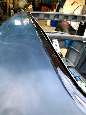

    SO much has been going on with this, so I figured I better put up an update. Color sanding is in full swing and I think I'm going to have to get an arm, elbow, and shoulder replacement when this is all over! HA!
    Mostly color sanding is going good, but I've had a few issues with my results.
    Let me start with that scratch situation from the shop light falling into the freshly painted car. After prepping the scratch and building it up real good with several brush applications, I was able to treat it as if I were cutting a run. The biggest scratch below the belt line was able to be saved. The others above it I had to take other measures with and still don't have repaired. Here's the cut-down and block-out of that lower scratch. Like it never happened...
    Once I finish cutting that whole panel I'll post some pictures. I have a lot more to do in that area, but successful repair, overall.

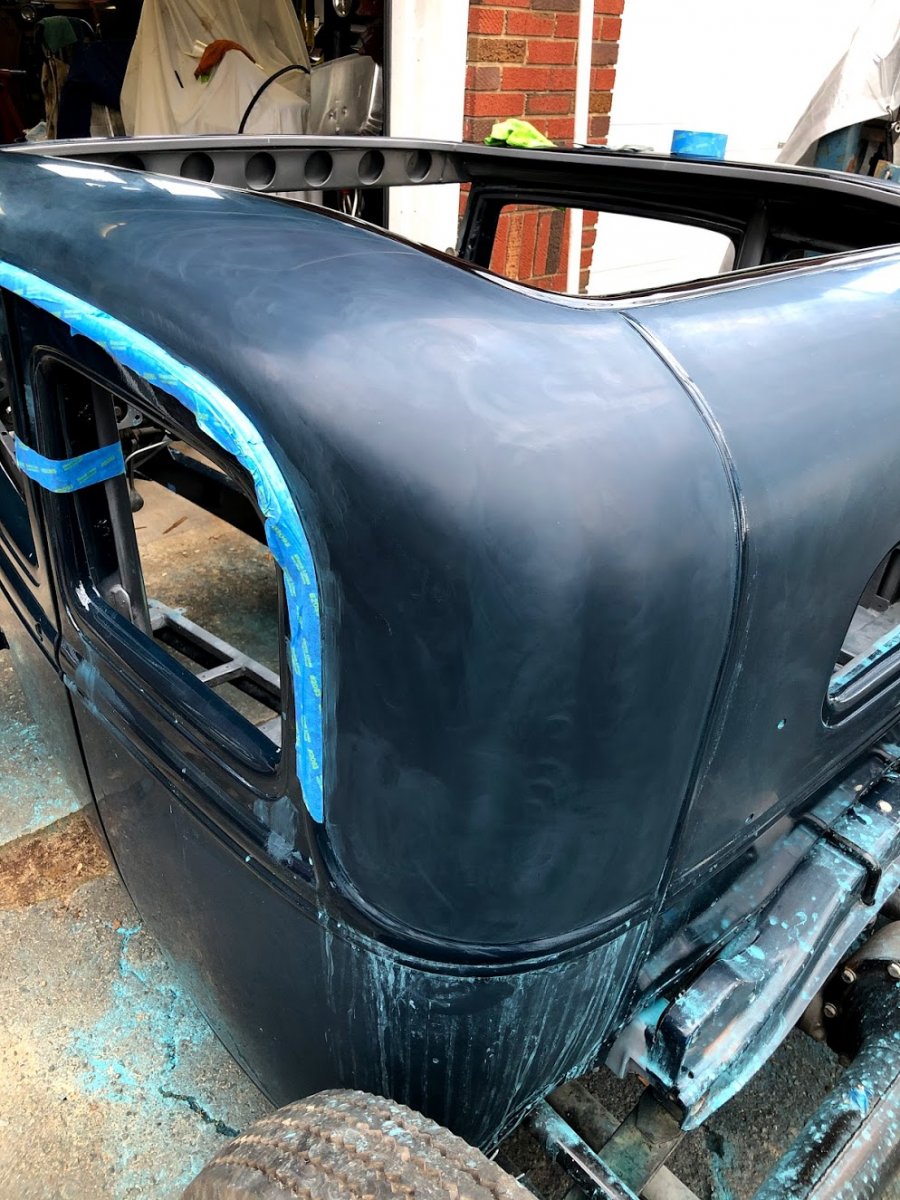

    Before I continue, I just want to say that I just really **** at this part of the build. I have definitely learned I am NOT a paint guy. Slowly but surely it's coming together, but this doesn't come naturally for me at all, so it's a struggle every moment of the way. But, it's going to be alright... or at least that's what I keep telling myself.
    This paint job had a TON of runs in it. I got really good at cutting them with some neat techniques I learned via the University of YouTube, but unfortunately one of the runs caused some issues I'll get to that. First, here's some progress. Pretty much the entire car, with the exception of the body lines is all color sanded to 2500 and ready for the next step. Here's some visuals.\

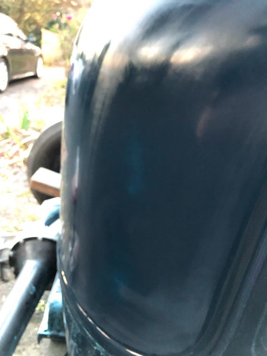

    The unfortunate part was somehow going too far on the right rear roof corner. Not even sure how I did it. I was being really careful, and I guess I didn't have as much material as I thought in that area. You can just make out the lighter blue patches in the below picture.
    And on the opposite side, I had a run that happened on the first p*** and apparently didn't fully get all the solvent out between coats, despite giving it quite a bit of time to gas out. So I got a bunch of tiny little bubbles that exposed the primer. So strange.
    Seemed the only good solution was the re-spray solution. So I re-prepped these sections and re-shot them. The results were pretty good and I think another save.
    That was pretty disheartening to have to do, but thankfully, the day after Thanksgiving was warm and I was ready to lay paint!
    Next up: DOORS! They turned out pretty good! Standby...

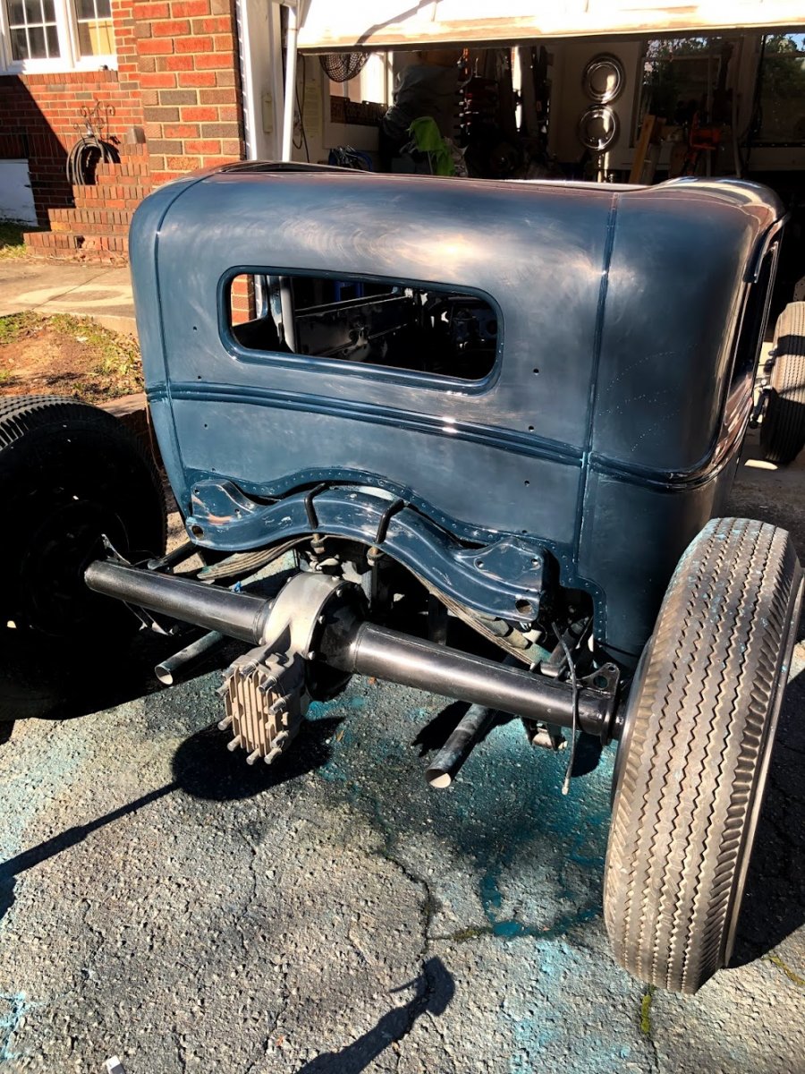

  7. scootermcrad
    Joined: Sep 20, 2005
    Posts: 12,383
    scootermcrad

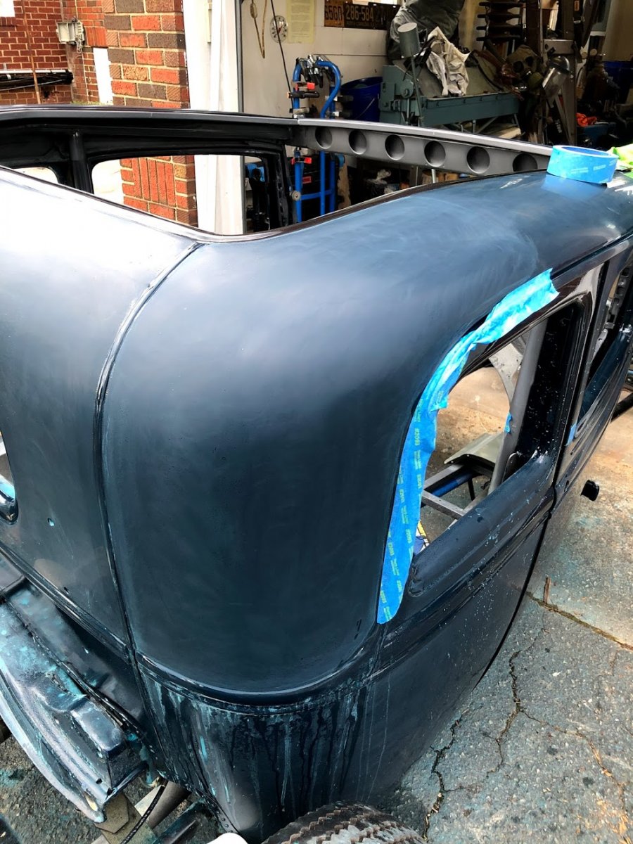

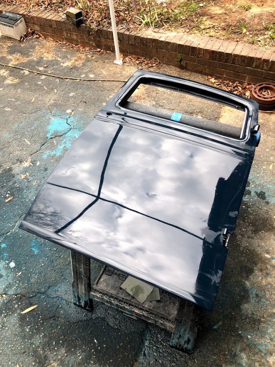

    DOORS! They had a **** ton of runs, also. I really developed my run cutting skills on these doors. They turned out pretty fantastic, I think. I'm pretty embarr***ed by the initial paint job itself, but I'm psyched I was able to salvage the paint job.
    P***enger side door had the same issues, but cut out just as nice.
    The polished look on these panels is just a wipe down with wax remover to see how I did and make sure I didn't miss anything. Success, I think. So then I was able to see it on the car, for the first time and take a step back and look. Pretty stoked to see everything all one color.

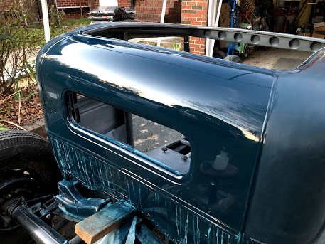

    So then I just continued around the car trying to get all the panels to 2500. More to do, but pretty dang close, now. Still have some details to wrap up on the re-sprayed areas and I still have to make repairs to the other scratches and gouges from the light. May end up having to re-spray the left side B-post to make the fix. Pretty bummed about that and it will have to wait until spring, if that's the case.
    IMG_4753.jpg IMG_4755.jpg 62957931444__CA33EC0B-5B90-4C8A-A30E-2A9896357FFE.jpg 62949983093__3DA93116-CA1F-43C2-B546-3D29B09EF88C.jpg 62949977219__50B06968-BB2D-4625-B821-252CC4DC8DCB.jpg

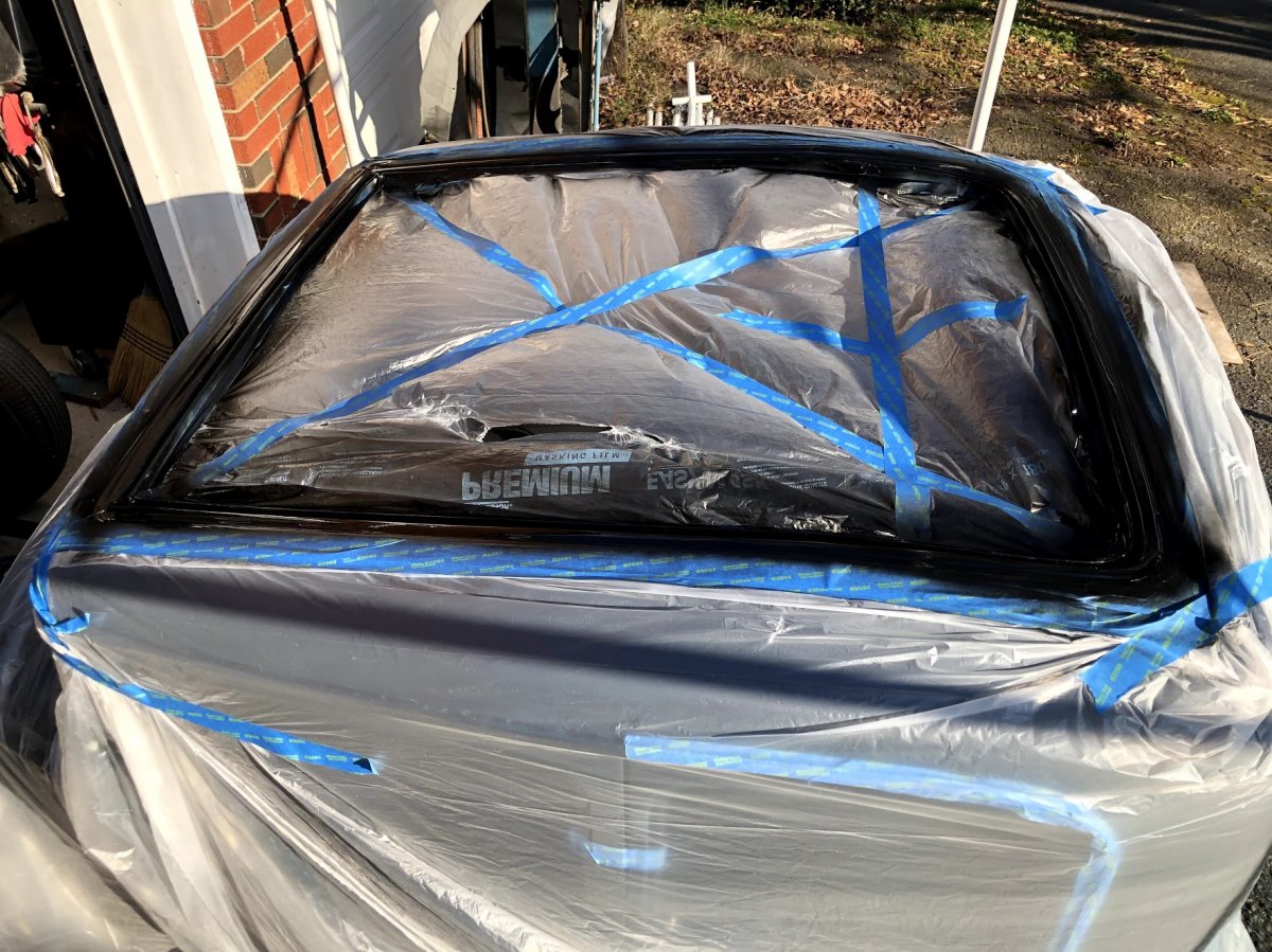

    Last thing I've done up to this point is paint the area where the removable roof insert gasket sits. I wanted this area to be a semi-gloss black. It turned out to be a little glossier than I wanted, but that's okay.
    IMG_4874.jpg IMG_4875.jpg 62950135046__FE44673D-B340-4C6A-A897-835B6EA2DD59.jpg
    The gasket sits right on the color split, so most of this is basically out of sight out of mind.
