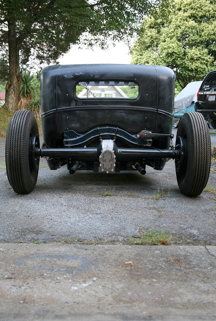

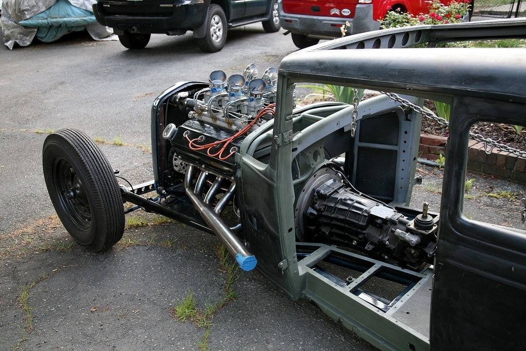

    Alright, alright! I have a small update for you. Nothing too exciting, but a good update none the less.
    Rear brake lines are formed and mounted, bottom of the body painted, fuel shutoff switch mounted in the rocker area, rear exhaust pipes for the cutouts done and and cut to length, and that means it was really just time to put the body on, and I think for good!
    Was getting really frustrating not having the room to work in here. Every inch counts with all this junk in here...
    Brake lines...
    Probably seems weird to see brake lines on the OUTSIDE of the frame, but since the car is channeled and has really beefy rockers, it made way more sense to run them outside then to try and wiggle them inside with everything going on under the floors. Fuel lines will also be run outside.
    Standard coated steel lines with stainless steel tabs.
    I also wanted to keep the rear axle completely free of brake lines, so there are flex hoses at each wheel. I tucked the tee fitting up under the frame rail away from the exhaust, suspension, and will also be protected by the storage compartment in the rear of the body, once it's installed.
    After the tee fitting the line runs in front of the rear Model A crossmember, just above the lip, around the battery tray, and swooping up to the hose fitting and mount.
    Wish never took a good shot of the line running over the crossmember, for some reason. I'm definitely rusty on my picture taking lately. Guess I'm out of practice.
    So with that, I guess the ch***is is pretty well ready to accept a body again.
    Touch down!
    And back on the floor. Always feels so good to see it with the body back where it belongs.
    Yesterday I rolled it out in the driveway to stand back and look at it again.
    I know the worst is still yet to come, since I really don't LOVE finish work at all, but at least it's starting to look like a car again.
    Next up, I'll put some leather welting between the body and frame so it doesn't squeak, then tighten all the mounting bolts and check door alignment to make sure nothing has moved, through all of this. As long as all is well, then time to finish up some body work. I still need to strip and prep all the garnish moldings, media blast the window regulators and a few misc parts, and then go to work on the details. LOTS of little things left before I can start final paint.
    All I have for now. Nothing you haven't seen 17 other times, but at least it's still going after almost 10 YEARS!!! :gasp:

    What is this one shock rear suspension setup? Some kind of trick NASCAR/HaasF1/Tony Stewart ****?
    vic
  12. scootermcrad
    Joined: Sep 20, 2005
    Posts: 12,383
    scootermcrad
    Thanks guys! Feels super good to have something more done. The little stuff is KILLING ME!
    HAHAHAHAHAHA! It's top secret! ;) I was wondering how long it would take before someone mentioned the one shock. I found the other one in a box the other day. I need to pull all of them off and paint them. They have the original paint on them and aren't looking too hot. Another thing on the list. :mad:
