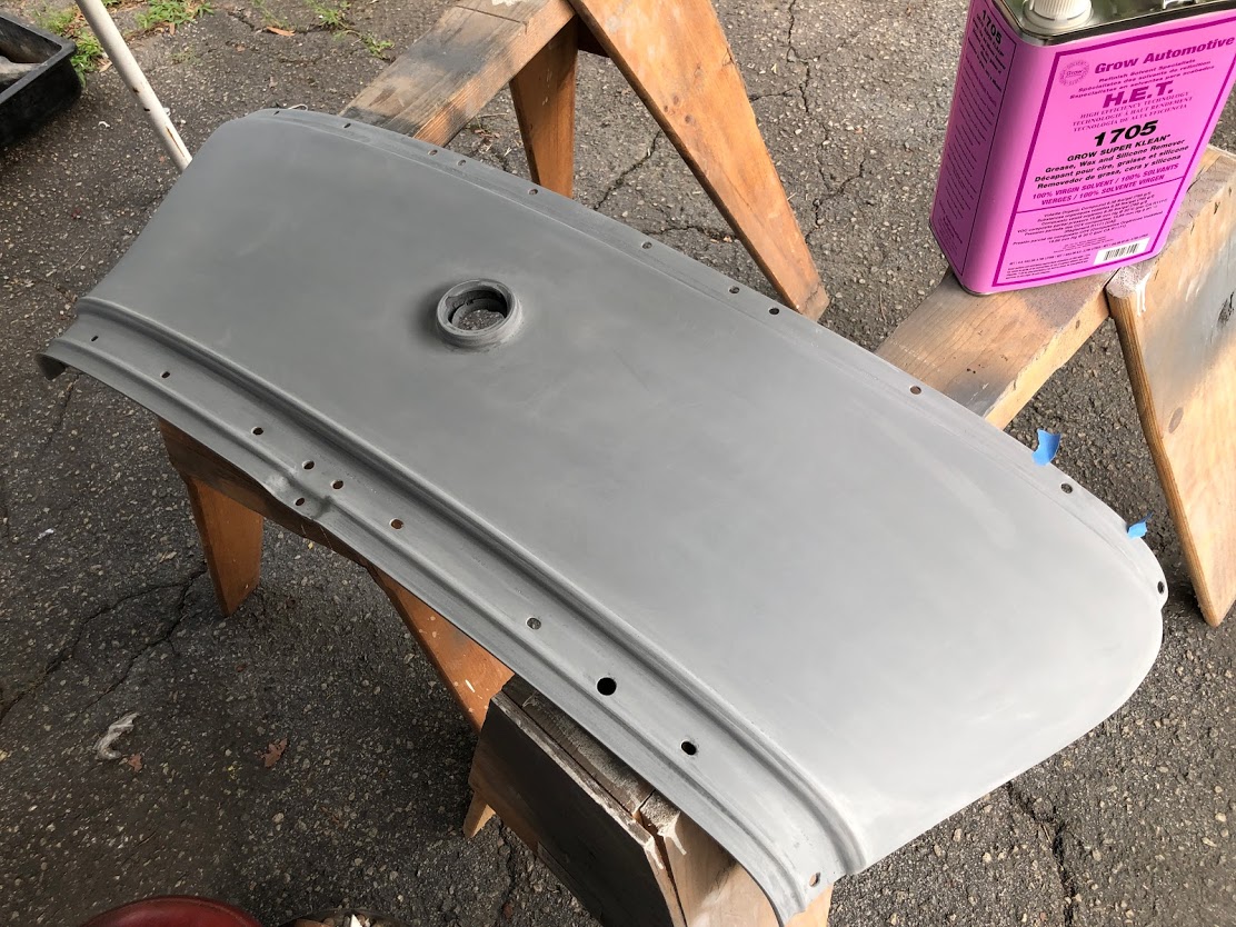

    I've been mostly working on the cowl top to get myself back "in shape" for my painting routine. I figured this small-ish panel would be perfect to make sure I'm back in the groove before moving on to the rest of the car. At least if I screw this up it's not too bad to fix.
    The cowl top needed a skim coat around the rear portion because it got damaged during mock-up. So stripping everything back after sitting and redoing the minor filler work I was ready to lay some high-build and block it out.
    Cleaned up with some surface cleaner I got a good preview of how true the panel is.
    With the panel basically ready, minus some touch-ups, we're ready for color.

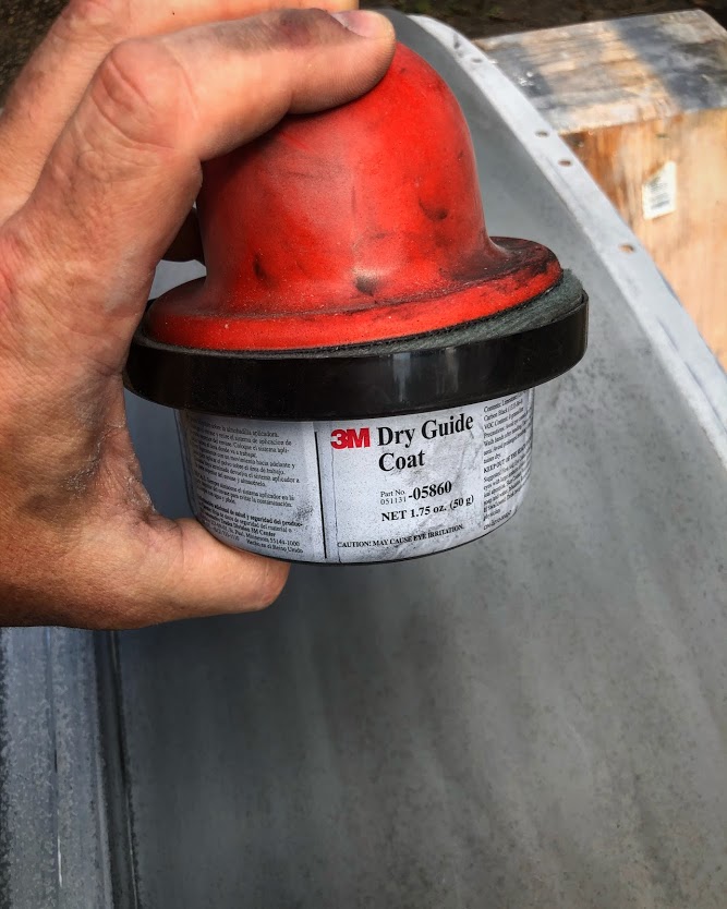

    In the spirit of trying to make all things easier and go faster, my friend C***ie turned me on to a better way of putting down a guide coat. 3M Dry Guide Coat is a game-changer. This is probably old news to many, but I haven't done any REAL paint work in a very long time, and amateur at that. This stuff is awesome, inexpensive, and much better than the "Krylon method" I had been using. This stuff really keeps you honest and shows you everything you've missed.
    But this isn't the fun part, right??! PAINT is the fun part!!!!! :D:D Let's get on to that!!

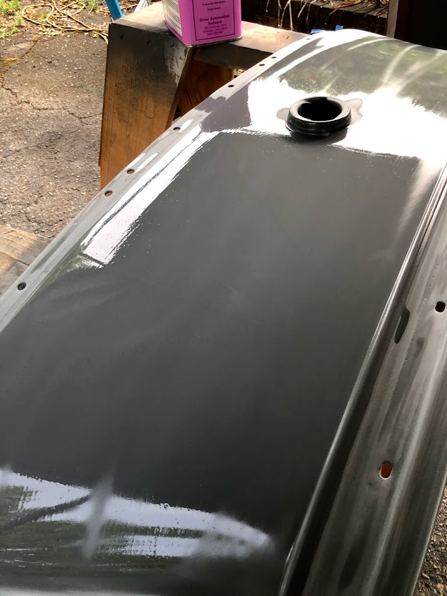

    It felt so nice to be mixing up some 1936 Ford Washington Blue to put down on this panel. Been a long time, old friend! I love this dang color!!
    And because of Covid-19, everyone is out of stock of respirator filters around here. I had to go to my back up supplied-air respirator system. I forgot how nice this thing is for the lungs!! But dragging around the hose is a pain in the ****.
    61799404406__303DB5D1-105B-4F73-9D91-4D117417BF65.JPG 61799444524__3AD61015-AB39-4F62-B291-C57971284C6A.JPG
    One light tack coat and 3 heavy coats and we have color on a panel!
    Sitting out in the hot sun, this color shows it's green undertones. I've always been impressed with how many different personalities this color takes on with different lighting situations.
    But, my work is FAAAARRRR from done with this panel. Because I'm shooting outside, there is always airborne dust and garbage that lands in the paint. So there will be some color sanding and polishing to do, for sure. Knowing that, I put the color on pretty heavy, and as a result I ended up with a small run to cut down as well. Yay. That will be fun. But... I'll take that over sheet metal sitting around rusting any day!

    .. little trick on that run .. skim a bit of filler down each side of it. Makes the sanding of the run more uniform. When the filler disappears, the run is gone.
    ( I'd discovered that trick .. after years of razor blades failing my run removals. )
    Of course .. by then, you may be ready to scuff & paint another coat. :) So don't mind me .. I'll be in the corner if you need me.

    Thanks man!! That's a great tip! I was going to use my little razor blade run nibler, but I like the sound of this trick! I will try it.
    Hopefully I don't totally kill this panel color sanding it. Time will tell. I'm going to let this panel sit for a bit anyway, and come back to it before painting the rest of the body. That way if I need to re-shoot it, I can do it with the same pot as the rest of the body. I hated to waste so much material doing one panel, but needed the practice.
    I'm FAR from being a good painter, so all input, tips and tricks are always welcome. Thanks!!!
