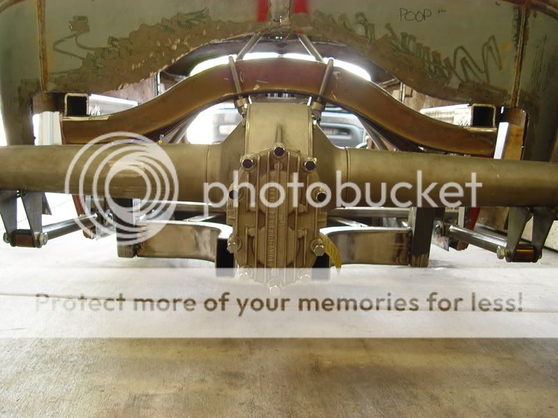

    Okay man... here's the best I have without a wide angle. Car sorta looks weird and empty up front without the engine sitting in there and the grille shell mocked up.
    You can really see how much lower the back is after flipping the eyes on that spring in this picture. Frame modifications coming up in the next jam session.

    Yep! It's going to be *** cheek to *** cheek in there! LOL! :eek: The nice thing is this body is a little wider at the doors than a coupe. Not by much, but maybe a couple inches. I'll take what I can get. This picture should give you an idea of how much height we're talkin...
    It BETTER be down here by then! LOL! Come check it out. No problem!
    Thanks ynotta!! I'll keep them comin... WISH I could work on it this weekend. :( Too much going on and too many a-hole drivers on the road from here to Vegas over the holiday weekend. It will be nasty traffic! I'm SUPER anxious to get more done! Probably go up next weekend.
    I need to get the spring together right, get the kickup adjusted accordingly (cut and reweld the miter cut on the Z-d portion), address front ride height get 700 pounds worth of stuff to figure out what's going to happen when I drop the Hemi in. If I can get the ride height situatated I can make engine and ****** mounts! Then all that will be left is getting that body mounted and subfloor together...

    I planned my ride height around my scrub line for starters. I figured if I blew a tire I would still be good at 5 inches or better without hitting frame. The frame is my lowest point. NOTHING will hang down lower than the frame rails. Not supposed to think practical things like this when building hot rods, but since I was starting from scratch, I figured I might as well be smart about it.
    Setting up the springs was the biggest mystery to me since there is very little info out there regarding how much these particular leaf springs compress other than what people say off of their own experiences. Posies helped a little when selecting a spring, but there was still some play in the numbers. WISH there was something that was dead on that a person could follow, but haven't found anything to date that surrounds our applications to the tee... Anyway, keeping in mind that your shackles need to be at 45-degrees with the full weight on the car is a good place to start. You can work backwards from there. Sketch things out on paper and know the dimensions of your springs MOUNTED that you plan to use and try to get an idea of how much they will flatten out. The actual "guide" numbers are talked about in a few threads. I think they were something like, plan for and 1-1/2" of settle, plus the drop from the shackles moving out to 45-degrees (approx 1.06-inches). From there figure out the height of the crossmember, kick-up, etc.. This is my nutshell explanation. Have heard it explained better... LOL! :eek:
    Speaking of ride height... had a thought on the front ride height. It's sitting around 4-1/2 or something up front right now. If I get the HD non-reversed main leaf from Posies for that front spring, it would raise it up an 1-1/2 or so and I wouldn't have to do anything to the front crossmember and/or perches. Here we go again... playin' around with spring eyes again! LOL! Probably solves the problem though. I can't go higher with the perch mounts because the spring main leaf will have to be shorter to make it happen. I'm at least going to inquire with Posies about it. I really want to run this cross member if I can. I'm pretty fond of it.
