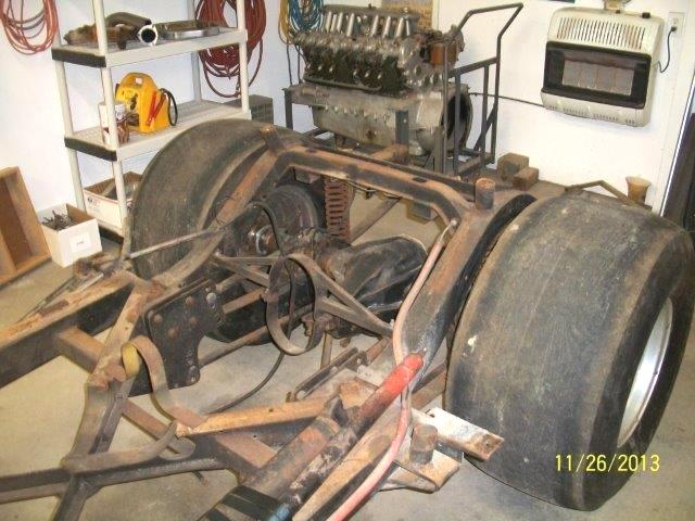

    Sorry, but another question........ How much was the rear of the frame narrowed?
    And.... how narrow is that rear end? Looks like the slicks fit under the stock outer
    fenders, so it must be a lot?

    Off the top of my head (dangerous), one of the rules for MP was that the slick could not stick out past the body line. So there is your start to tucked tires, narrowed frame rails and rear ends.

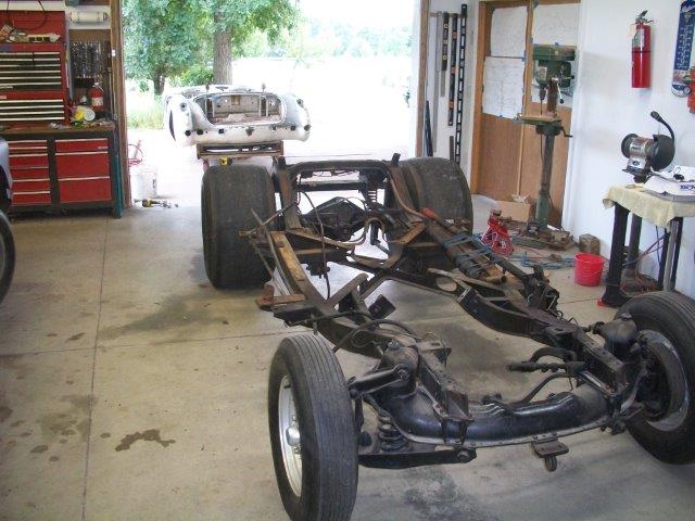

    Willy B hopefully I am not screwing this thread up with unnecessary minutia but, this car had a 6 point cage with nothing going forward of the firewall (although with the stock column I believe a forward set of bars would be safer -to say nothing of the potential of meeting today' tech at some tracks). The four bars in the interior of the car placed the bars out as far as possible and the mounts were fabricated and welded to the frame. Technically there were no birdcages until 63 in Vettes but there was some metal structure under the dash to help locate the doorjambs to the dash and firewall (some aluminum and some steel). If you notice the forward bar you reference it would go pretty deep into the pocket just forward of the door jamb which is wide as you can go and stay within the shell of the body.
    You can see in the attached picture how he made the mounts that are welded to the frame and also see where he moved the frame when he narrowed it. If you measure a stock frame outside to outside of the frame in the rear area behind the axle let's say it is right around 44"-this car is now 33 3/16". A stock differential housing is right around 55" outside of housing flange to outside of housing flange. This rear ***embly is different from stock or an Olds/Pontiac and it had disc brakes on the rear and so the corresponding measurement is a bit different. The measurement of this rear setup is 48" from the outside of the axle flange to outside of axle flange. So to try and correspond the stock setup you would have to add the axles to the stock setup which would add about 3" overall so it would be 58" (axle flange to axle flange) compared to let's say to 48".
    The tires are 14.5 X 32 X 15 and they did fit within the bodywork. Vette -12-13 008.jpg

    Thank you for that picture and explanation! That picture and the other one
    of the frame are what I was looking for!

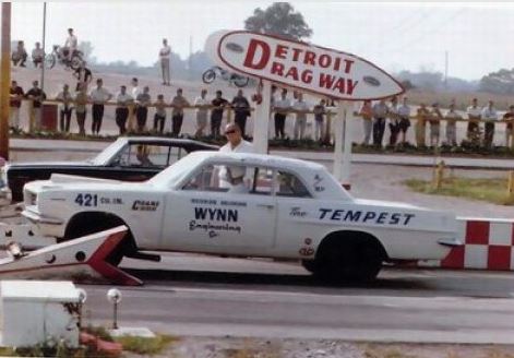

    A/MP Tempest
    EDIT: from GearheadsQCE
    George Delorean brother to John

    George Delorean brother to John. A LOT of back door 'arrangements'.

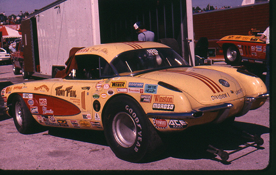

    Tony Feil’s C-1 E/Modified Production Corvette is prepped for another round at Englishtown, New Jersey.

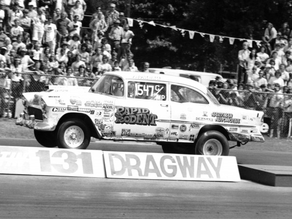

    Fred Hartman’s G/Modified Production ’55 Chevy ran a 287 CID small-block Chev with a Tunnel-Ram 2×4 intake, ported heads and a five-speed manual box. 13 lbs. per CID G/MP cl*** rules required a hefty 3731 lb. car weight.

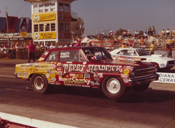

    Cotton Perry capably drove and Jim Hedrick built the inline six-cylinder Chevy engines for the Perry & Hedrick “Pocket Rocket” H/Modified Production Chevy II Nova. Over the 70’s decade this team nearly always won H/MP cl*** and a score of Modified Eliminator events. The late Jim Hedrick’s Race Engine Design engine shop, in Rossville, Georgia, specialized in big-inch dirt track modified engines, but his six-banger power ruled Southeastern drag racing. (Jim Hill photo)
