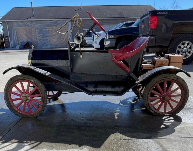

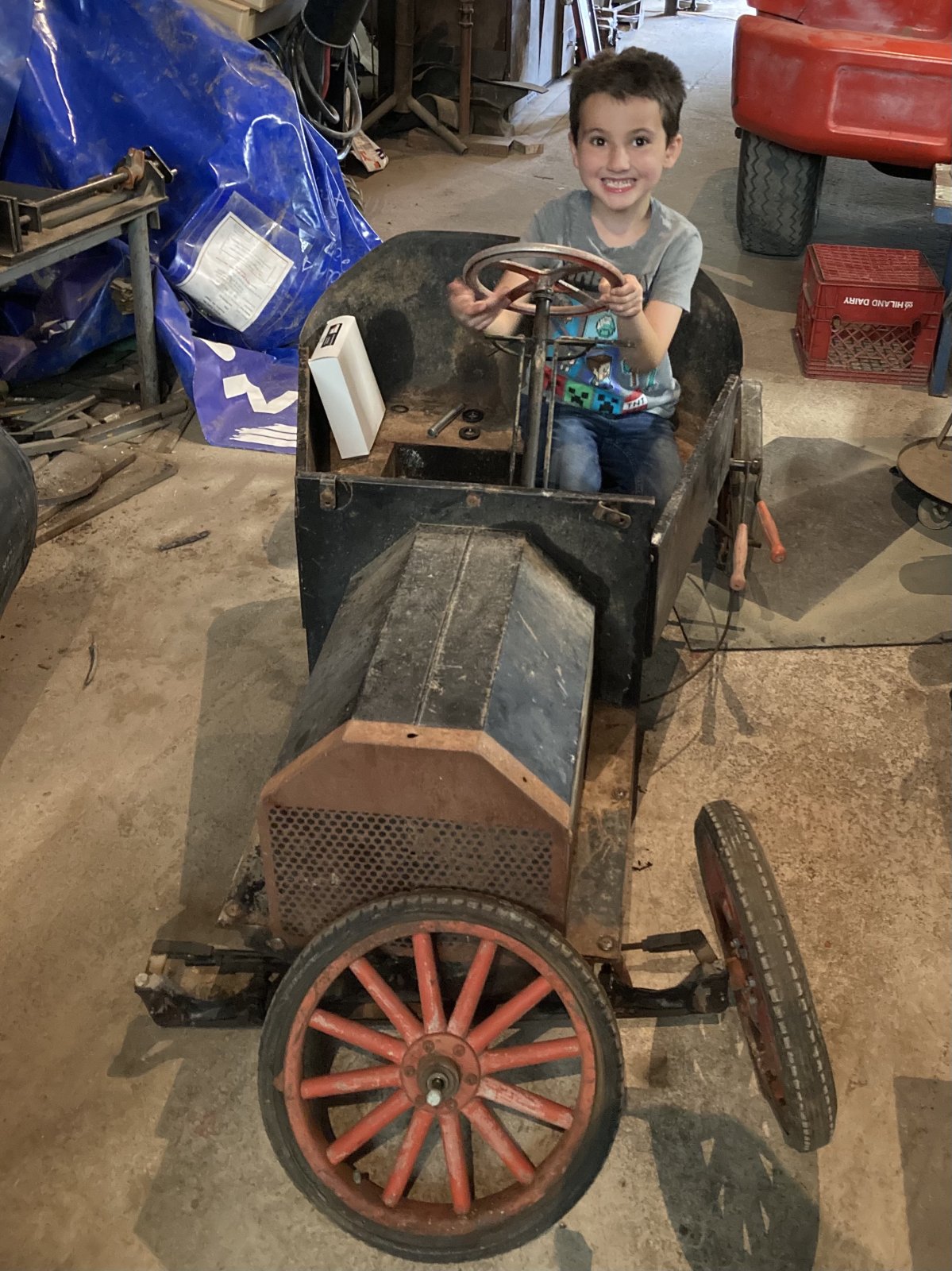

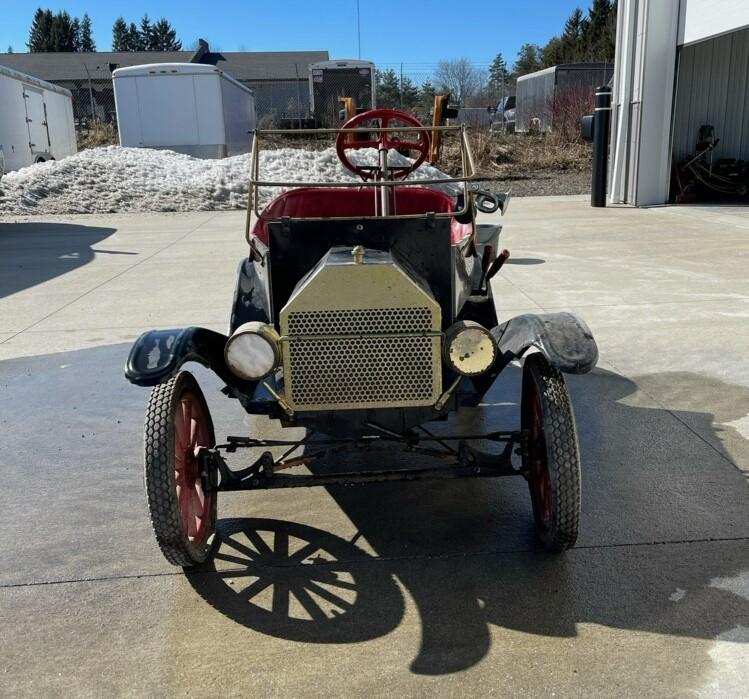

    A Friend of mine found this Tin Lizzie under a car port . I bought it off him . Two of the wooden spoked wheels were rotted . I found some mini bike wheels and tires on Amazon. The fibergl*** fenders were broken up . A friend of mine works in a machine shop and made the rear hubs . Then he drilled the bolt pattern in the hubs and rear wheels. I felt that it sat too high so I built another frame to set it lower . IMG_0335.jpeg 69154328047__8561C381-574B-4FFC-B0CF-F281D64D4038.jpeg IMG_4455.jpeg

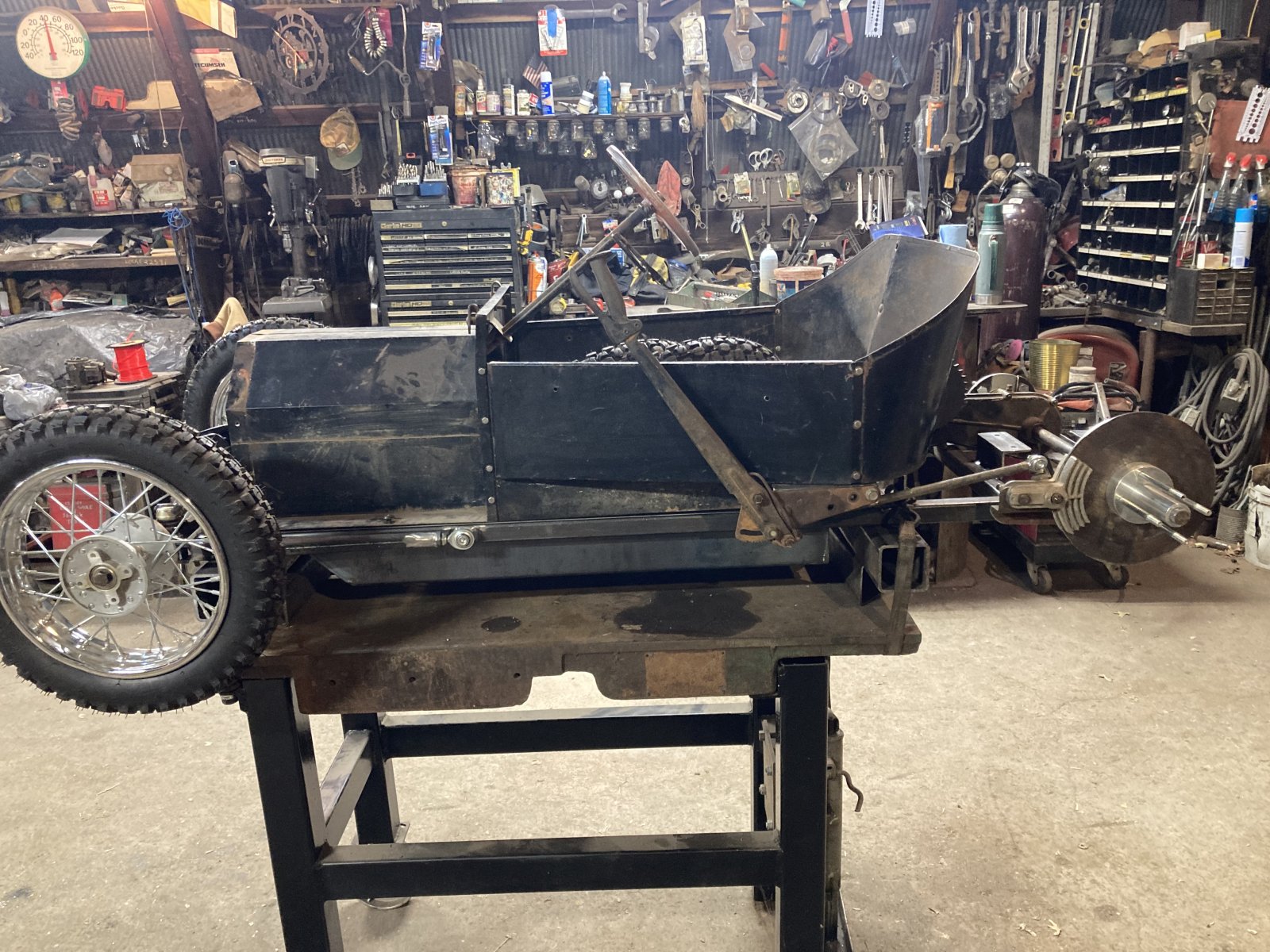

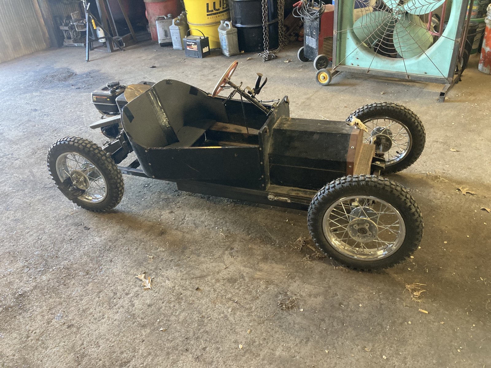

    IMG_8841.jpeg The front radius arms are parking brake levers from early 60’s C60 Chevy truck . The brake lever is a parking brake lever out of an early 70’s F 600 Ford truck. The brake is off a Harley golf cart . The cow skull is from Hobby Lobby . I was able to get the original Briggs engine running but never could get it to run properly. So I got an engine from HF . The rack and pinion came off eBay . IMG_8843.jpeg IMG_8842.jpeg

    The heat off the muffler made the seat back hot . So I’m building a exhaust pipe away from the seat back
