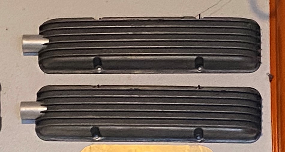

    I've had these valve covers for a number of years and never knew why someone would install a tube where they did. I've searched here and via Google but haven't found a good answer that tells me why this might have been done.

    Looks like circle track or road race.

    Many if not most (at least at one time), put the breather tubes in their rocker covers in the front as you have them. This way they would normally connect both sides and install two breathers in the "U" shaped piece that connected the rocker covers.
    This allows low hood heights...yes the carburetor is above the hood !

    It was a modification used on plenty of high winding drag cars too, the catch can helped contain the oil.

    As racing deal. Had sets that had AN fittings were attached .

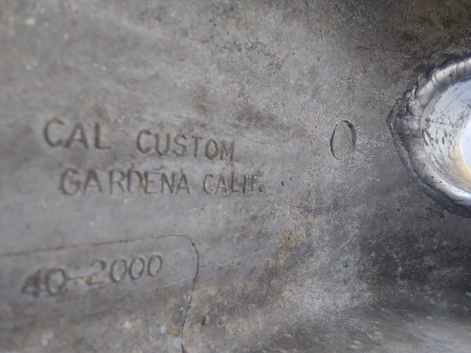

    Thanks for the info, I took them off the wall, (they've been garage art for the past decade or so,) and noticed they're Cal-Custom's made in Gardena California. They're polishing up nice too.

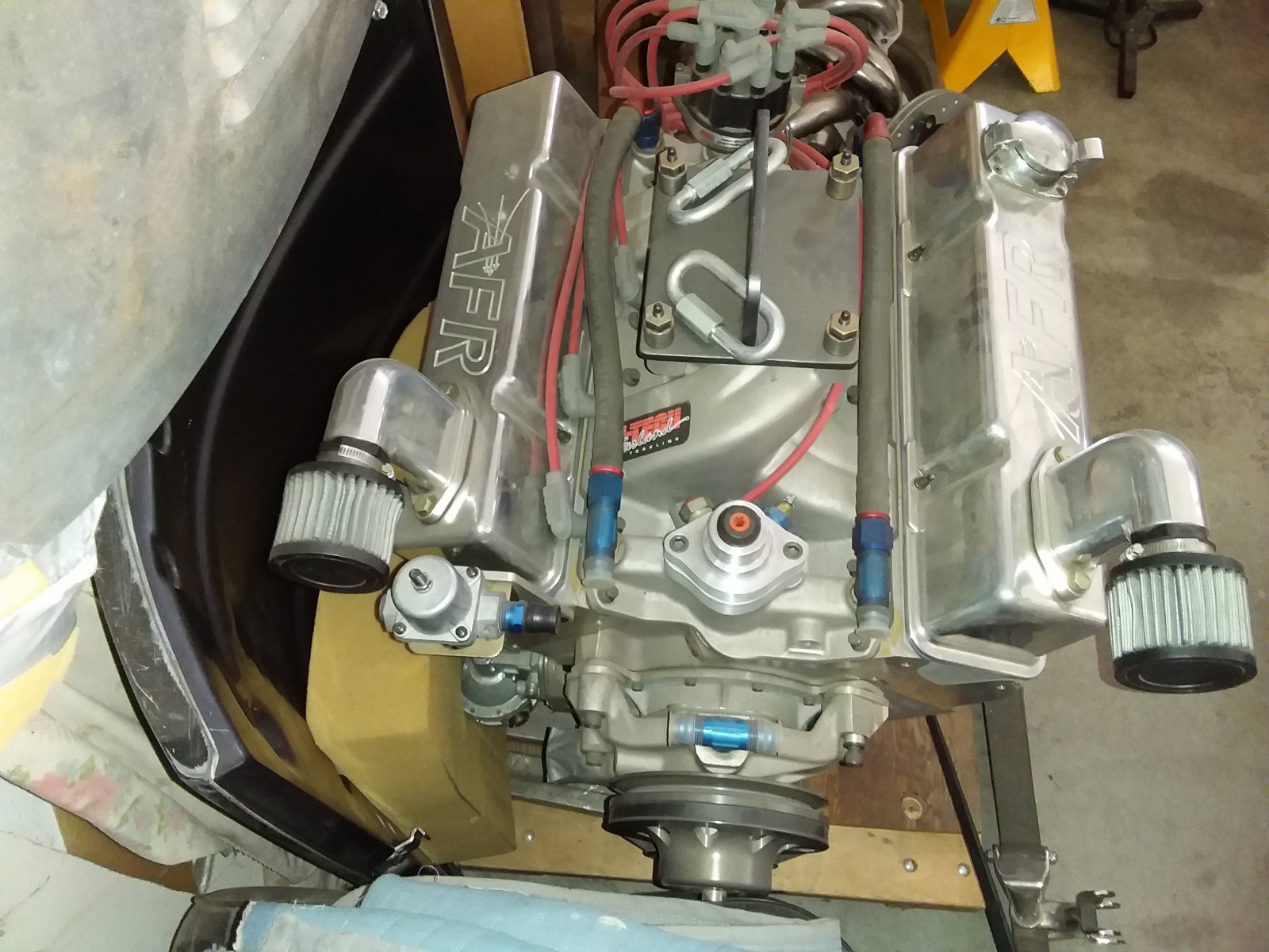

    I made some -16 AN adapters to connect K&N breathers to Dan Olson burn down towers.
