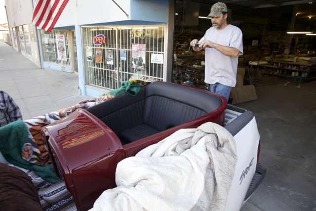

    The body is from Poli-Form in Ca. It is stretched 3.5 in in the doors and is very roomy and I am 6'1. I should have a ton of pics coming in the next 5 or so days. I just got all the components back from powder and chrome and we will be putting it back into a roller on Saturday. We got the stance by pie-cutting the frame 3in right in front of the firewall. It is subtle and I think a lot cleaner then a Z'd front end.

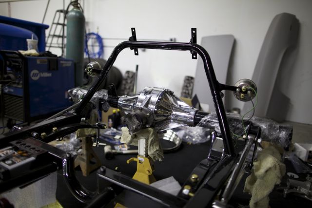

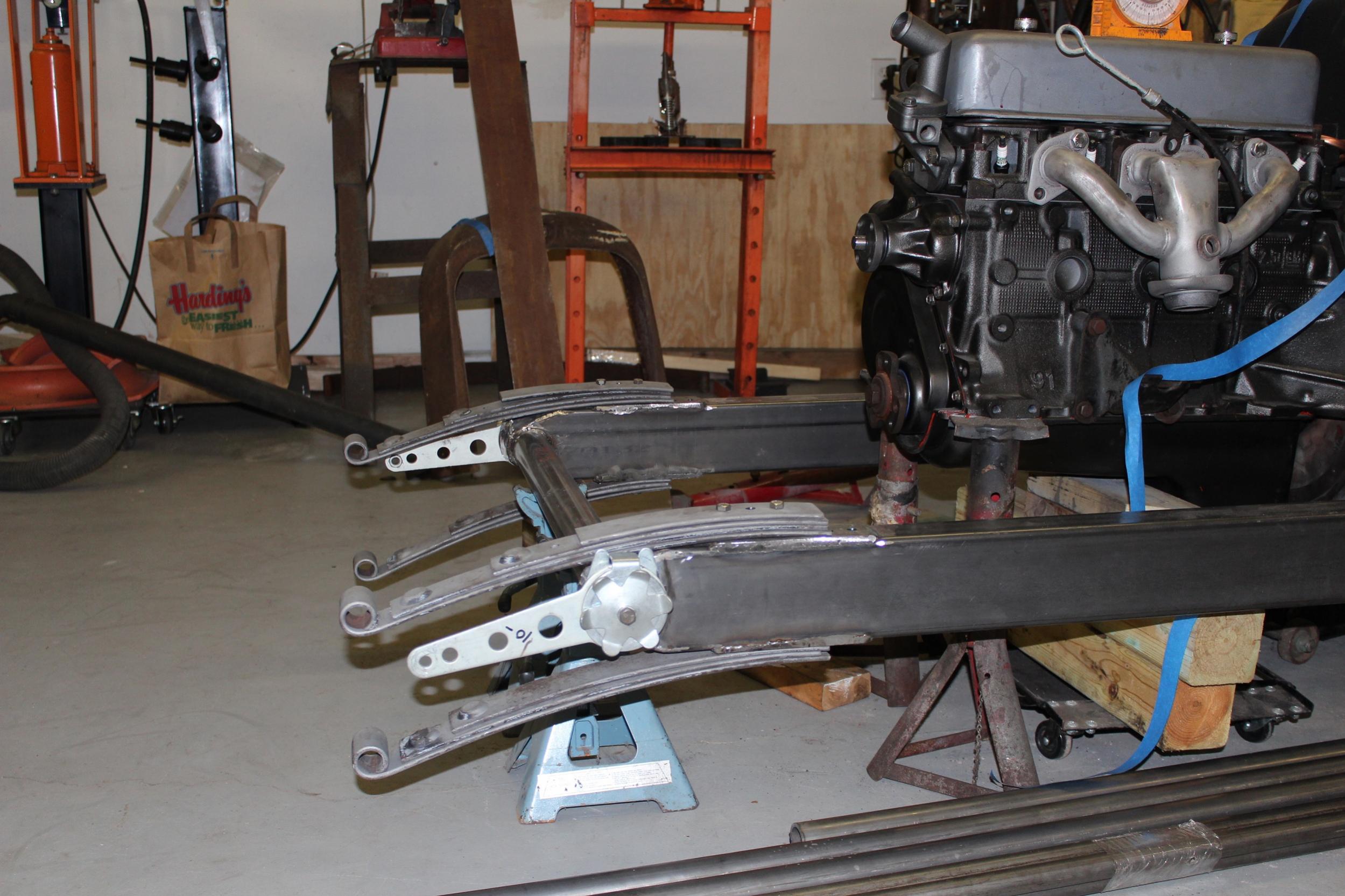

    Hopefully this helps with your 1/4 elliptical mounts question.

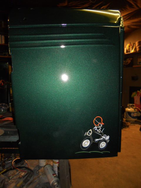

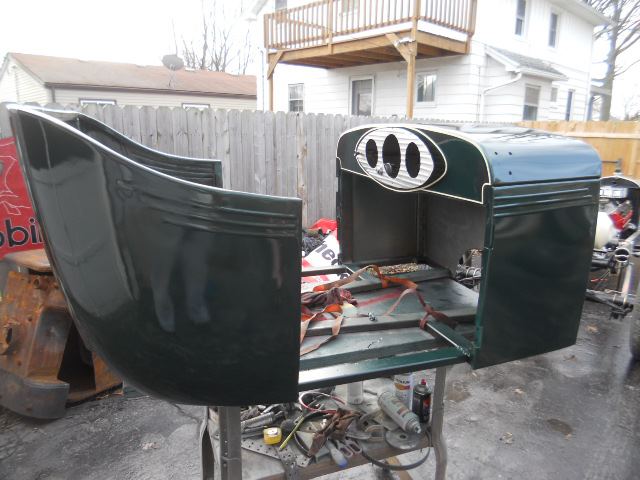

    January 23rd, 2012 I bought an engine, frame and cowl and didn't know a thing about any of it. It's been a long year!
    My turd, slowly getting polished. But it's almost a roller now. I figure I can finally post it.

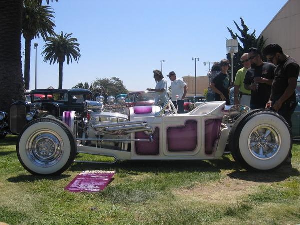

    I later owned the car and did nothing but throw some interior in it, paint up the pipes and drive it. Gl*** and pinto powered i know not HAMB friendly but easily the most fun car i've ever owned. Probably as close as you'll get to riding a bobber/chop style bike which is something i've done for years. Just 4 wheels instead of 2. So regret selling it. I had thought about posting it but wasn't sure if it fitted the criteria as not strictly what i'd called a modified, no so competion in looks . Each to their own anyhow and as it's already been shown here's a better picture. Man i miss that car, more than any car i've owned. Turned you into a nutcase behind the wheel. It had to be thrashed everywhere and it loved it. How i kept a license i don't know. I like it when a car has the ability to do that a person. 2 minutes after that picture was taken i was doing donuts in the field behind whilst giving a driving lesson to my best mates son. I'm 46 for christ sake and know better!! Thats the effect that car had on you. Brilliant:D Happy days for sure.

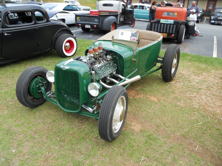

    My favorite!

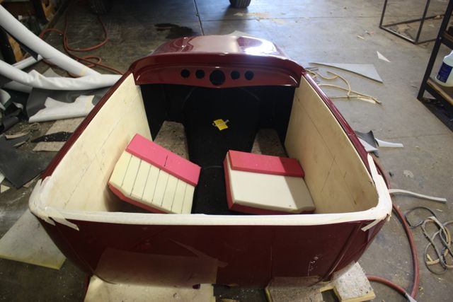

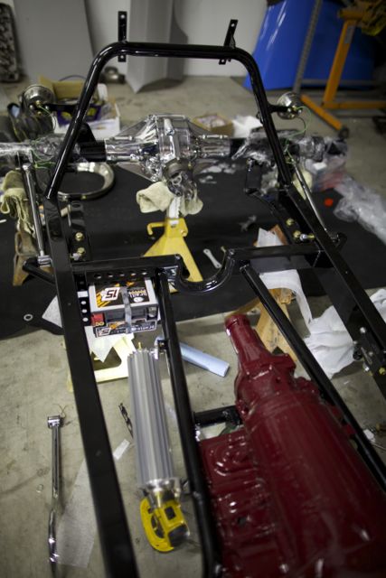

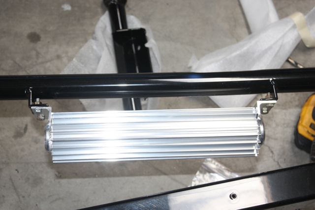

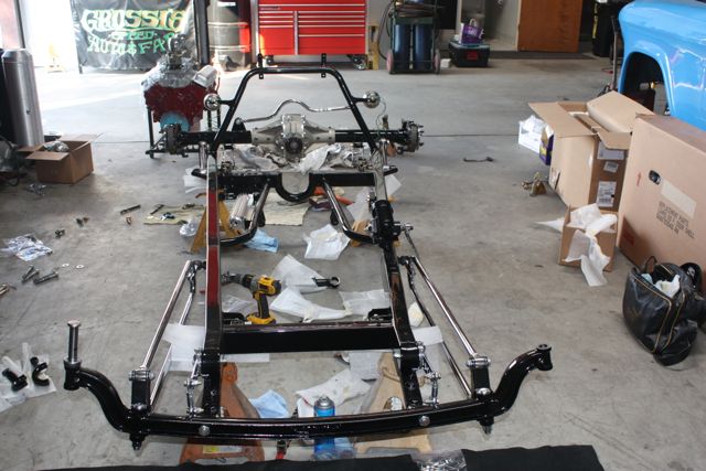

    Here are some updated pics like you requested. GNRS is right around the corner and we are pushing to make it happen!

    Thanks a lot for taking the time to take and post the pics. I can appreciate how precious the time is as you are thrashing to make the event.

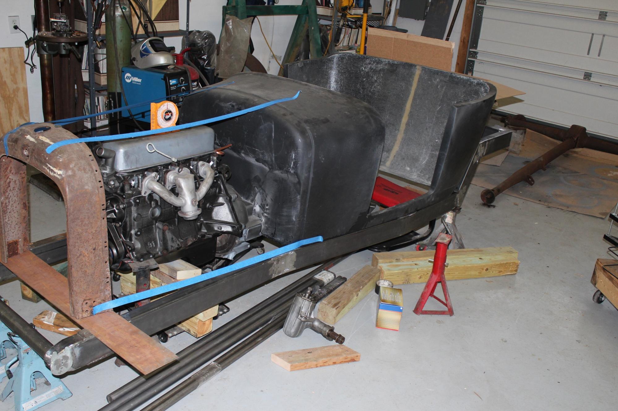

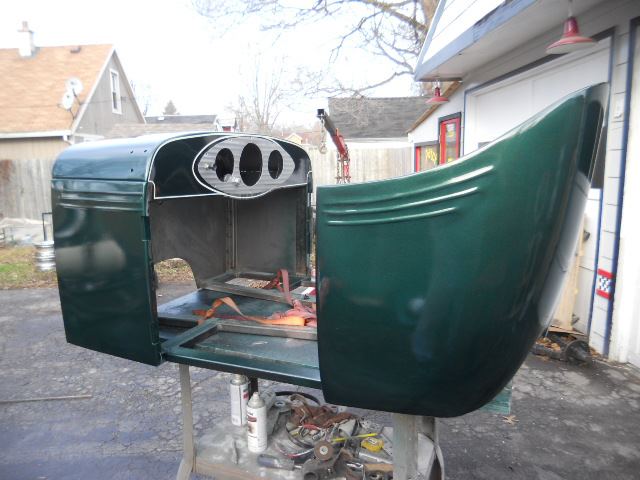

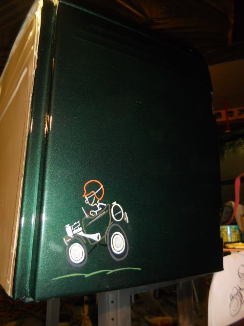

    Wow what a great thread, heres a few of mine, still in progress.

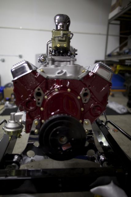

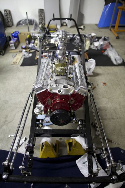

    Updated pics of the GNRS bound modified

    In that last picture of the engine in the frame, I can finally make out the pie cut in the frame you described before. Very subtle. Thanks again for the pics.
