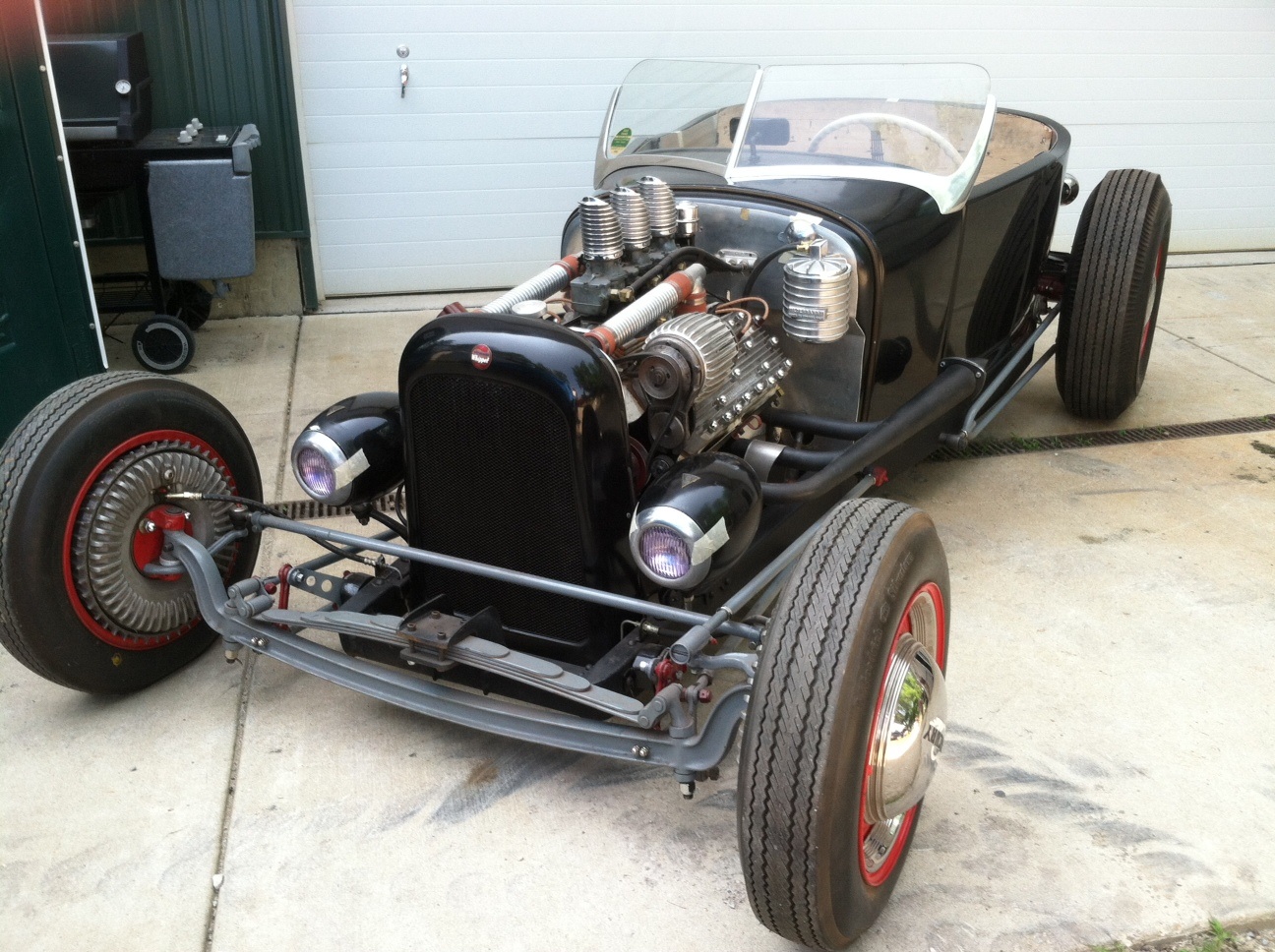

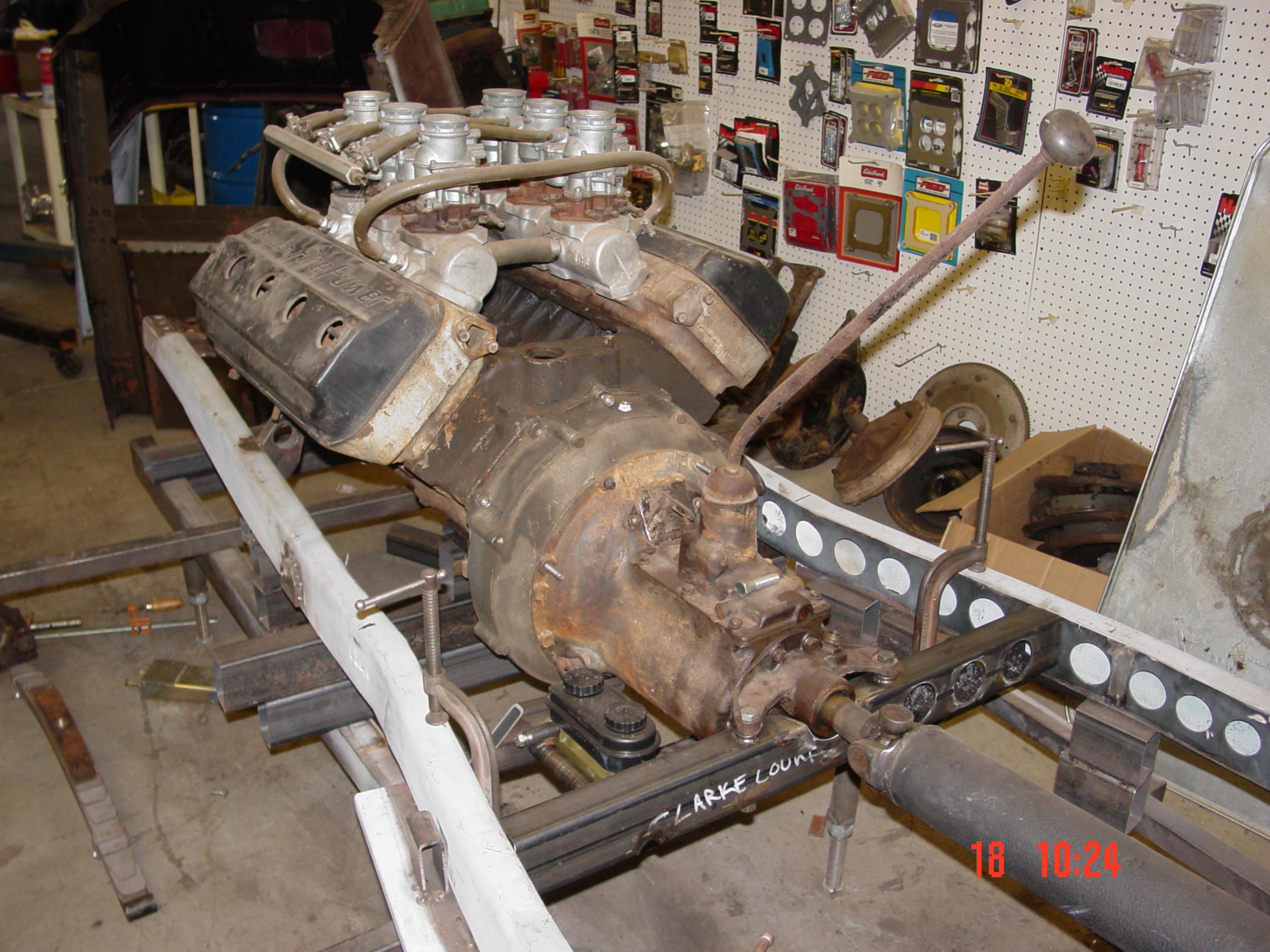

    Mine, about three weeks into the build.... Ch***is is done, pedals in steering and suspensions completed. 324 Olds with #10 heads and J-2 intake converted to run Holley 94s'. '39 toploader and '40 rear with seriously shortened torque tube. Stock a springs with Pete & Jakes reversed bottom leaves, 6 up front, 5 in the rear. Chopped '32 radiator. Plans for a '29 shell, hood sides only, and not much else.
    Tried with Kesses wheels, good size but not the look I'm after....

    need louvers ?
    Awesome Koz! Just my opinion, it looks loads better with the black stelies and no whites....

    Oh yeah...thats right on the money Koz!
    Agree that the WW's are a bit much for it but damn it has the profile with those size tires.

    I agree on the tires. I'm thinking 16" wheels with 5.60-16 up front on 4" wheels and 7.50-16 in the rear on 4 1/2" '46-'48 wheels. I already have 15" wheels and I was wondering if the wheels on Bob Knaaks' roadster were 15" or 16"? It's hard to tell from the pics. The wheels in the pics of mine are 15". If Ok I would use 5.60 and 8.20 Firestones. I also need to source a smaller steering wheel.

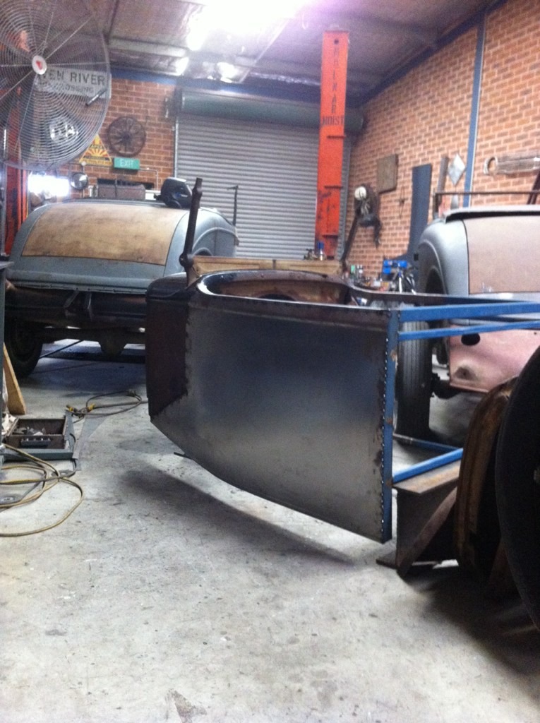

    rolled mine out for the first time last weekend. I'm not so sure about the proportions of it. Its going to get channeled over the frame and slid forward to cover the front z, but before i get there I'd like to get it looking right. Something just looks odd about it and I can't put my finger on it-is the back end too long? I guess this is just another downside of building a ch***is in a one car garage. My wheelbase as it sits is 110"--too long?. I have the spring mounted on speedway brackets in front of the rear axle. I'm thinking maybe put the spring right on top to scoot the back end up towards the body. Its a fairly rough mockup with the rear end tacked in, so nothing is permanent yet. Luckily I haven't cut my 36 radius rods yet. (and yes they will be triangulated to pivot next to the trans yoke.) It my first build and I'm sure it'll get pooped on, but I'm looking for opinions.
    So, whatcha think?

    I think your wheel base is too long. Try moving the rear wheels forward and and the front wheels back then take another picture. Mine is only 103" wheel base

    Mine is about 110" too, with a straight 6 and the axle out in front of the grill. I think it seems a little long but with a straight 6 it almost has to be a little longer. My car is wider than yours though.

    Twin City Knight, Ya, (recovering Minnesotan!) your wheel base is too long. I usually shoot for about 100" give or take an inch or three. Leave the body right where it is and move the rear wheels forward about 5", and set the rear suspension up to raise the back a good couple of inches to get it at least level or better yet raked the proper way. If it were me, I'd honestly cut a couple of inches out of the rear kick up to make it happen. That "too long, too low in the rear" stuff screams rat rod to most of us that have been around this stuff forever.
    Then, with what I see of the front end, redrill your holes for the spring perches forward as close to the forgings in the wishbones as you can, and you'll lose another 3", plus strengthen the front end quite a bit. The wishbones were never intended to take a sideways force such as a spring's movement, and the further back you go from the forging, the weaker and more flexible they become.

    I think Mike what is making yours look more proportionate is the fact that you car's body is a bit longer than the typical "T". You're literally filling more of that space between the engine and rear axle of that 110 inch wheels base.

    I appreciate the input. The rear end is way too low and way too long so i agree, that's not the look I was after. It was quite a bummer rolling it out and having that oh f*ck i looks like a rr moment. I'm in the process of bringing the rear end in about 8" between shortening the z and spring mounts. It'll have about 8" under the bottom of the rails for clearance once the rake gets sorted. I didn't want to build a rodent, so that's why I'm here on the hamb looking for help, thanks again

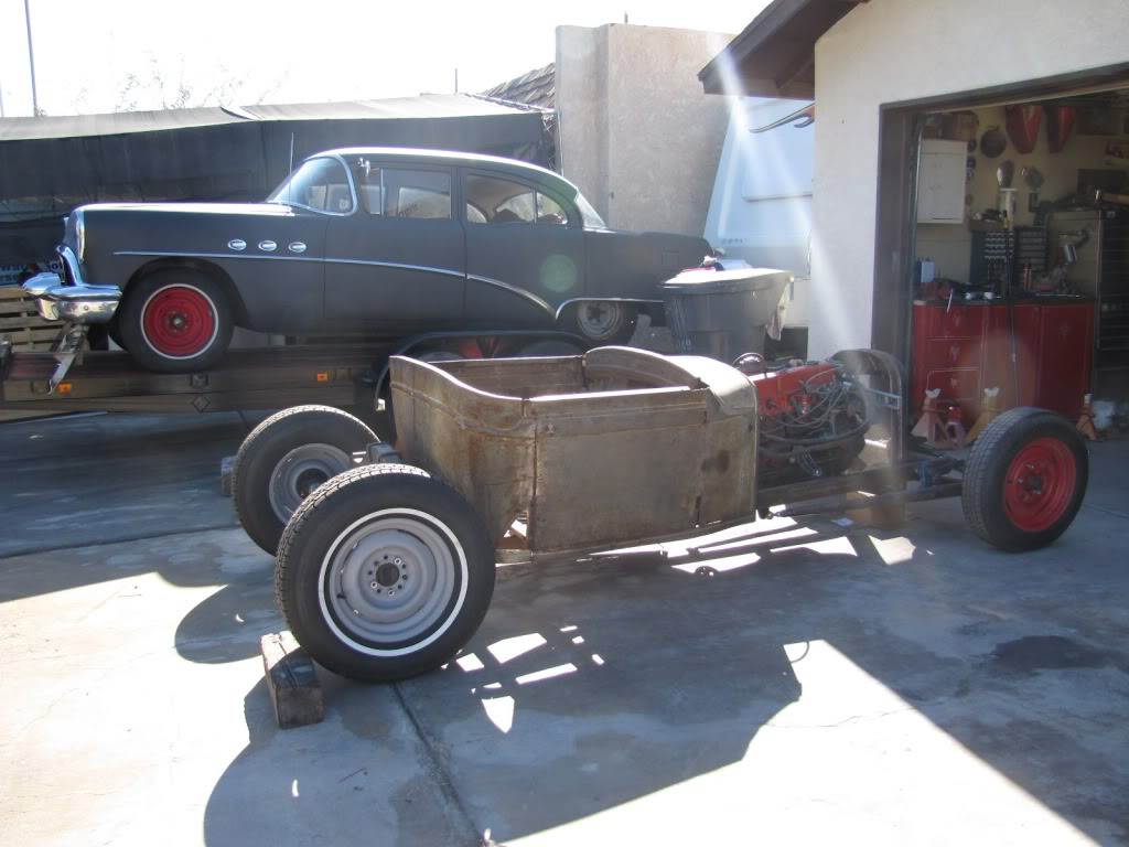

    Came up w this stuff today. May sell it or I may just build it.
