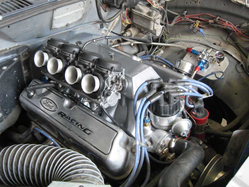

    I'd put in balancing tubes between the 4 intakes to even out the pulses, and help with the synchronizing.
    ( see pics )
    And for the fuel pressure, I wonder if you could make a float bowl that sits over the carbs ( out of a Holley 4BBL floatbowl, for example ) that gravity feeds into the bike carbs.
    For the linkage, I'd use a rotating shaft with adjustable pull rods ( with a left and right heim joint ) to each carb, similar to what they use on twin Weber Bug engines.
    Seems to me, if you do this right, the 'ol Buick could really benefit from this...

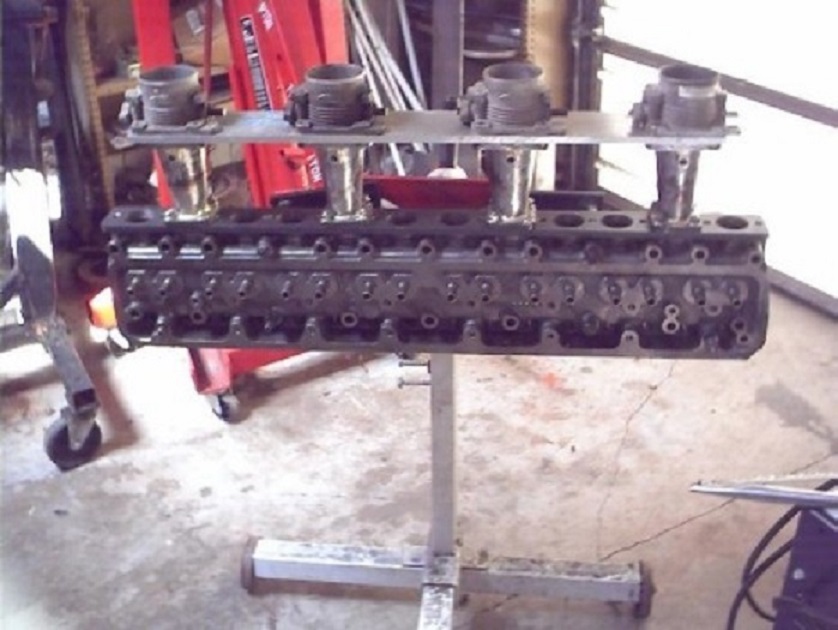

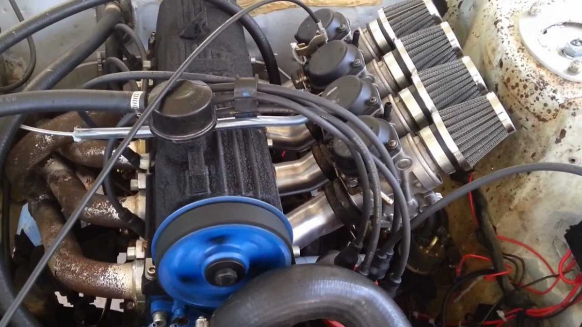

    My Plymouth with Suzuki TBs for linkage thoughts. And a intake I made for a Buick. Close up of master rod linkage as used on the Buick. 2287825-a451d682e9de82e9ad61b6b2ab3d209c.jpg TB Suzuki.JPG

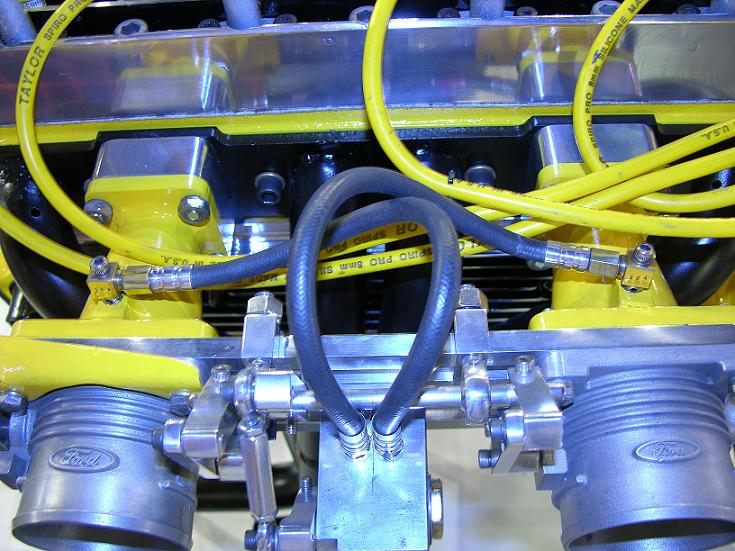

    linkage.jpg 001.JPG looks like the tank would be the same as recommended for use of Hilborn injection on the street.Pressurizing is not an issue. Here is yet another linkage i did using the same master rod and links deal. It's cheap. Easy to do and does not require everything be perfectly in line.
