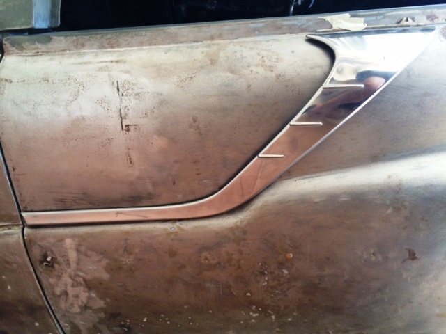

    First, the problem. This is the passenger side piece and you can see where it originally attached to the Pontiac at the top where there is a small flange with two holes in it to screw to the body. (One hole is covered up by the tape holding the piece in place.

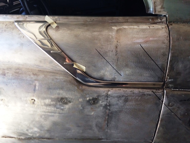

    Next, a side view of the passenger piece:
    Here you can see the huge gap on the front side between the door and the piece.

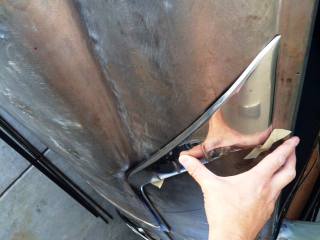

    Next, The Passenger side piece from the rear side: Another big gap. So, we have two choices here in my opinion: 1. Attempt to cut and shape the trim to fit the Mercury body OR 2. Do some fancy sheet metal work on the door to fill in the gaps and make nice transitions.

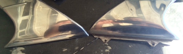

    I decided to take option 1 and go for it by cutting and trimming the piece so it fits flush correctly on the door. I accomplished this on the Driver side by:
    1. Cut off the mounting flange
    2. Using a flap wheel, begin to trim back the piece until I got it to fit flush in order to also use the Beltline Trim I have for the car too.
    3. It took about 30 minutes to trim it back slowly so as to make it fit how I like it. I have made it close so when the bodywork starts it will fit flush like it was made for this car-Like the Red one in the first post.
    Next are pictures of the fit on the Driver Side:
    If you look carefully, you can see that the flange at the top of the piece is gone and I have removed small amounts of material so the piece fits cleanly up against the door.

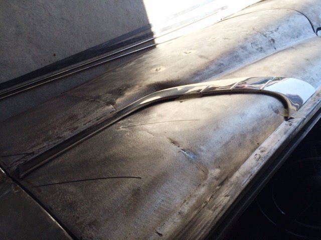

    Next, another view of the Driver Side trim-This is the back side of the piece.
    Next, The Front Side of the piece-Notice how close I got it to the door shape. now, that is more like it! I just need to either make or find the proper mounting clips for the back side of the trim to be able to mount it to the door securely. These clips should be available online once I figure out the proper size etc.
