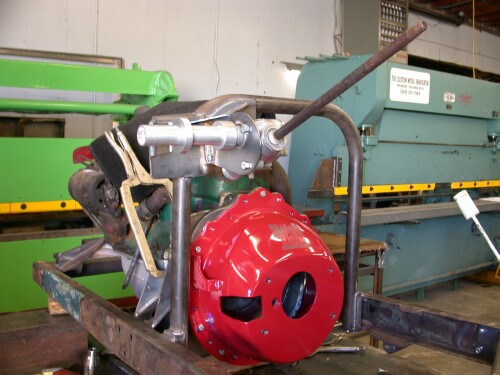

  8. Found another one that a HAMBer (??) did with a Lakewood shield and flat adapter plate, it looks like.

    That link goes to some place I don't think is correct. It's some kind of stupid search site. Def not a parts retailer. I liek that bell housing though.
