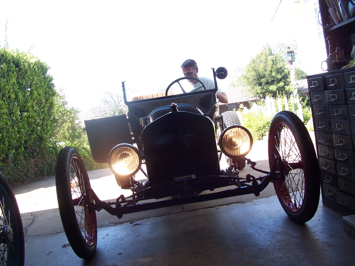

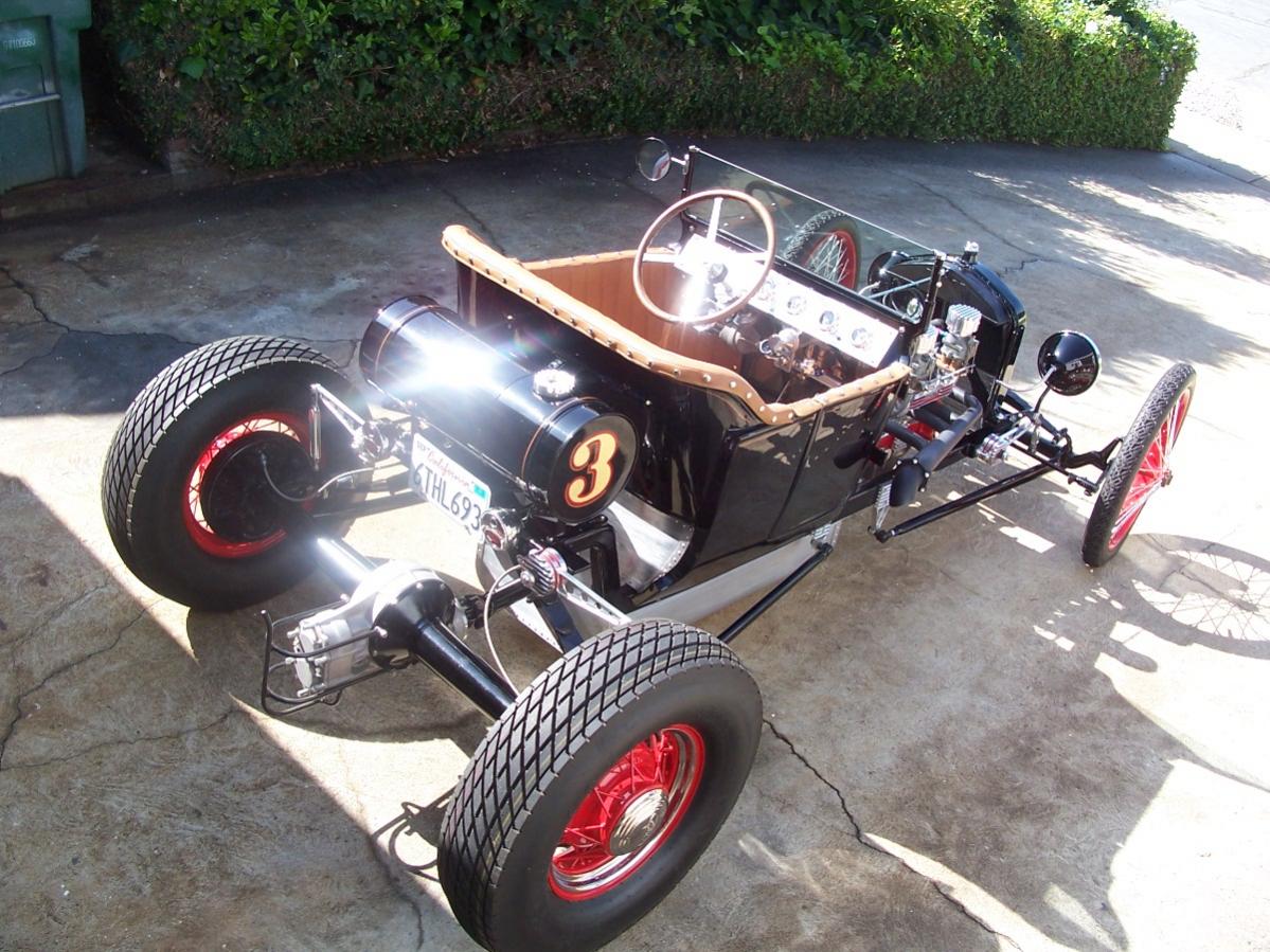

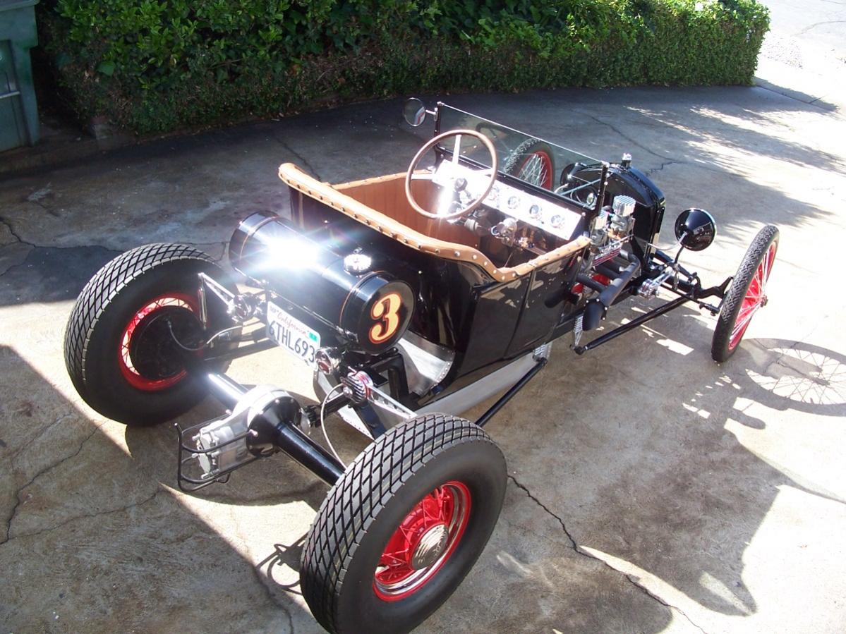

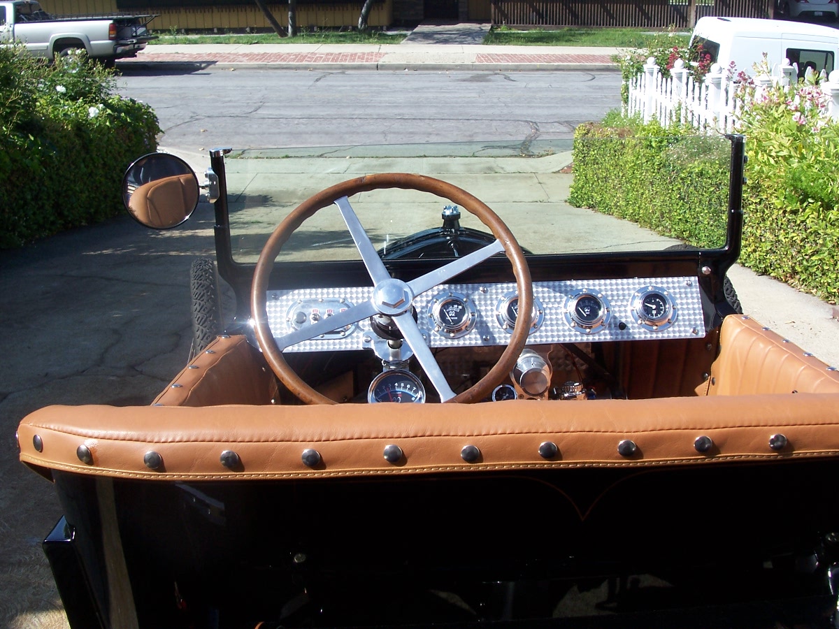

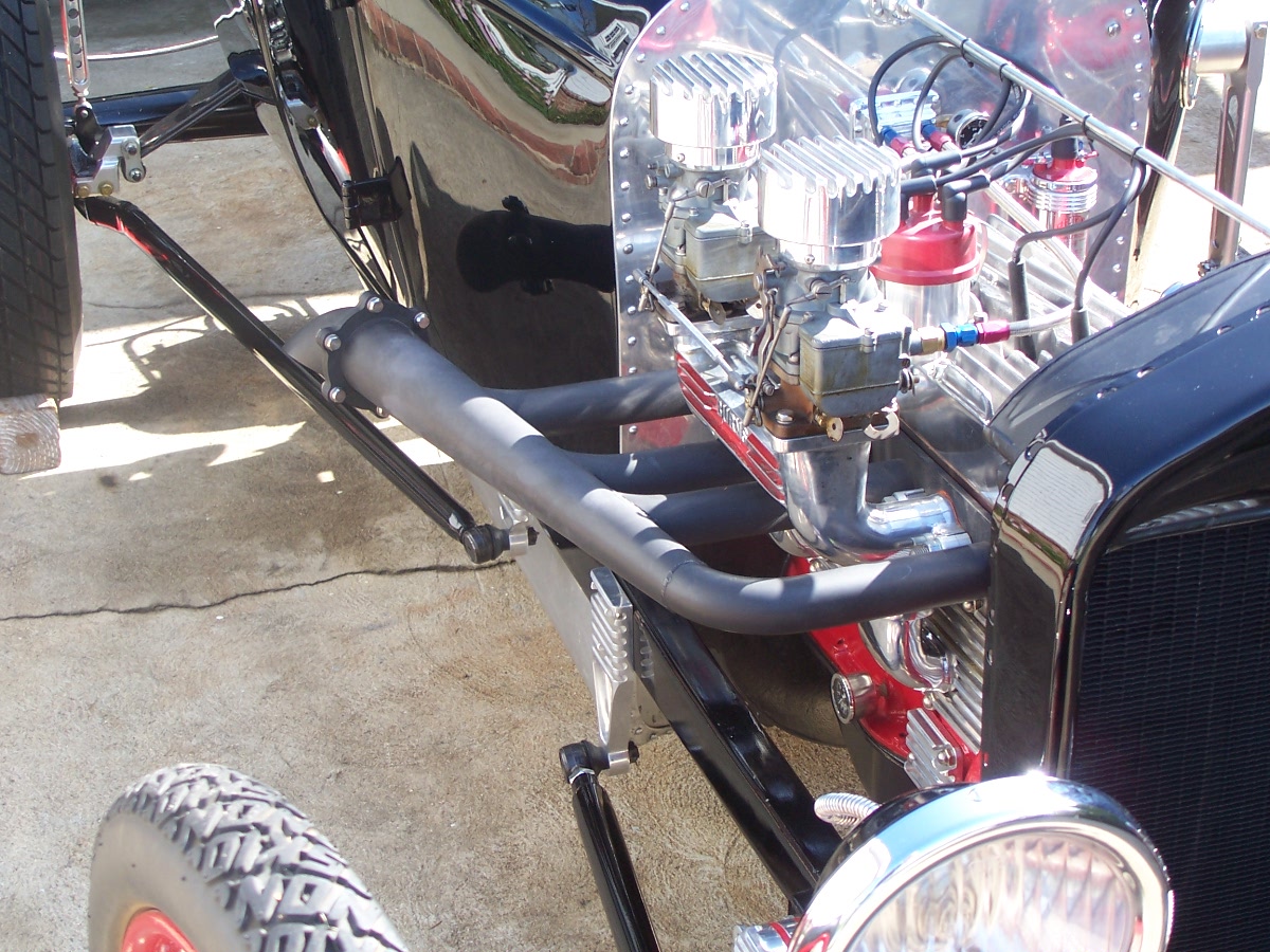

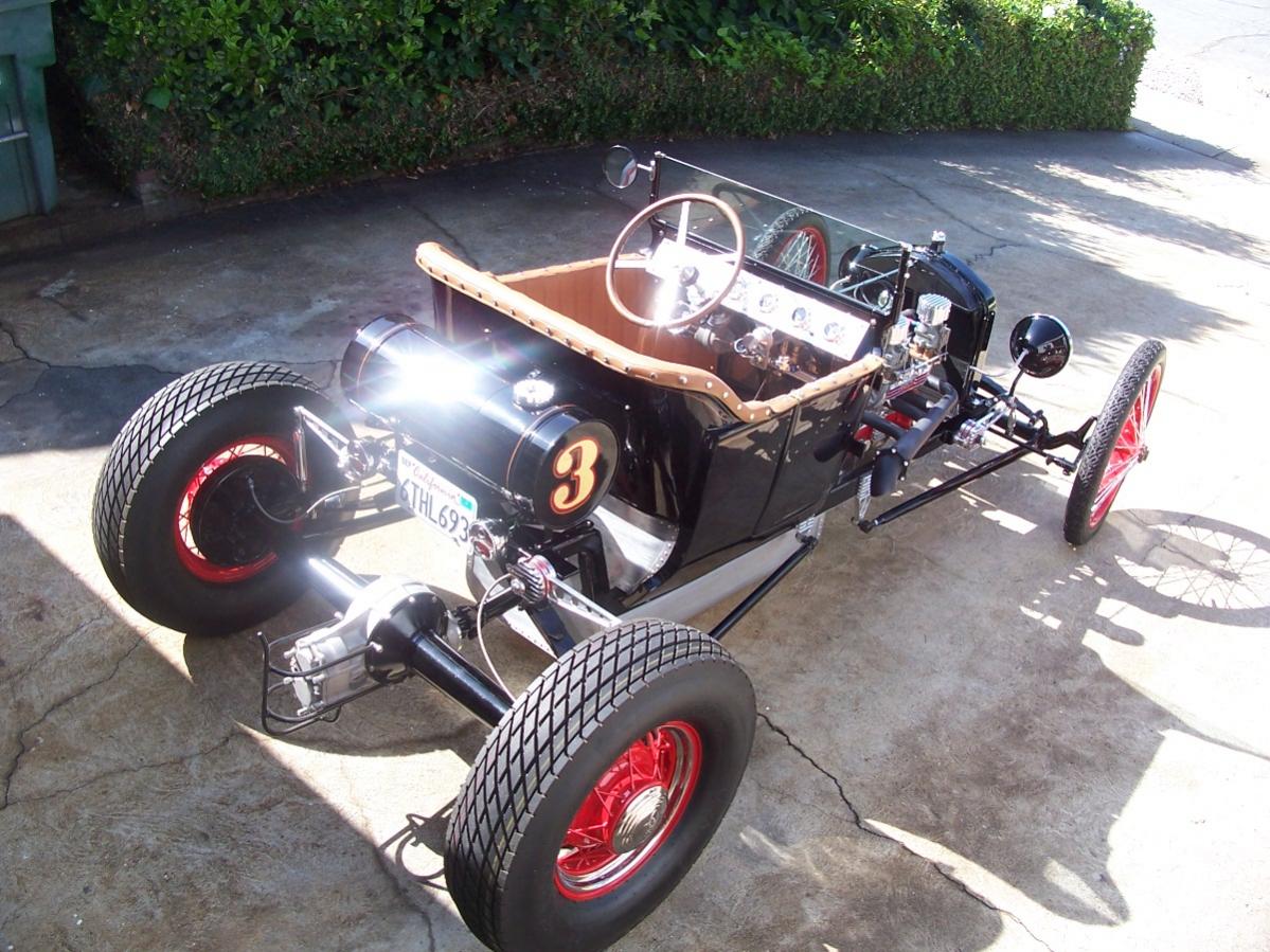

    Guys, Believe it or not . . . This is the final set of photos for the building of Moe's Modified ! Yup, she running and driving and just one mean little Hot Rod. So, without further adieu here is the finish of Moe's Modified !
    Dave :eek:

    Heck yeah! That looks great! I'd drive that for sure.

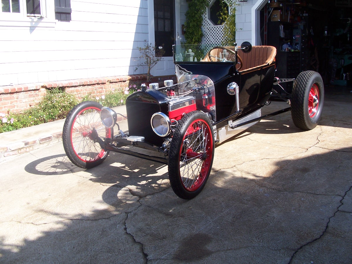

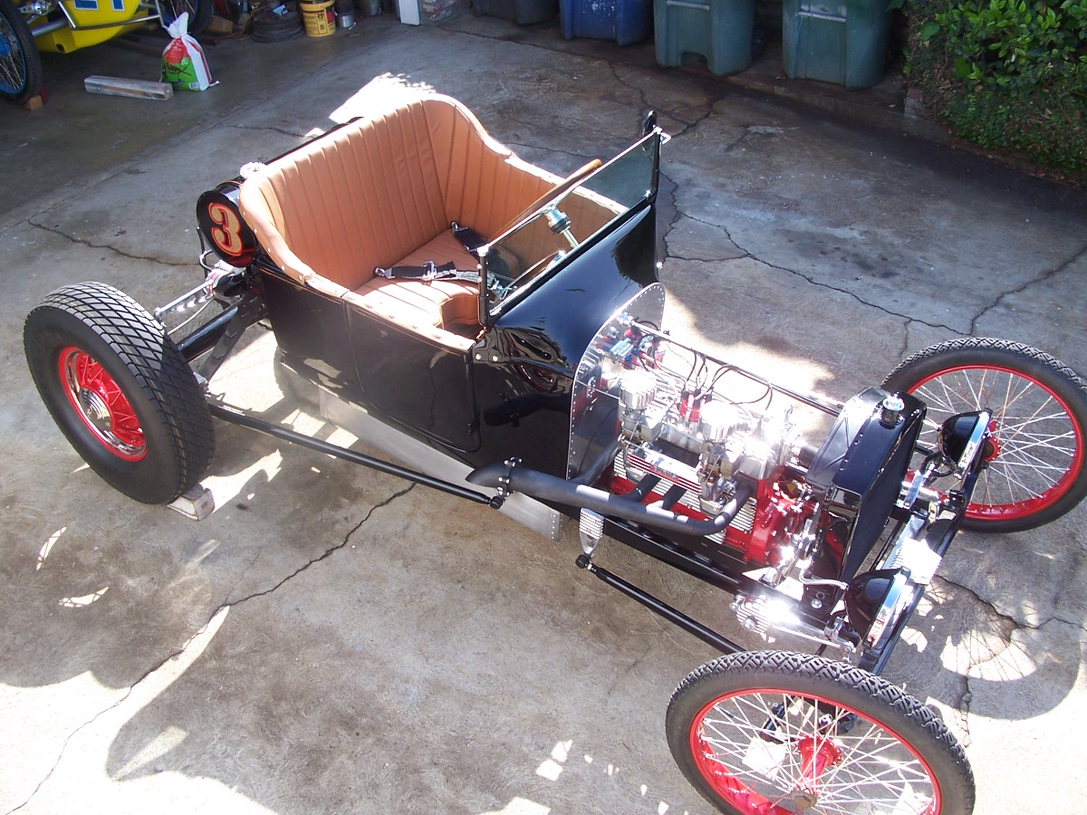

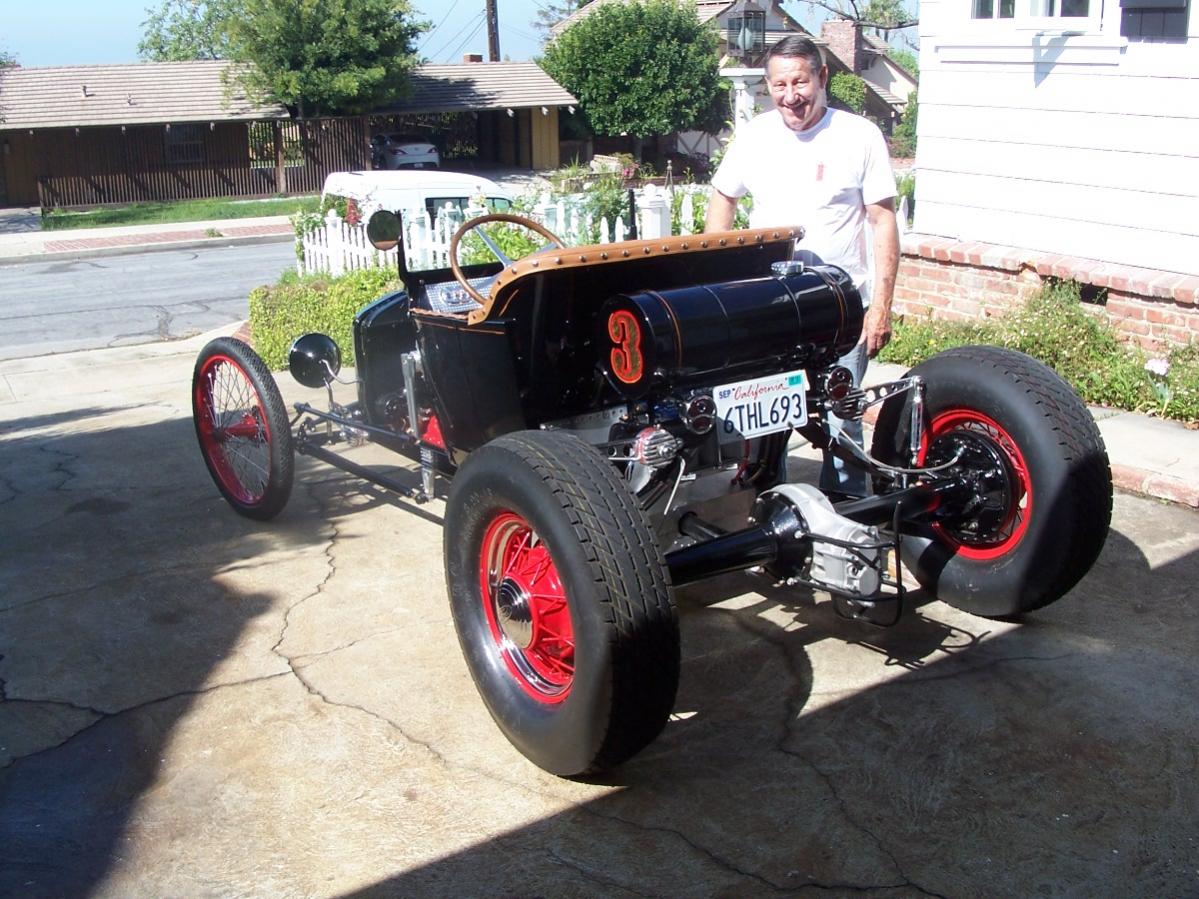

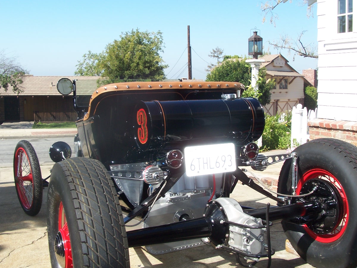

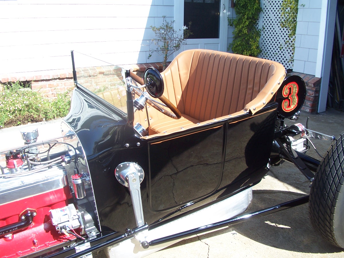

    Here is the second set. Hope you are enjoying the pix !
    Dave :eek:

    nice job.
    ...like the front end , wheels, stance, and rad . no front brakes

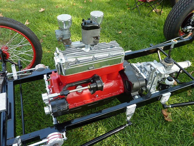

    In the attached photo from the Throttler's picnic, it looks like he was running a fairbanks morse magneto... if that's the case, what was involved in adapting it to the banger? Why did he end up going back to a distributor? Amazing car, attention to every detail.
    thanks,
    ken
  30. Crazydaddyo
    Joined: Apr 6, 2008
    Posts: 3,383
    Crazydaddyo
    That is a Wico mag. the main reason people don't like to run these mags on the street is that they don't have any form of automatic timing advance mechanism.
