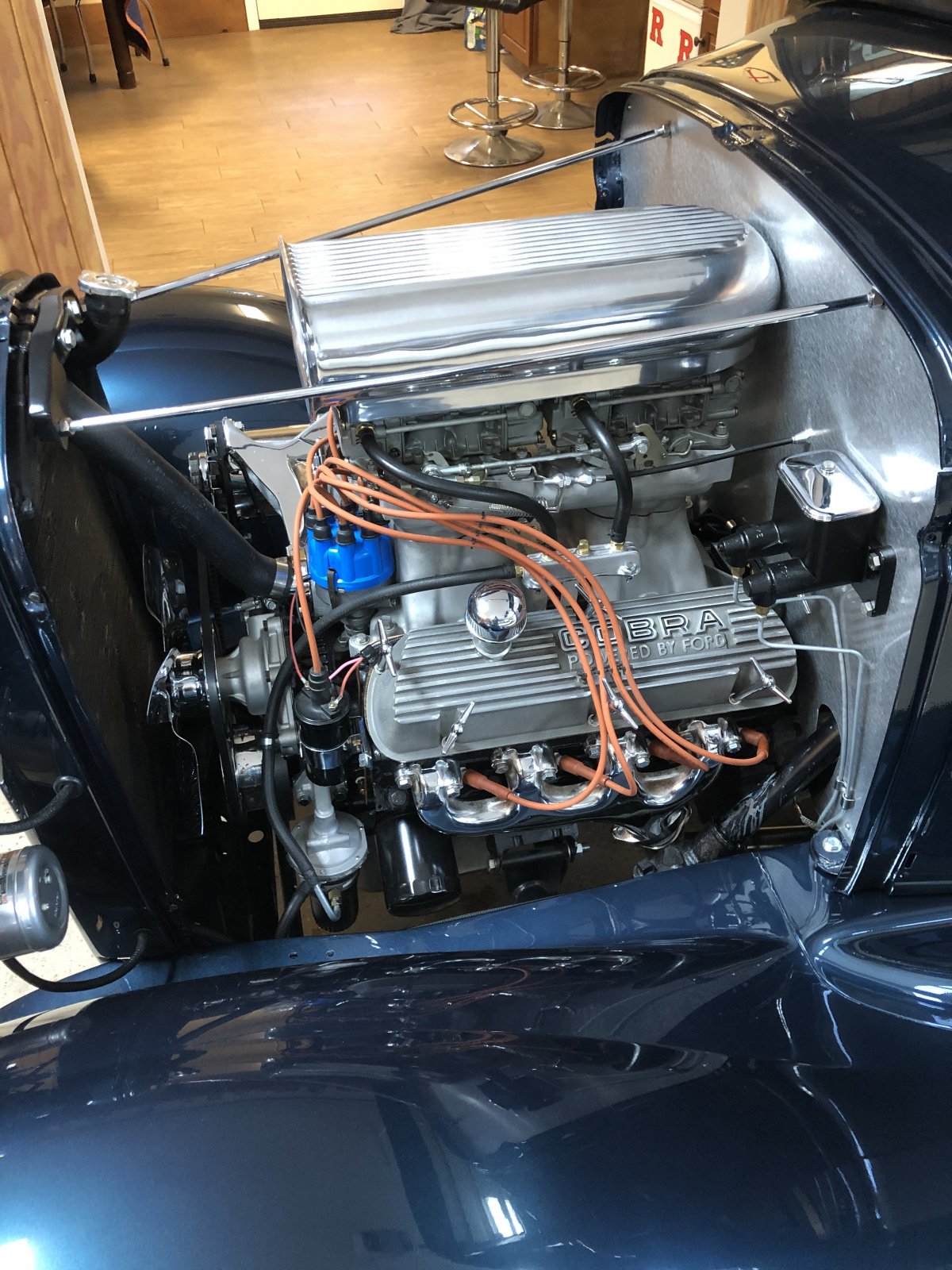

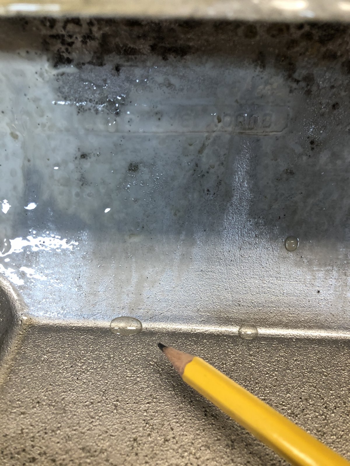

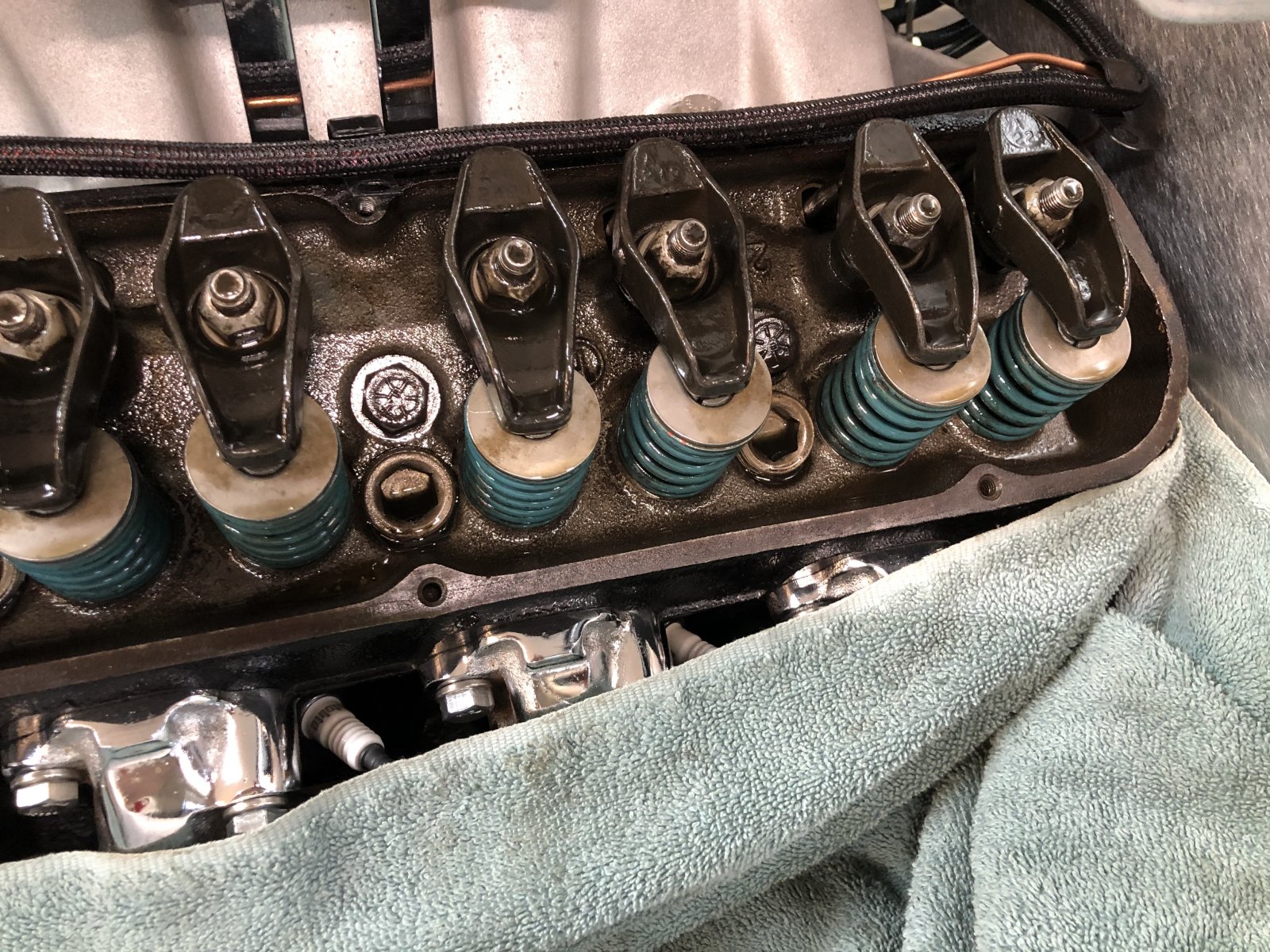

    I have been building this car for four years . I finished the engine three years ago and it has been sitting in my garage. I just drive the car for the first time two weeks ago only around the block a few times to work out any bugs. I removed the valve covers to adjust the valve lash and found clear liquid / moisture inside the valve covers.
    And some white slime. The engine is filled with antifreeze, no signs of green liguid.
    The drivers side cover has a push in breather cap, the p***enger side cover is plugged.
    I dropped the engine oil and it looked fine no signs of liquid. Engine runs great and oil pressure is good . I think this is just condensation. Do i need to add a breather to the p***enger side valve cover? Or a PCV valve? IMG_4682.jpeg 65828577650__5A29EB16-E27F-4491-8D26-E916EF0ADE28.jpeg IMG_4700.jpeg IMG_4695.jpeg

    I think you're correct about the condensation. Install a PCV valve and drive the hell out of it to get it good and warm so the condensation dries up and you should be fine. JMO

    You have moisture inside your valve covers because your engine crankcase isn't properly vented. Like others have said, put a PCV valve in that valve cover that is plugged. You need a fresh air flow through the crankcase to prevent this.

  16. I'm another vote for a PCV valve system. With what you have now, you only have blowby to push out vapors in the crankcase. That's causing a somewhat stagnant condition. Adding the PCV valve will act to purge and exchange pretty near all of that.
    The white sludge indicates a bit of the condensation and oil are emulsifying from the vapor state into a compound liquid state. Getting your crankcase to breathe and longer trip times at full operating temp helps keep things "dry". Very short trips don't get hot enough to return condensation back to vapor.

    Eeegads! That's a lot of moisture for condensation. I hope that's all it is, but that is a common indicator of a small coolant leak, seen it many times. Check the dipstick, is it showing moisture on it, even drops, perhaps even rust? Engine oil has detergents in it that will hold low volumes of water in suspension. Here's something you can do, collect a small amount of the oil out of the engine, and drop it onto a plate of steel you've heated up with a torch up to >212F (don't go too hot!). If there is water in the oil you will see it boil out of the oil. See my caution about getting the plate too hot, you don't want to exceed the flash point or fire point of the oil, just exceed the boiling point of water. In the lab they do this was an electric hot plate, it's called the Crackle Test.
