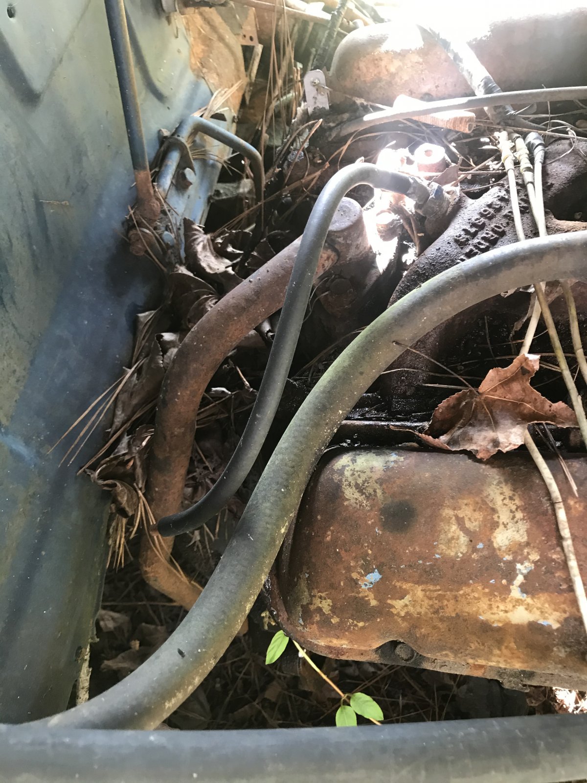

    SBF road draft rube in a beater in the back yard
  25. dmar836
    Joined: Oct 23, 2018
    Posts: 418
    dmar836
    What year, Anthony?
  26. nosford
    Joined: Feb 7, 2011
    Posts: 1,131
    nosford
    I have seen these from time to time many years ago. Part of the regular service included removing the tube from the intake manifold and there was a metal "filter" in the manifold which consisted of a mesh that had to be cleaned out. Usually was full of crusty dirt and oil mix and was always way past it's expiration date. Big block Fords had a similar setup as well.
  27. Has to be a '62-63, Ford had converted to the valve covers by '64 on the SBF. The FE kept the intake location for one more year, it switched in '65, except for the HiPo motors as Ford didn't update the intake manifolds on those.
    F-ONE likes this.
  28. Don’t know. It’s in a 49 merc parts car
    Has a generator and oil fill breather tube in the timing cover
    Blues4U and F-ONE like this.

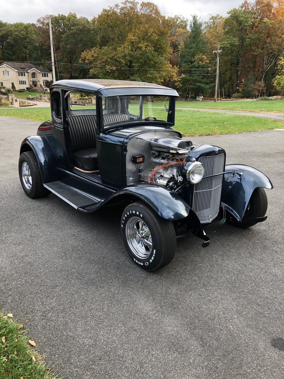

  29. ModelARon
    Joined: Jun 14, 2017
    Posts: 364
    ModelARon
    This is a car that i have been building for the last four years. The engine was finished about three years ago and this is the first time i drove it. I am still finishing the car and its not ready to go an a long drive yet. IMG_4592.jpeg
  30. ModelARon
    Posts: 364
    ModelARon
    When i install the PCV valve where do i run the hose to? There is no port at the carburetor or the air cleaner. Do i just run the hose and dump end so it exits under the engine to the pavement?
    If i don't connect a hose to the PCV valve can any oil droplets spit out of the PCV valve?
