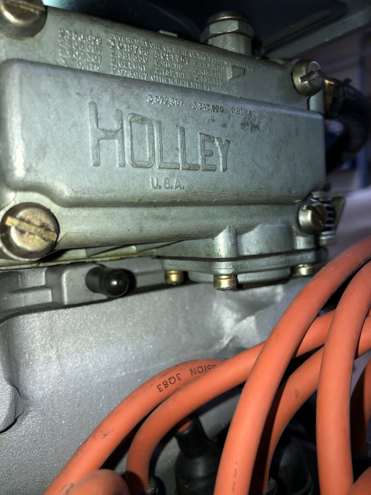

    You need to connect it to a manifold vacuum source. Are you sure there are no ports on the carbs?

    Yes there is a small 1/4" port on each carb. The hose for the PVC valve is 7/16" should i connect both carbs with a tee fitting to get about the same volume that the PVC is looking for? IMG_4719.jpeg

    Your pcv should be 3/8" I'd hose , you might be able to drill & tap for 1/4" npt in the manifold f!ange directly below the port in the picture . You could also. With an adapter ,run off the pictured port , as long as its below the throttle plates .

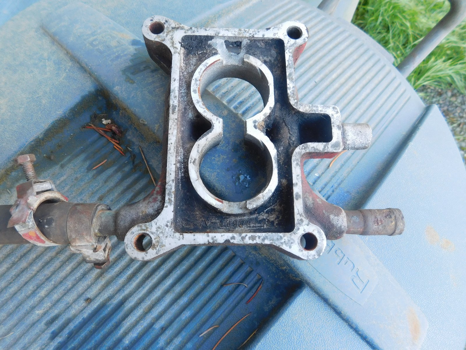

  7. I don't think those ports will offer enough air flow for the PCV to work properly, particularly if manifold vacuum is down due to a large cam, etc. Here's a pic of a typical Ford PCV spacer, this will give you an idea of what's needed...
    Those aren't small notches, showing how much air volume is needed. In a way, you're lucky with having a single-plane intake; a vacuum source anywhere in the plenum downstream from the carbs will work fine. It's more work, but I'd pull the top half of the intake off and drill/tap the plenum for a 3/8" NPT ****** and connect there. Locate it at the back/underside, it'll almost disappear...

    That won't work very well because you won't have enough volume of air moving. One of those ports is ported vacuum, meaning there is only vacuum on the port when the throttle plates are open. The other is manifold vacuum (what you want), but it is too small to effectively operate the PCV valve. You are probably going to need to drill and tap a hole in the intake manifold.
