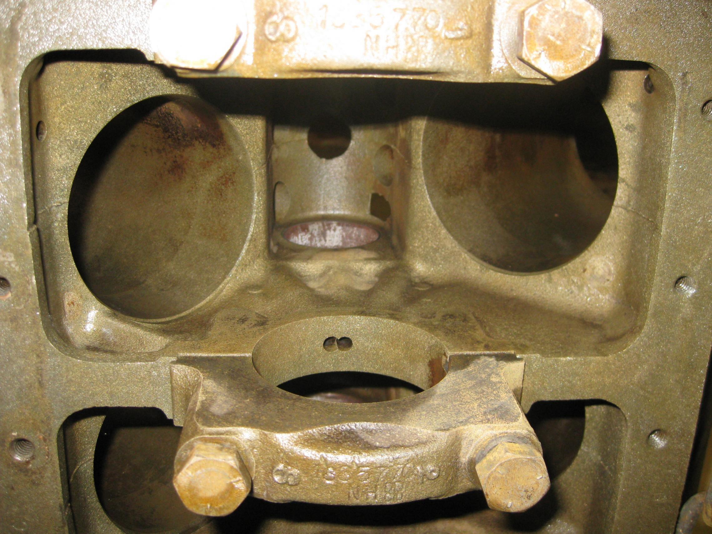

  21. Well I have my first results from my molasses bath. I got soem differential parts that were a bit crusty from years of sitting so I bought some molasses and made up a pail of 5:1 mix and dumped the parts in.
    Before...
    And after...
    The side bearings were seized solid and after a month of sitting I can turn them freely!! This has made a believer out of me!!
  22. It was the raw material for explosives. After hostilities ceased it was left full, a level it had never been before during production.
