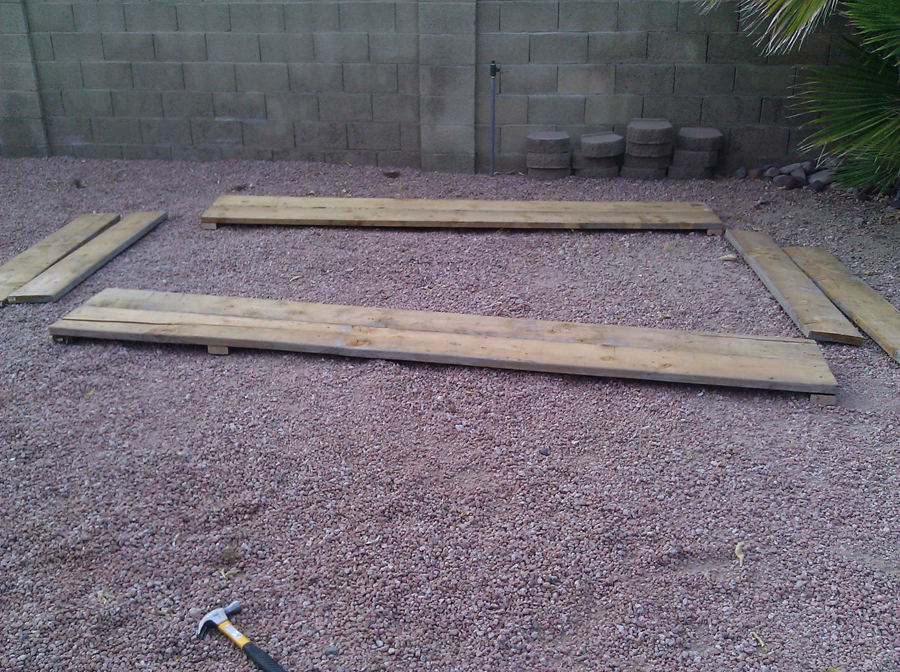

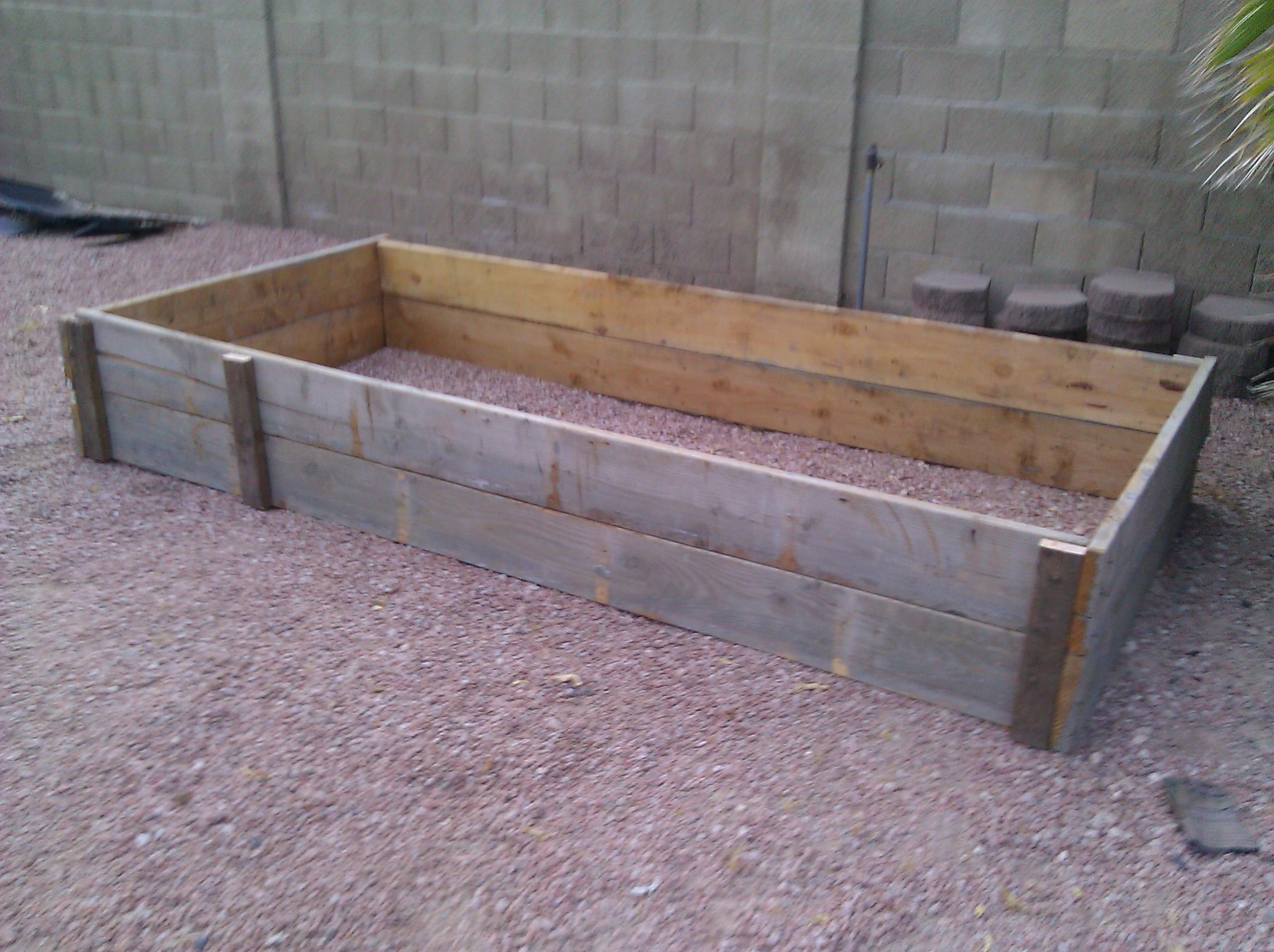

  30. Rhinodaddy
    Joined: Jul 20, 2010
    Posts: 48
    Rhinodaddy
    from mesa az
    Here was my solution to the container problem: Six donor 2x10's x 10 foot long, a couple of HF cheapo tarps, and some heavy visqueen clear plastic. I cut two boards in half and nailed together as shown. Lined the bottom first with a couple of tarps to prevent punctures. then laid in the visqueen. The 'tank' is 5 x 10 feet, and tall enough to completely submerge a Model A front fender.
