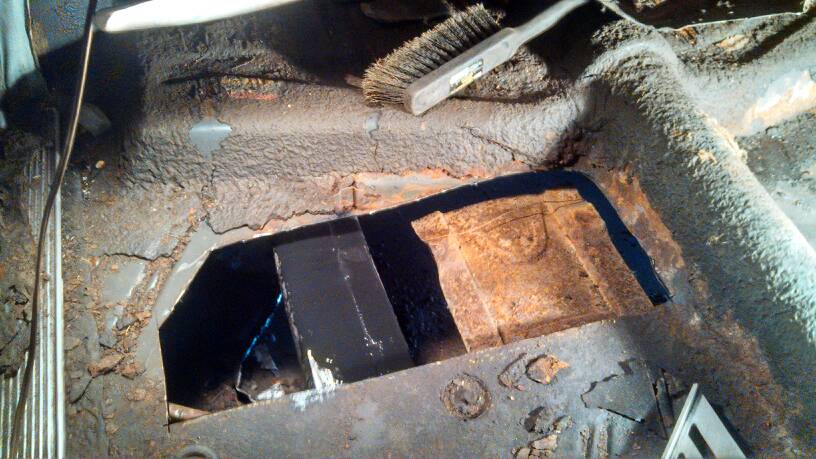

    OK. Catch the car on fire today. Don't worry its OK. I finished the front pans and started poking around the back floor pans to double check them. 1395786441468.jpg 1395786471053.jpg Started with a small hole turning into two large ones. 1395786504044.jpg
    As I was welding on the driver side rear pan I happened to catch some of the old undercoating on fire, I think. Most of the time you get some little flame you just pat with you glove and its out. This was under the car and was a little harder to get. I do keep a jug of water and a fire extinguisher in the shop. Luckily I didnt need the extinguisher.

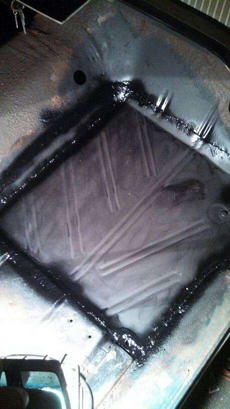

    The p***enger side rear pan is done. The rear under side is done and I just need to finish the underside of the front pans. 1396136492872.jpg
    Next I'll push it out side and wire wheel the hell out of it. All of that old undercoating is gone. I'll respray both sides of the floor.

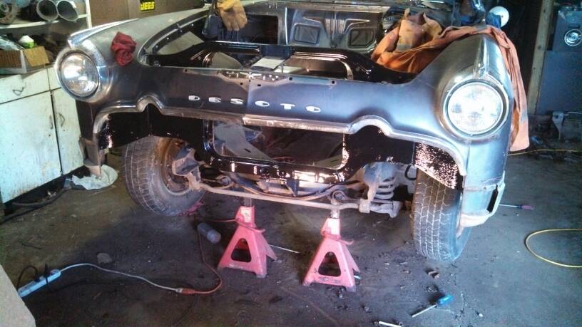

    Keep getting rain around here so I decided to start stripping the front of the car. The grill pan had some pitting so I wanted to address that, this also gave me a chance to clean the core support. 1397067059679.jpg
    There was almost an inch of undercoating on the bottom of the grill pan. I got to finish s****ing that off, and paint that.

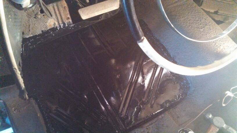

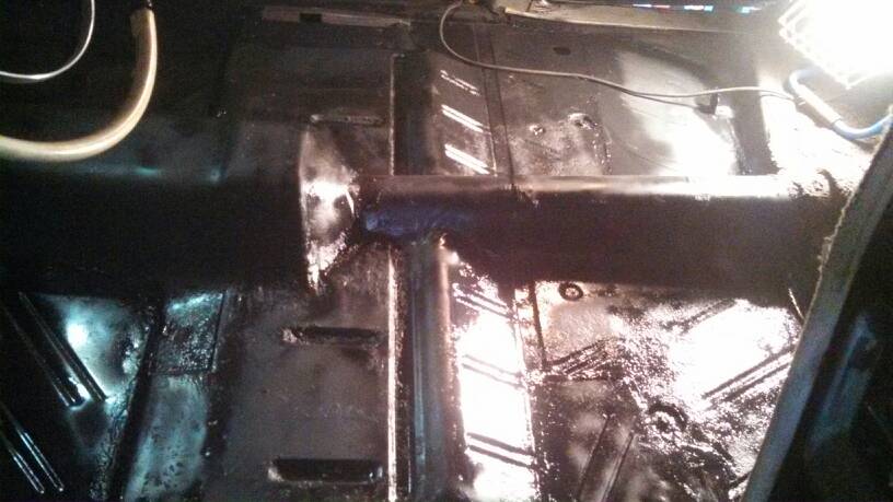

    Not much has been getting done, lately. I did get the floor pans finished welded sealed and painted. 1398297088932.jpg 1398297106109.jpg

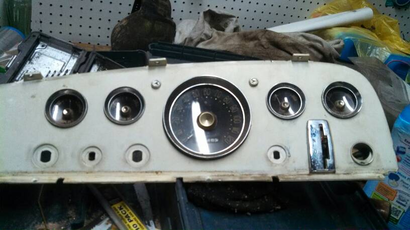

    I did pull the gauges and cut out the old wiring harness. The new one is started being ran, but I need to test all the gauges and see what works and what don't. 1400104663465.jpg

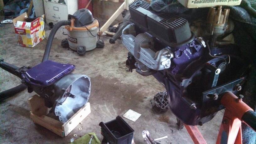

    Big accomplishment today. The engine and trans are in, after I had to track down a flex plate. My original plan was to use a aftermarket plate that I could use a 318 torque converter with. It didn't have the right hole in it for the earlier converter. I got it out of a 85 diplomat. The converter I was going to use was I think a 71 truck. So I traded it to a buddy for a flex plate off a 383 and a early 360 converter. Everything works now. Next is to keep wiring, lots of wiring still. 1402615506377.jpg 1402615524430.jpg
    I think I'm going to have trouble with a fan shroud. I got a lot of room in front of the engine. If anybody has an idea let me know. 1402615644778.jpg
