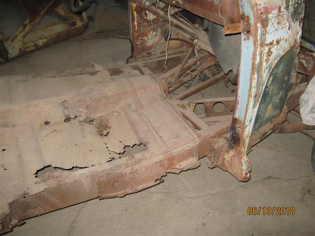

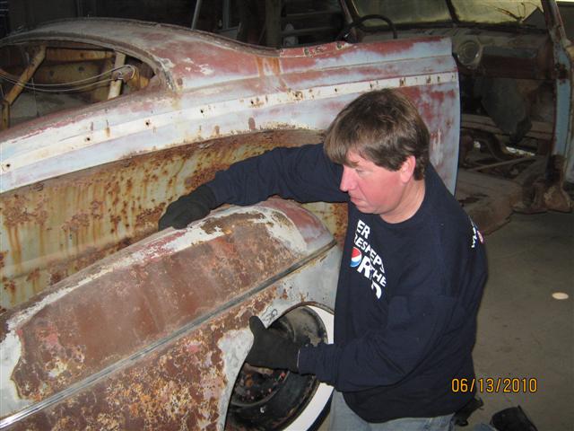

    This weekend, my son and a friend helped blow off all the sheet metal from the beast for a closer look at the condition of the floors and rockers, etc. The body is actually sitting on the frame in 2 pieces...rotted in half. Floors, rockers, base of cowl and quarters are wasted. The doors came off pretty easy, are rotted at the bottoms. Rear tail pan is totally rotted out.
    Just about what I thought, and, perfect for deep surgery...(channel/section/fenders raised)....it will make a great custom if I can muster the grit and skill to pull it off. Anxious to get it to the sand blast pad to clean it up and see what is left after the blasting.
    Comments, suggestions, constructive criticism is always welcome. If anyone is familiar with the channelling/fender raising process, I'd like to hear about it.
    Pics tell the current story.:)

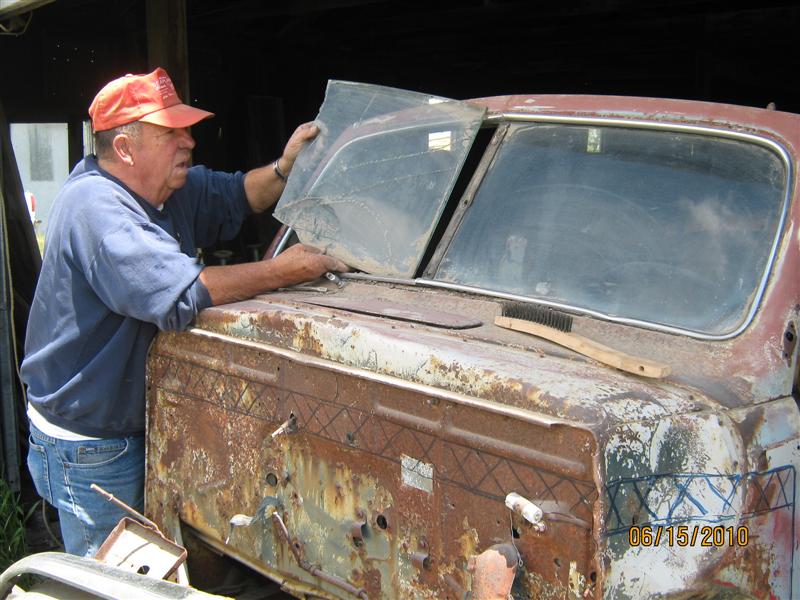

    And, I was able to pull the windshield glass, trim, and dash assembly from the car. Waiting for dry weather to get to the sandblast pad.

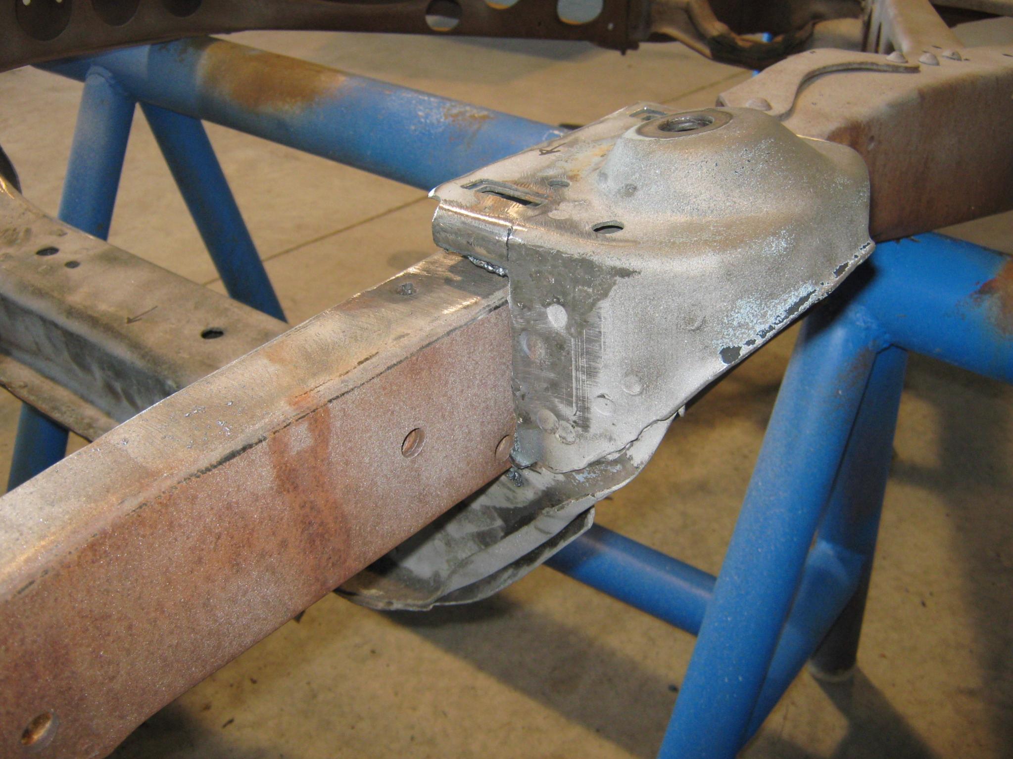

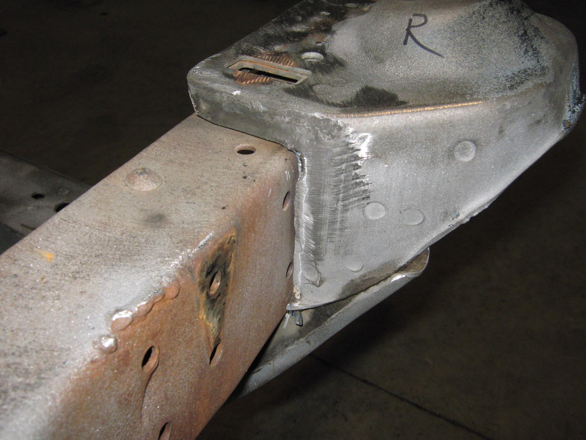

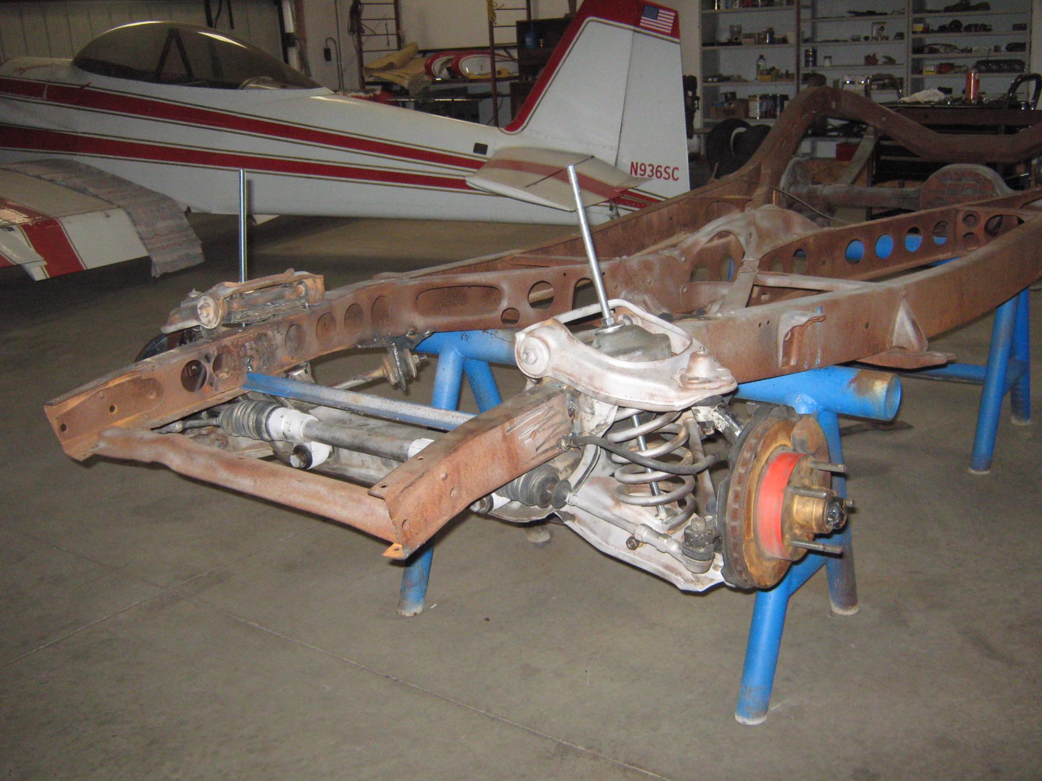

    I have toyed with mounting the body over an S-10 chassis...mostly to provide a proven undercarriage with minimum work so that I can start the chop/channel/section surgery. But, because the body is in pieces, I felt that sticking with the fat Ford frame is a better way to go. And, the Ford frame is familiar, has nice lines, provides me lots of reasons to "remember when" as I work on the chassis and body mounting....Even though there will be more work involved with using the fat Ford frame, mounting the body will be easier. I have all the convertible mounting and bracing brackets that would have to be altered with an S-10 frame.
    So, I pulled a '47 Ford frame out of my bonepile, dusted it off a bit with the sand, and then went out and found a Mustang II front end and 8" Ford rear end with springs. After sandblasting, the MII was disassembled and then cut to fit the fat Ford. Spring eyes were flipped and the springs were shortened 5". Today, I fabbed up spring mounts and layed the frame right-side up....getting ready for the body!!

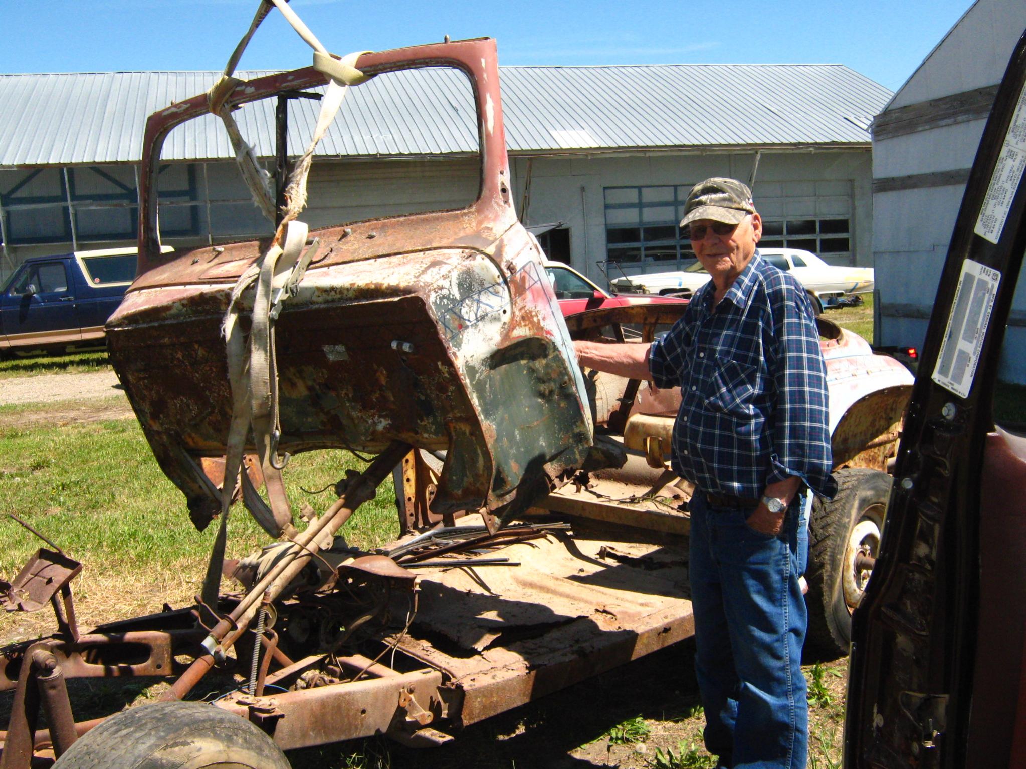

    Today, we lifted the cowl section free from the gennie chassis....came off pretty easy. The sheet metal is terrible, convertible-only castings that give the base of the cowl section strength to support doors, etc. are in good shape. Now off to the sandblast pad.
    Also, I added a couple of pics cutting out the OEM Mustang II crossmember from its framework.
    This is not a difficult job, but it is complicated by the presence of double and triple layers of 12 and 14 ga sheet metal formed and welded together to comprise a strong, lightweight unit. Makes cutting with a torch or plasma cutter a bit messy......If anyone does this, just take lots of time and ease into the final cuts. I welded a couple of 1" angle iron braces across the OEM spring towers to ensure the I was able to fit the xmember into the fat Ford without fear of changing any OEM dimensions. I spread the OEM lower control arm struts 1"...(wanted to go wider, but decided this was enough.)...and fabricated brackets after assembling the front end. I used 1/2" all-thread rod to compress the springs. Worked pretty well. I used 3/4" as a guide to set the anti-dive angle of the upper control arm mounts. Spring relief pockets were cut as necessary and then filled in with 3/16" plate. Pics tell the story. (Final pic is the cowl support castings) :cool:
