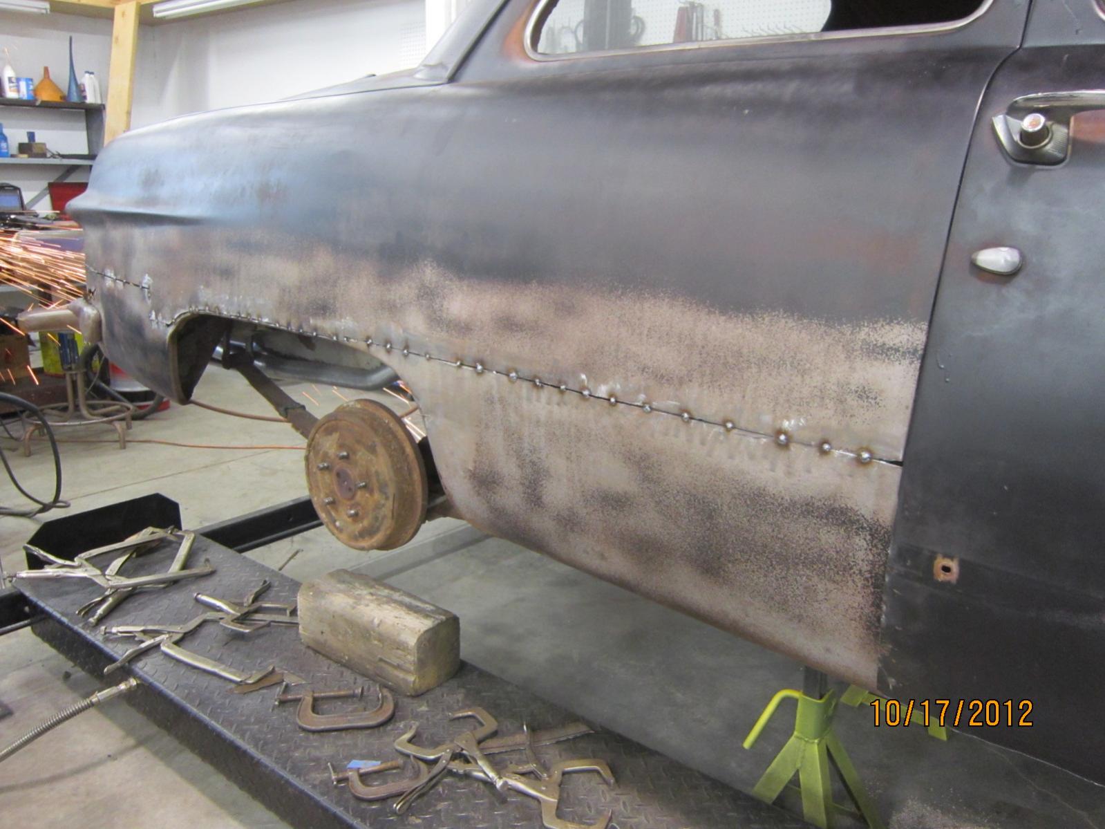

    Report #9 Fully roughed in.....7 concentrated days ! !
    This shoebox is now fully closed in and waiting for the long process of finishing and re***embling. Some rustout in the tail and rear quarters need help and the rockers need to be replaced. We used about 40 man-hours to blow the beast apart before surgery and about 110 man hours to cut, fit, tack it to its new form. Lots of work but plenty of satisfaction.:cool:
    My humble advice to anyone contemplating this:
    1. Ensure there are tools, shop facilities adequate to the job
    2. Make sure the talent and commitment to get the job done exists
    3. Carve out enough time to do it right
    4. Take your time.....enjoy the transformation
    5. Choose a good, solid car to start the project

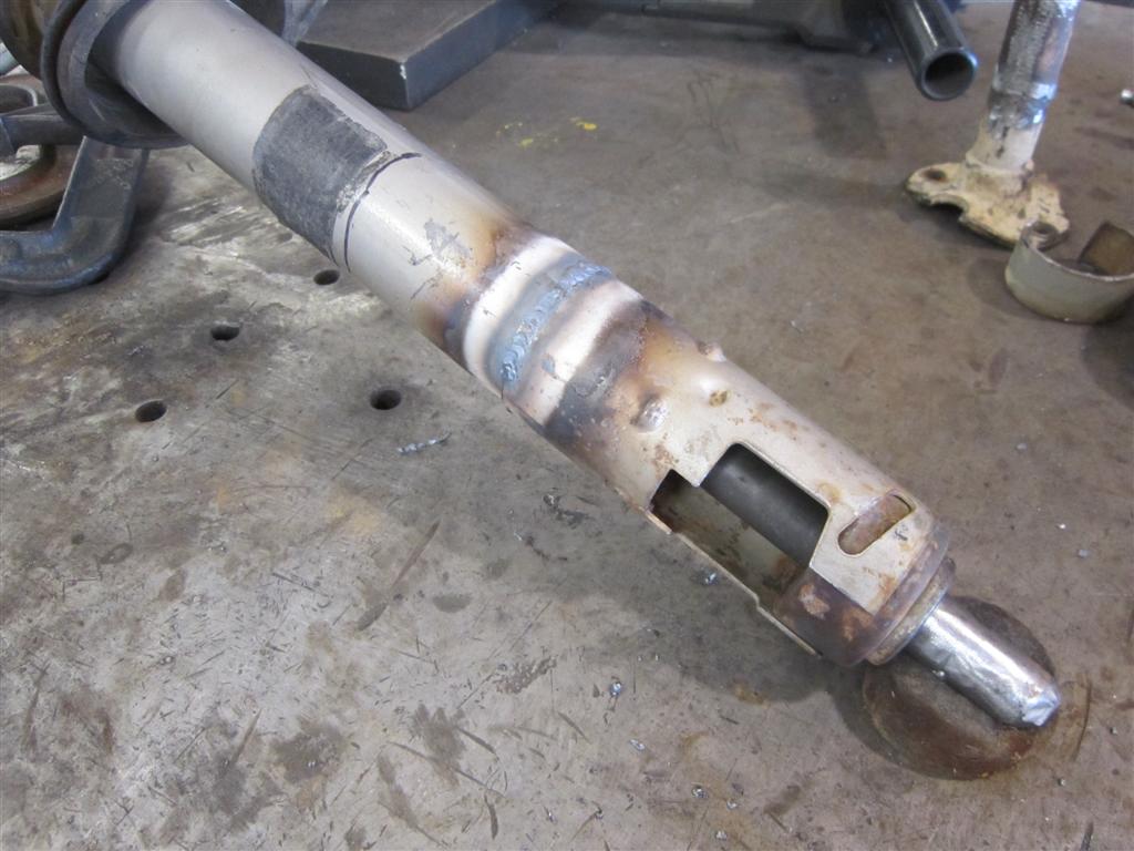

    REPORT #14 (Steering Column install)
    I took a plain 70's GM pickup steering wheel and column from the local junk yard and shortened it to 25 inches (from about 40+ inches) and then after placing a low-sitting seat in the car determined the approximate angle from which to fab up support struts to hang the column on.
    Dis***embly of the GM column, shortening the jacket, shaft, drilling a hole for a through-bolt at the rag joint takes time, but was pretty easy.
    Pics show me making "car noises" at the end of the day. I especially like the sound of open lakes pipes!!:D
    Next step is to add the front sheet metal and doors to the car and then trailer it to an alignment shop to verify all the critical angles.
