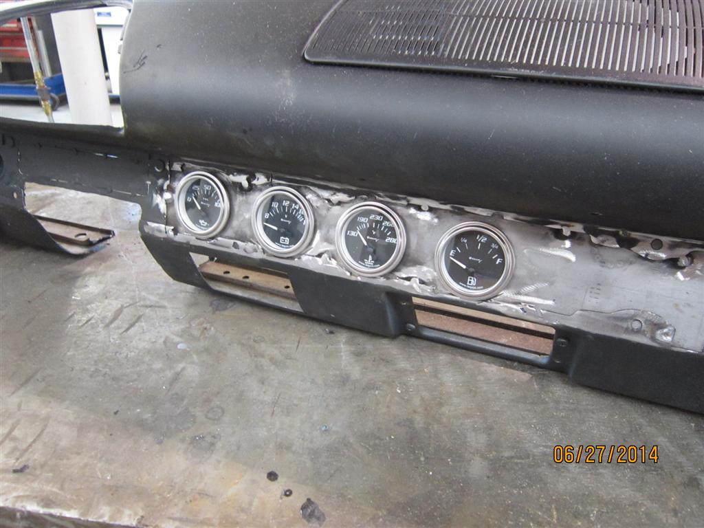

    REPORT #21 Doing the dash.
    I pulled the '54 dash out, finished it with the forward upper part of the '50 dash....(hard on the '50 dash, but the '54 now fits fine and windshield inner garnish mouldings now also fit.) Also had to cut out more vertical space for the steering column which forced abandoning the funky little instrument cluster under the speedometer and filled in several push-pull knob holes from the '54 Ford days. But now it is sandblasted, welded, smoothed, and nearly ready for paint/re-install. Aftermarket gauges are installed. Check out the pics.
