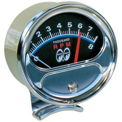

    Hi guys, I just got around to installing a mooneyes tach that I purchased a while back for my 57 Chevy. red wire to ign. + black wire to good body ground, white to light switch, and the green wire to the neg terminal on my ign. coil. I am not getting a rpm reading on the tach. Has anyone else had this problem? Any info is appreciated!

    Try swapping the green and white wires. White is typically the tach signal wire to Coil -.

    This is the one I have

    The white is for the lights, that part does work

    Sounds like you got it wired correctly. The thing to do is eliminate the simple stuff (good ground, etc) which is sounds like you have. Only other thing I can think of is if there are any dip switches on the tach, that they're set correctly for the engine's cylinders (4v6v8, etc). I can't remember if that tach had that option or not. Shouldn't need a tach signal filter if it's a standard coil.

    That's the conventional wiring scheme. Is the tach new or used? Has it run for you before?

    Well, I had a Moon tach that looked just about like that on my dirt modified, and it worked great. You have it hooked up right, so it looks like somebody pawned a defective unit off on you.:mad:

    One thing to check and I've seen this more than once, double check to make sure you have the right side of the coil.
    Also what style of ignition are you running?

    I am running an hei with a canister coil. I hooked the green wire up to the - terminal on the coil. I believe I got a defective tach

    Try hooking up the green wire to the tach terminal on the HEI distributor.

    Seems like mine had a switch on the back for 4,6, or 8 cylinder. Don’t know if that would make a difference at all with the tach not responding if it is incorrect…

    Hey guys, I took the tach apart and found the needle was stuck to the back of the gauge. Freed the needle and the tach now works.
