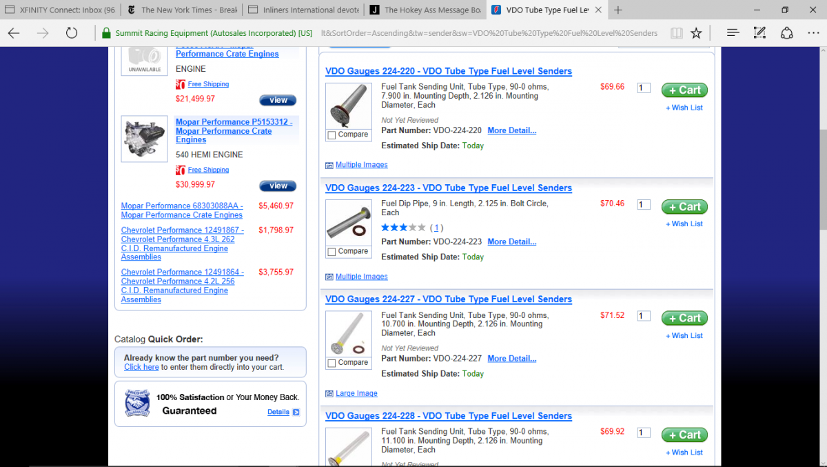

    Yes, That's exactly like the ones I was looking at on EBay for 1/2 the price. The seller said it wouldn't work, with no other explanation. I did reply with why not but go no answer as of this morning.

    Maybe the Ebay seller's version doesn't work at all :eek:.
    My VDO works just fine.

    The tubular senders are available in half inch increment lengths. Just get the longest one that doesn't touch the bottom.
    As above it won't be perfectly accurate due to shape of tank, as stated above, but it will keep you from running out of fuel.
