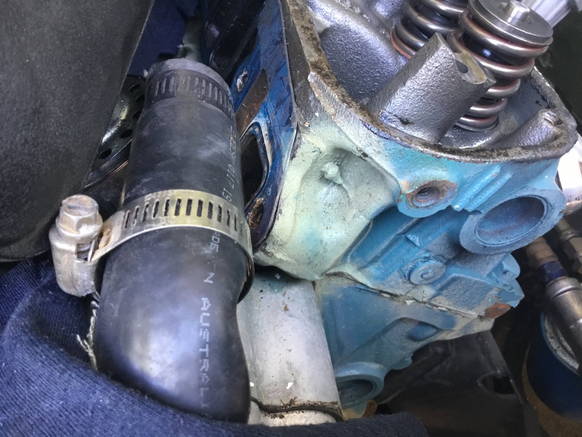

    Hi all, I've got a simular issue as described and perhap dolmetsch can comment further.
    318 gets very hot in traffic and slowly creeps up on hwy above normal. Put an infrared thermostat on the heads immediately after turning off left head is -bout 15 c hotter than right, so much so that the overheating indicator attached to the front of the heads after reconditioning has slid from its original placement. RHS head reading 82 c LHS hand 98 c. This has been going on for years. WHEN I SAY LHS AND RHS I mean when sitting behind the steering wheel.
    So what have I done, three different water pumps, two sets of c.ylinder heads, three different dizzy, two radiators, suck thru electric fans in shroud on 5 core champion radiator current.
    Edelbrock 4 barrel carby current. Block completely hot tanked and deoxidine scale removal, same for the heads, it gets so hot on the LHS that the mopar blue paint has changed colour after the last rebuild. It's fairly stock engine, Kb pistons zero deck height x heads edelbrock inlet manifold. As I have said it's always done this running hot one side even with the stock pistons and cylinder heads, has about 5 thermostats through it too. I have an inline water pump from summit that I haven't fitted yet to see if that helps.
    My question is about the head gaskets, the lhs has a large coolant bypass hole straight from the block to the head and out the front inlet manifold galley, whereas the RHS is blocked at the front and has the hole at the rear essentially forcing all the coolant flow to the rear and to return to the inlet manifold water galley via the cylinder head port to the front. I note BB mopars have equal gallery holes in their head gaskets. Is it conceivable that the RHS is that much hotter because the coolant flow direction is offset by the direct return at the front of the head and is different from that of the left water flow as described. Would there be any benefit connecting a 3/8 line between the cylinder heads at the back to ensure head at the rear of both heads can be equalised. Would there be a benefit in making a 1/4 return hole in the lhs head gasket to bleed stone coolant back to the inlet anifold or would this create not enough cooling at the rear of the block and head, having said that then why is the RHS coolant flow designed like this?
    Also done the radiator caps replacements, shrouds, mechanical fan in the past, was hoping last rebuild with proper and full block chemical clean out was going to work but alas it didn't, comments please

    Spaghettijet,
    I think you are on the right track but don't think the 3/8 line or 1/4 return hole is the answer.
    I think your issue is the head gasket. Wrong side or flopped over.
    The coolant holes you mention at the front of the block (to front of each head) are supposed to be covered (sealed) by the head gaskets on BOTH sides. This will force coolant to rear of block, up and through heads then to front of heads into front of intake manifold and out through thermostat housing to radiator.
    There is a youtube video I found of a 318 rebuild called "Garage34 - Small Block Chrysler 318 - Construction Video" Look at the head gasket and how it covers front water passage. Here is the link:

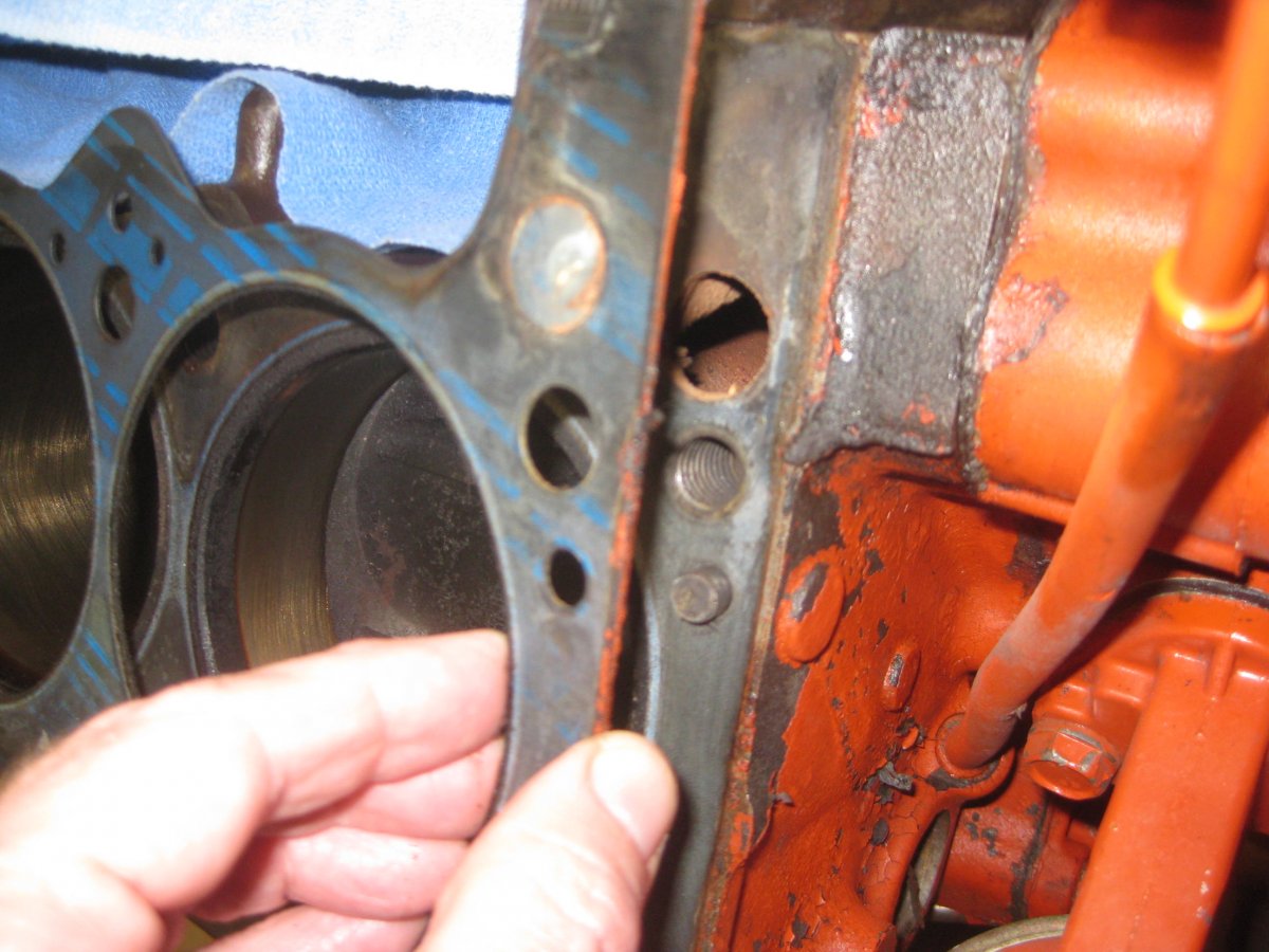

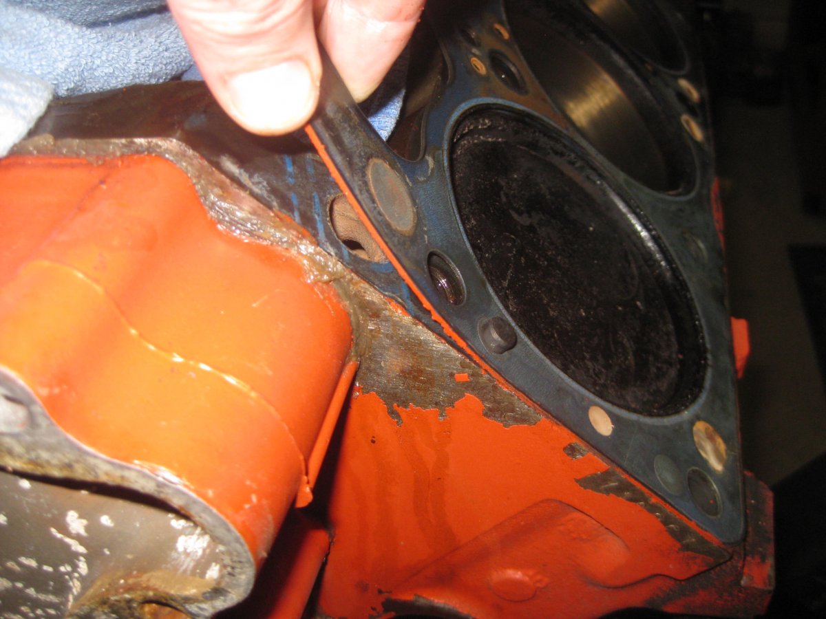

    Spaghettijet,
    I just took the heads off my '69 Dodge 318. The head gaskets are still stuck on the engine. The water port at the front of the engine is covered on the driver side and the front of the engine on the passenger side. Hopefully these photos will show. You can see round imprint the heads made on top of the gasket but the gasket does not have holes for the FRONT water ports.
    Ed

    Thanks Ed, that's pretty conclusive, I am soon to take the heads of and replaced with alloy edelbrock units, so I will make sure they are same with the covering of the front holes

    Hi Ed, I have began disassembly to replace heads with edelbrock alloy units, I checked the gasket of the heads and can confirm that both left and right sides have the water return hole covered at the front of the block on both sides. Attached is photos of each side of the heads, you can see that the right hand head has been running a lot hotter than the left hand side, as mentioned prior every conceiveable item has been carried out to try and resolve this issue that has plagued the car for the last 20 years. Any ideas appreciated.
