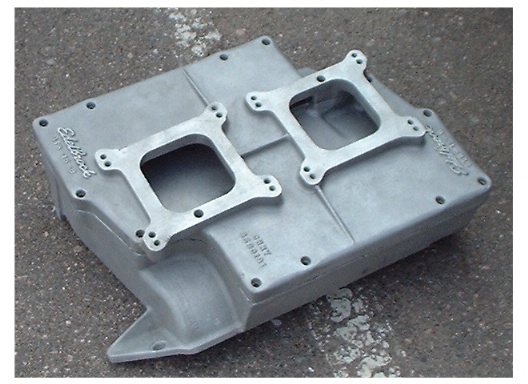

  3. You want grunt on the cheap? Mill the heads about .060 to bring the compression up (you will need to cut an intake about .072 on the faces as well) and put a healthy cam in it -292 advertised will work well and give you a hair raising idle- it will surprise you. While you have the heads off, do a throat cut while getting the valves done and pocket port them, big improvement. If you go the long ram route you wouldn't have to cut the intake faces.
    A great retro looking intake that works really well on the RB is the edelbrock dual plane dual quad.
    or if you can find one, the STR-14 is pretty awesome, with six pack or dual quad tops

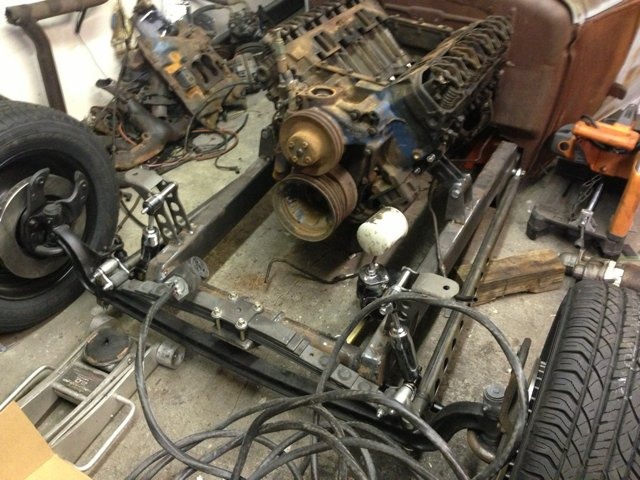

  10. stubbsrodandcustom
    Joined: Dec 28, 2010
    Posts: 2,599
    stubbsrodandcustom
    from Spring tx
    Guys all the hardwork is finally showing some payout. So after a lot of fabricating and steel I got the motor sitting down where it needs to be. I'm going to have to run a oil filter replicator due to the vega box but should be really good in there finally. I sprung for the tinman fab motor mounts. They just looked cool. And big thanks for the 440 source tip. I got a shallow sump oil pan from them already their prices are very good. Going to get a set of heads from them also soon and then embark on getting some more c.r. On this ole girl. So should I get some new pistons that are flat tops or just valve relief ones ? Also you guys said sometimes they just took some chamber out w pistons. Any certain year piston or company I should look at for getting something to up the ratio. I'm s****ping the tunnel ram idea I think. Really thinking about the 3 Duce setup or get the Holleys for the 6 pack. I like the long ram but just dunno if it would fit the car good! Here are the pics of the ole gal down in there before dropping the motor down 2 more inches. ImageUploadedByH.A.M.B.1375099598.767996.jpg ImageUploadedByH.A.M.B.1375099698.667675.jpg ImageUploadedByH.A.M.B.1375099732.016935.jpg ImageUploadedByH.A.M.B.1375099765.567057.jpg

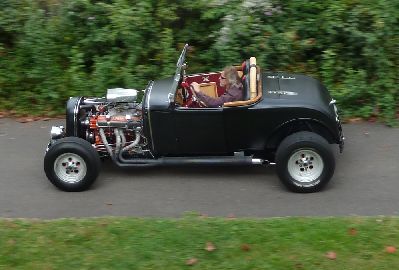

  21. 67coronet
    Joined: Aug 2, 2009
    Posts: 178
    67coronet
    sorry, heres a couple of pics of ours.

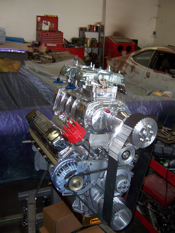

  23. mopar210
    Joined: May 18, 2008
    Posts: 392
    mopar210
    i bench built this 1970 bb mopar (bought on the cheap) and used a set of 906 heads and put a comp cams "thumper" with some stout lift and im using this real tall weiand intake and 2 450 holley carbs and im very impressed with the combo . I have had many mopars over the years and still own a 70 challenger with the 440 in it pretty hard to beat a bb mopar I have beat the **** out of many a big block and have yet to really lunch a motor . with the combo we have on the rambler along with the 4:56 gear out back - this thing will make you take back things you didn't steal - you are gonna love the mopar motor - good luck .
