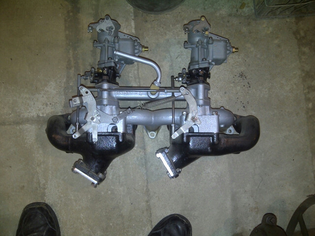

    I have several big trucks with the sodium filled valves. Usually its local governments (municipalities) that bought them for snow plowing or dump trucks that ordered that option and starting June 52, in the 250 or 265 the factory dual intake and exhaust were options I will attach a picture. New sodium valves are still available if you need some .

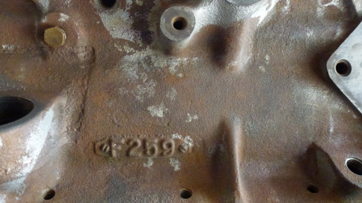

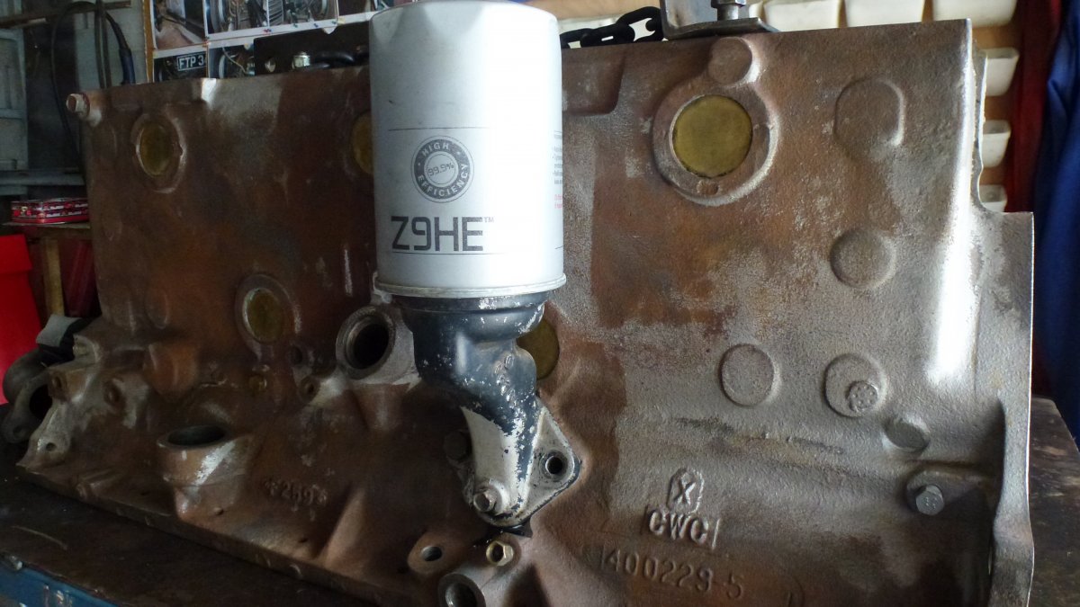

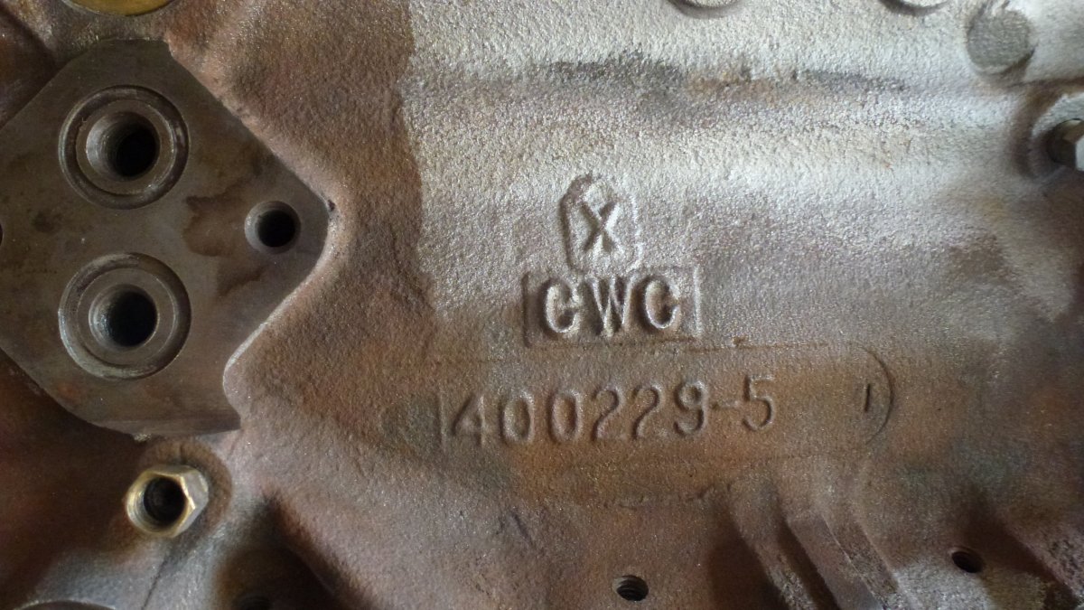

    image.jpg image.jpg image.jpg image.jpg Several photos of engine and car it is out of. hiteckh could the casting f 2 59 be the date ie Feb 2 1959 ?

    That spin on filter is one I haven't seen before. It resembles the cartridge filter used on Chrysler Windsor cars 1949 - 54 but with a spin on filter. This tells me you have full flow filtration and a truck engine newer than 1954. That engine was used in Dodge trucks, 2 ton and larger, up to 1962 and in marine and industrial use until 1972. Military Dodge Power Wagon 4 wheel drive trucks until 1968.
    I don't know exactly when they made that style of filter, as I say I never saw one like that before, but it must be newer than 1954.
    It is kind of a moot point because internal parts like pistons, rods, bearings etc are alike and interchangeable over many years.
    I just had another thought. They used to change the distributor design every couple of years, and used different distributor models on different engines. Can you get the make and model number off the distributor? This may help narrow it down, and the info will be valuable if you need points, condenser rotor or distributor cap.
