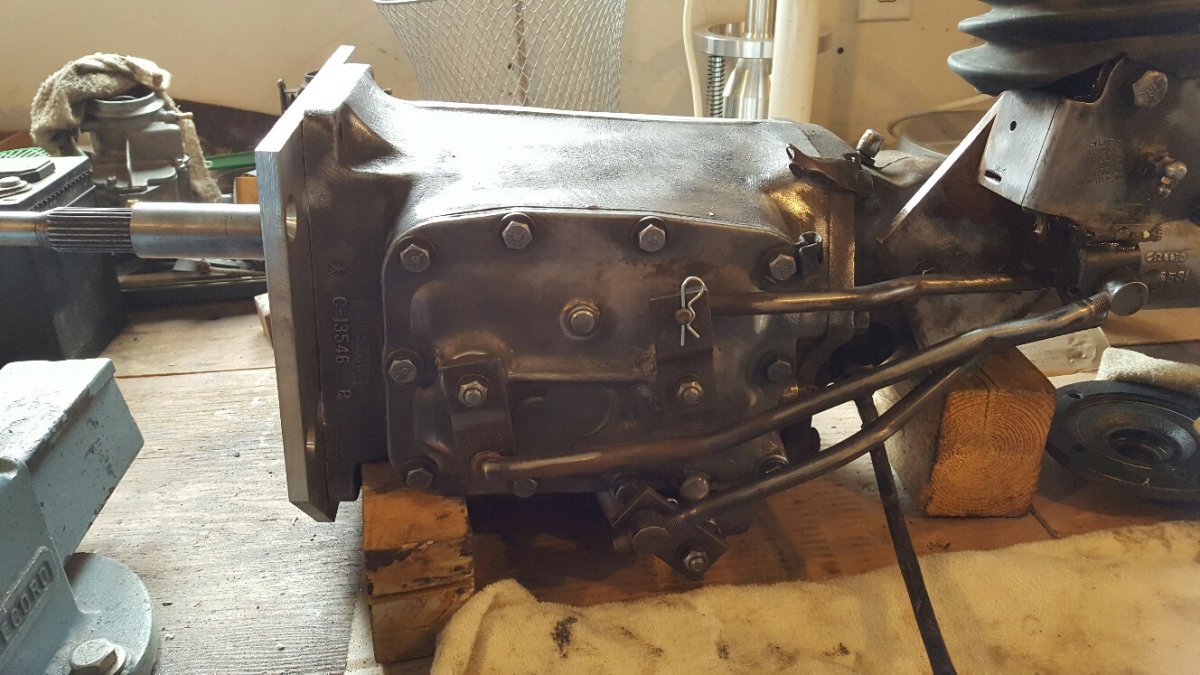

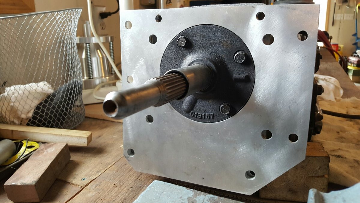

  29. Flat Six Fix
    Joined: Feb 6, 2010
    Posts: 1,270
    Flat Six Fix
    Yup that's Tims blog, I also have a blog on that website dedicated to the A833 conversion, and any high performance improvements.
    Here is my trans, the adapter plate.
    Every thread, that was created on the topic of the A833 overdrive and/or High Perf topics, such as multi carb intakes, dual exhaust, hotter cams, were dogged at every opportunity, by 3 main perpetrators, the 3 clowns are complete ***holes, and stir up any and all discussions related to the A833 conversion, they lurk here and know who they are...
    whtbaron and j hansen like this.

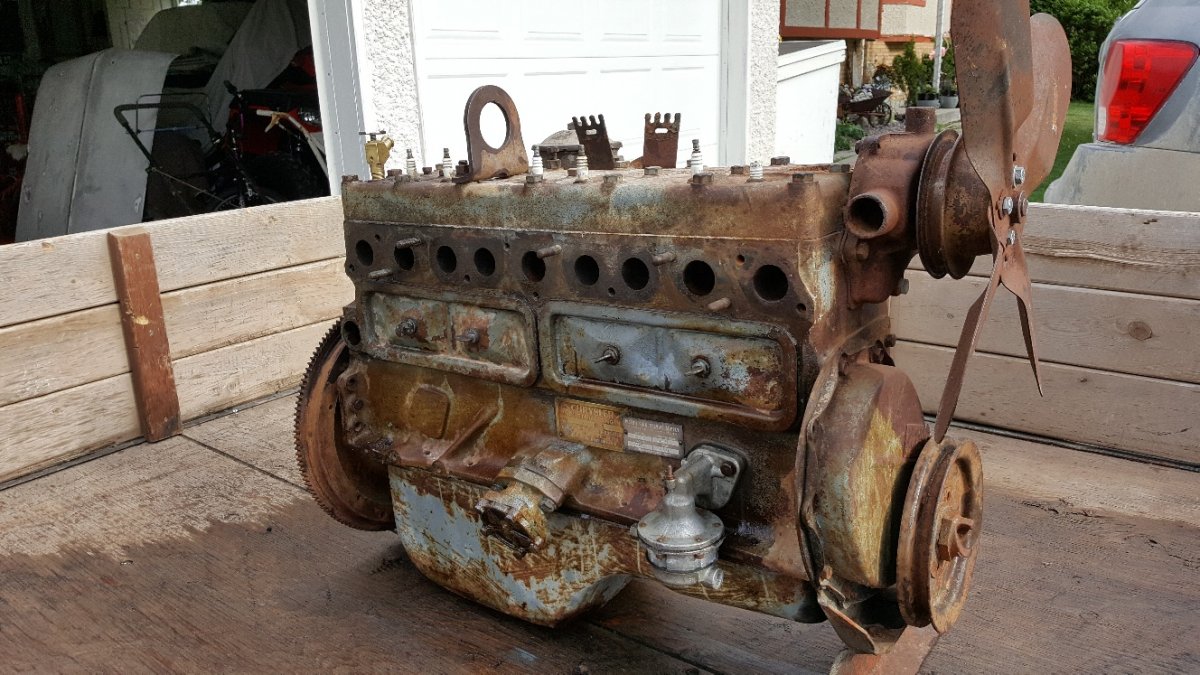

  30. Flat Six Fix
    Joined: Feb 6, 2010
    Posts: 1,270
    Flat Six Fix
    My donor engine a Chrysler Industrial 265 bored .040, gonna bore to .060 possibly to clean it up new pistons rings etc. This will have a hot cam fairly high lift and duration, shaved head, or an Edmunds aluminum head, dual carbs and headers.
    I am thinking it will pack a bit of smack...
