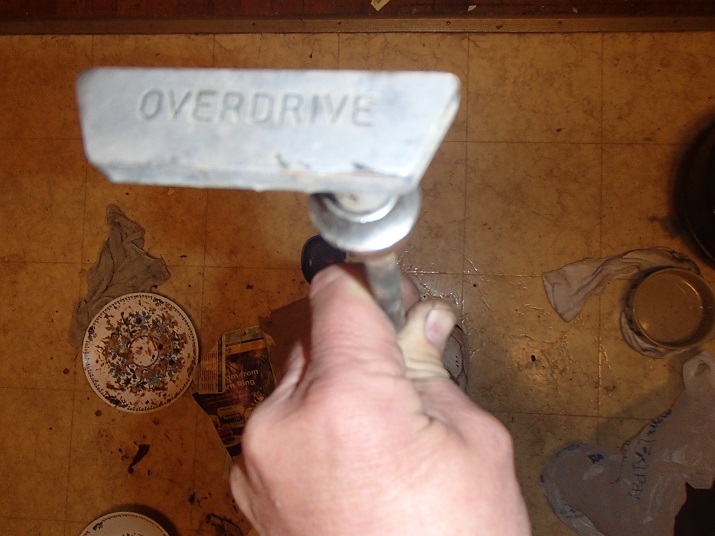

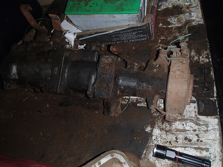

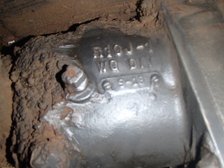

    Well I have been looking for almost 3 years for an OD trans for my '59 Dodge with a flathead. I got a text from a friend in the military telling me about one. I made a call and found out this person had 2 of these transmission. 1 in a '58 Plymouth wagon and the other in a '57 Plymouth 2dr wagon. I bought both and other parts from these cars. I also bought the 410 rear end from the '57 wagon because it was a flathead six engine. My understanding by the Plymouth Service manual is that the flathead 6 with OD only came with the 410 rear. The V-8 OD trans cars came with a higher gear ratio. I got the carb relays and OD handles and some of the wiring. I think I can take the Demon with the Flattie with an OD. lol

    I was wondering about the switch connected to the carb to help activate the OD. I still want to use the OD cable handle. Are you saying use a toggle switch in place of the switch located on the carb???

    The toggle switch is used instead of the kick down switch. It is used to actuate the relay which supplys power to the overdrive engagement solenoid. As it is a byp*** of the “automatic” kick down, the operator has to pay attention that the toggle switch is not engaged when stopped as the trans will not go into reverse while the solenoid is engaged. The cable portion is necessary for the mechanical engagement.
    I found that 2nd gear overdrive was a very useful gear. I ran the overdrive in my ‘53 Dodge panel for about 10 years and about 15 in a ‘46 Plymouth sedan.
    I would imagine a 5 speed of some sort would be just as useful as a good gear spread is what the limited rpm range of the 6cyl needs.
