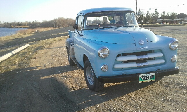

    Just got back from a nice drive, it is cold here 45f, 25-30 mph northwest wind. I had fun drove both town and country, and drove her like I stole her, pedal to the metal a lot.
    I did find though on the last leg of the drive on the highway, a super strong cold wind, had to really push her to get up to 65 mph, once there no problem, she is a bit sluggish with 3.23 gears and a strong head wind. I would equate going against a very strong wind is like hill climbing a lot of load on the crank.
    I had a blast driving tonight.....PS Winnipeg Jets are going Duck hunting tonight at the MTS center....yeehaww
