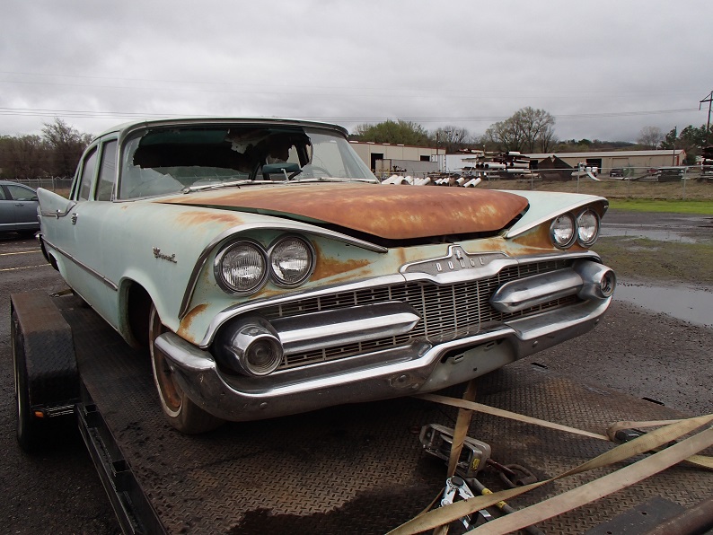

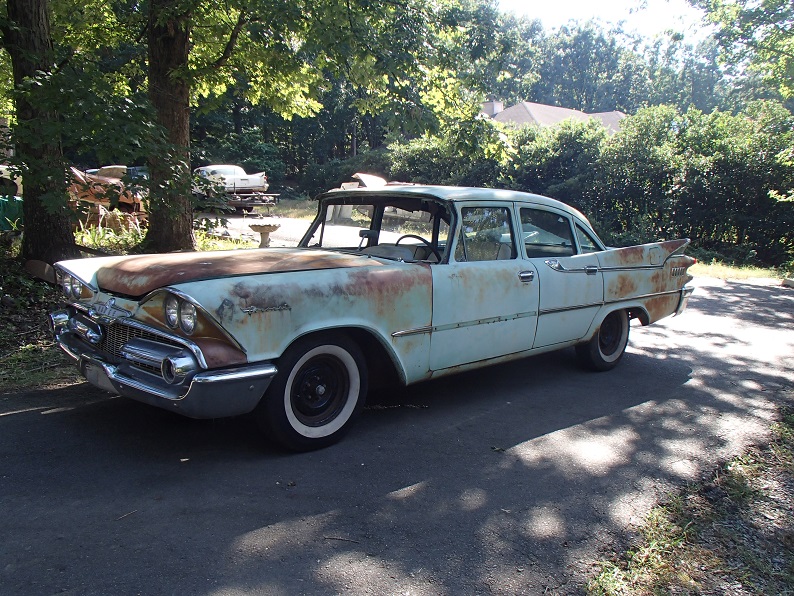

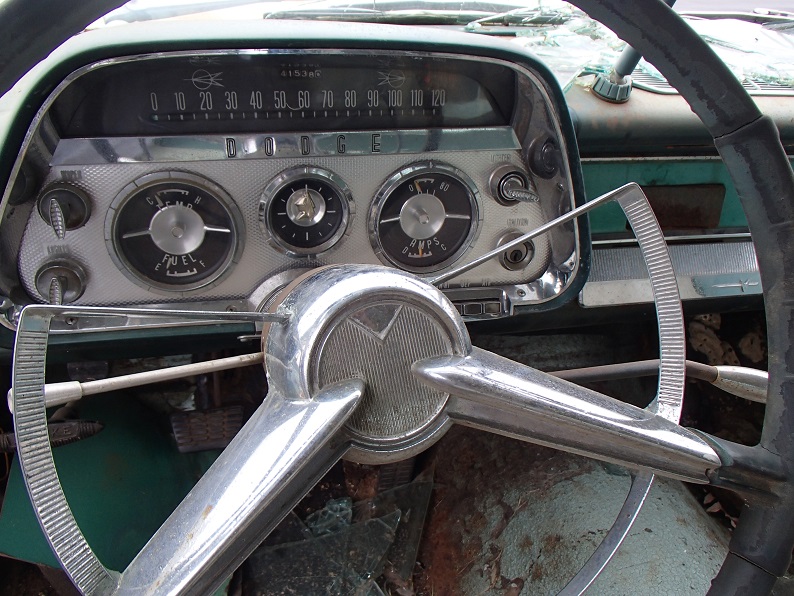

    I didn't know much about these Flathead mopar motors. I've had a few /6 motors but I just bought a '59 Dodge with a 230 and 3 onda tree. I'm working on get it running. I pulled the plugs out to soak down the cyl's and found this freeze plug issue.

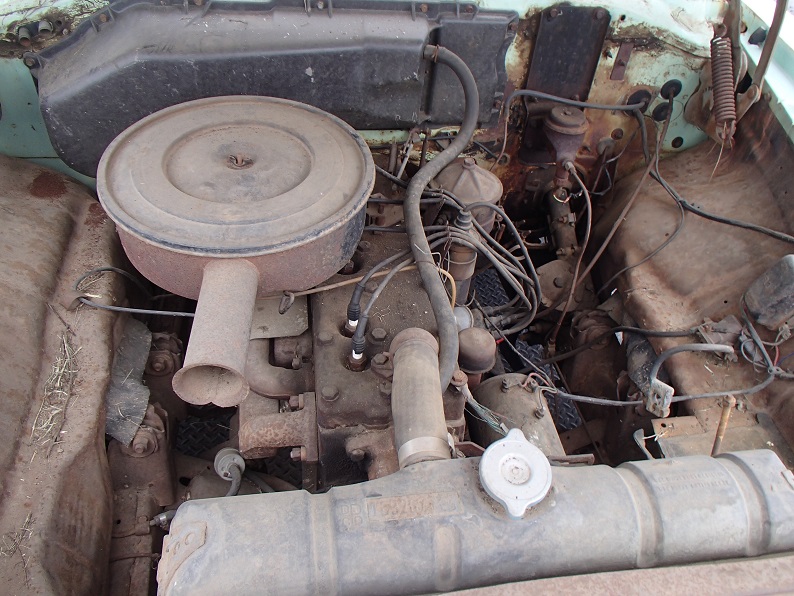

    I know there isn't a BIG following for these types of cars on this site but I wanted to give you an update It was last tagged in 1986. After soaking cyl's and replacing freeze plug and fuel pump I hooked up aux gas tank and started cranking and it fired off. There was so much smoke the neighbors thought something's on fire. I shut it off and rebuilt the carb and brakes knowing that this car was going back on the road. Here are the latest pics!!! Who needs a windshield when its 85 degrees and sunny.
