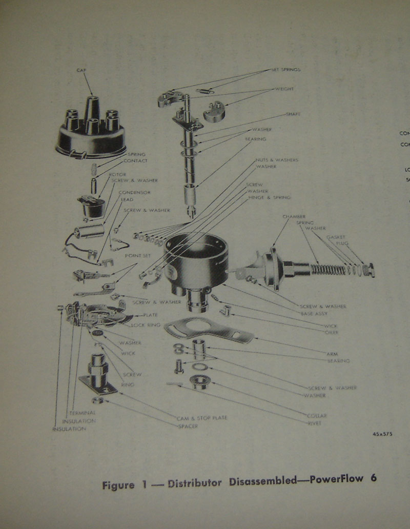

    Do you by chance have a parts diagram? I have never disassembled a distributor but would like to remove the breaker plate assy and clean/paint the dizzy. I have found a new breaker plate, vac adv, but I not sure what else is in there. Is there anything to rebuilding one of these?
  4. Bugman
    Joined: Nov 17, 2001
    Posts: 3,483
    Bugman
