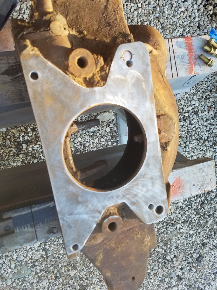

  18. Inline
    Joined: May 13, 2005
    Posts: 261
    Inline
    from Ohio
    Adapting a T5 to the truck bellhousing is fairly straight forward. The S-10, v6 Camaro and Mustang T5's have input shafts long enough to make this work. You actually do not need an adapter plate.
    With the truck bellhousings, there usually is enough material to be able to redrill for the GM bolt pattern, however, the top driver's side bolt usually interferes. When I do them, I take and plug it with a bolt, grind it flush, stake it and then redrill. Also, the pilot hole in the bellhousing is 4-3/4" compared to the 4-11/16" of the GM T5. I always make a a thin ring up that presses onto the bearing retainer of the T5 to maintain alignment.
    The stock truck throw out bearing ID is 1-3/4" compared to the 1-3/8" diameter of the T5. I make up a collar that presses onto the T5's bearing retainer so that the stock bearing fits. The dodge pressure plates use a larger diameter bearing than the GM's so you need to use the original mopar release bearing. If you use the truck bellhousing, you have to use the truck release hub since it also fits the clutch shaft. That is unless you go to hydraulic which might be an issue because of the previously mentioned diameter of the bearing needed for the stock pressure plate.
    You will need a new pilot bearing too. The stock bearing has a much larger ID than the T5.
    If you have a 10" pressure plate, use Napa part # ND4201 for the clutch disc.
    I agree that the 833 swap is a good candidate at they are much stronger than the S-10 T5. However, at least by me, they are harder to find and way more expensive. It all depends what you are looking to do. I have had a T5 behind a 218 for the last 15 years without issue in a driver.
    Over the years, I have done quite a few of these swaps as well ones with the standard p***enger bellhousings, feel free to get hold of me and I can talk it through with you.
    kidcampbell71 likes this.
