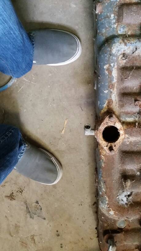

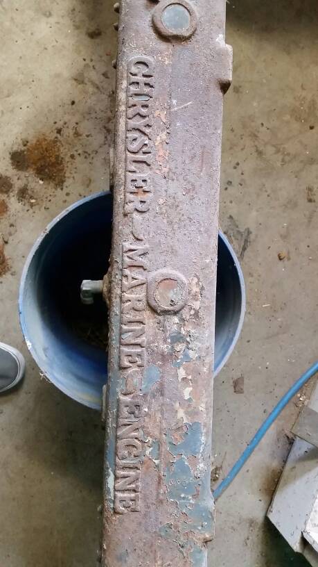

    Does anyone know if anyone wants a chrysler marine manifold? It was designed as two in one intake and exhaust, and it's updraft.
