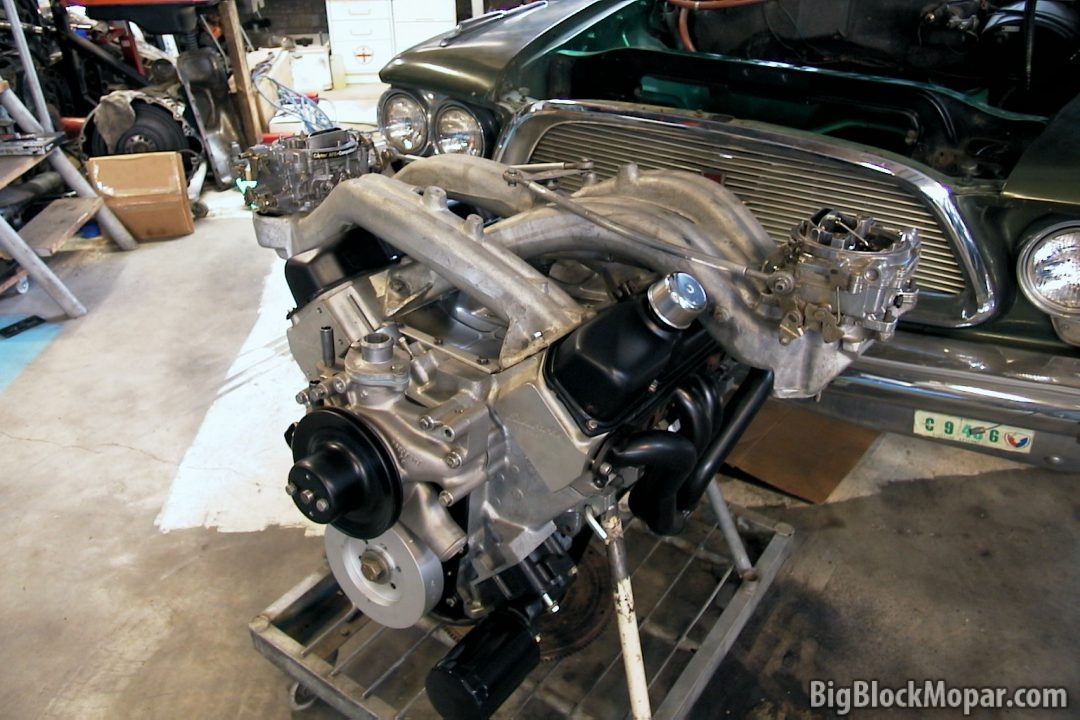

    I'm trying to set myself up with an early 60's Mopar Long Ram intake system for my 440. I've done a lot of research. There's not an overabundance of knowledge available. And not all of what's out there is correct. But I sifted through and got a pretty good handle on things.
    But I still have a couple questions. Maybe some of you can help me figure this out.
    Nobody talks about the carburetors. This system uses the only spread-bore Carter AFB carburetors that I'm aware of. And they're rare. And they can be expensive. As far as I know, all other AFBs are square bore.
    I'm looking at an intake manifold locally that's in very good condition.
    NO CARBURETERS.
    I'm talking with someone on the internet who has an intake for about the same money.
    WITH ORIGINAL AND COMPLETE CARBURETERS. Unfortunately, the chokewells in this intake have been corroded to the point that they need some weld repair.
    You guys have any thoughts about what might be my best choice?

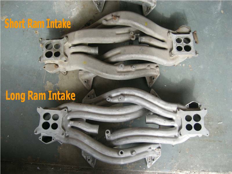

    Considering that the choke pots can be blocked off on both the bottom and top, you can safely work with corroded manifolds as long as the corrosion does not extend into the intake runner plenum. You can use electric choke AFBs or manual choke carbs with a pull cable (I've done them both ways).
    You haven't mentioned prices, but just a bare pair of intakes with no other linkage or parts is worth at most 1200-1400. You'll easily spend another 1500+ just getting all the linkage, balance tub, carbs, fuel lines, air cleaners etc...
    The correct carbs that one guy has should be marked 2903S in the base of each, if they have that they're worth probably 350-500ea as rebuildable cores.

    My understanding is the manifolds take the old Carter AFB and that the carb b***es have to be bored out to accept an Edelbrock. They are not spread bore.

    Looks like spread bore to me.

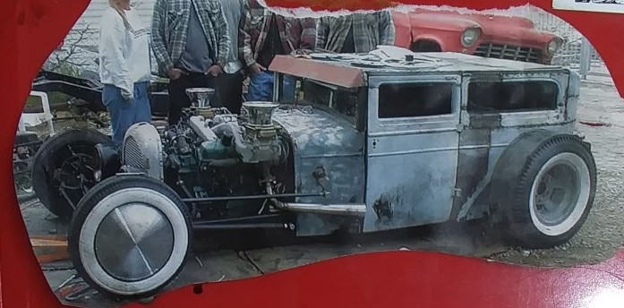

    Yes, you can Mount Holly carburetors on them and it will work fine. A friend of mine RIP, had that same set up on a 25 Chrysler with a 440 in it. It's on the cover of the David Perry book Hot rods and pin ups. The car club that we Are all in , wheel tramps Have bought the car from the estate and are planning on putting it back on the road. He fabricated his own linkage out of solid rod. And for the crossover pipe, he int dino drag.JPG 20230607_181453.jpg just used a radiator flex hose. And it's lasted about 15 years. I'll find some More pictures, but here's a dragster with the setup and a picture of when it was a day old in the front yard.

    Your buddy (RIP) put together something quite similar to what I'm thinking of for my 1926 Dodge 4dr.
    And the Holly carbs fit!

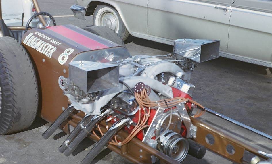

    Even with the bowl pointed toward the runners! Cool.
    The Holley carburetors are turned the other way on the dragster. That puts the primaries and secondaries front and back. Interesting.
