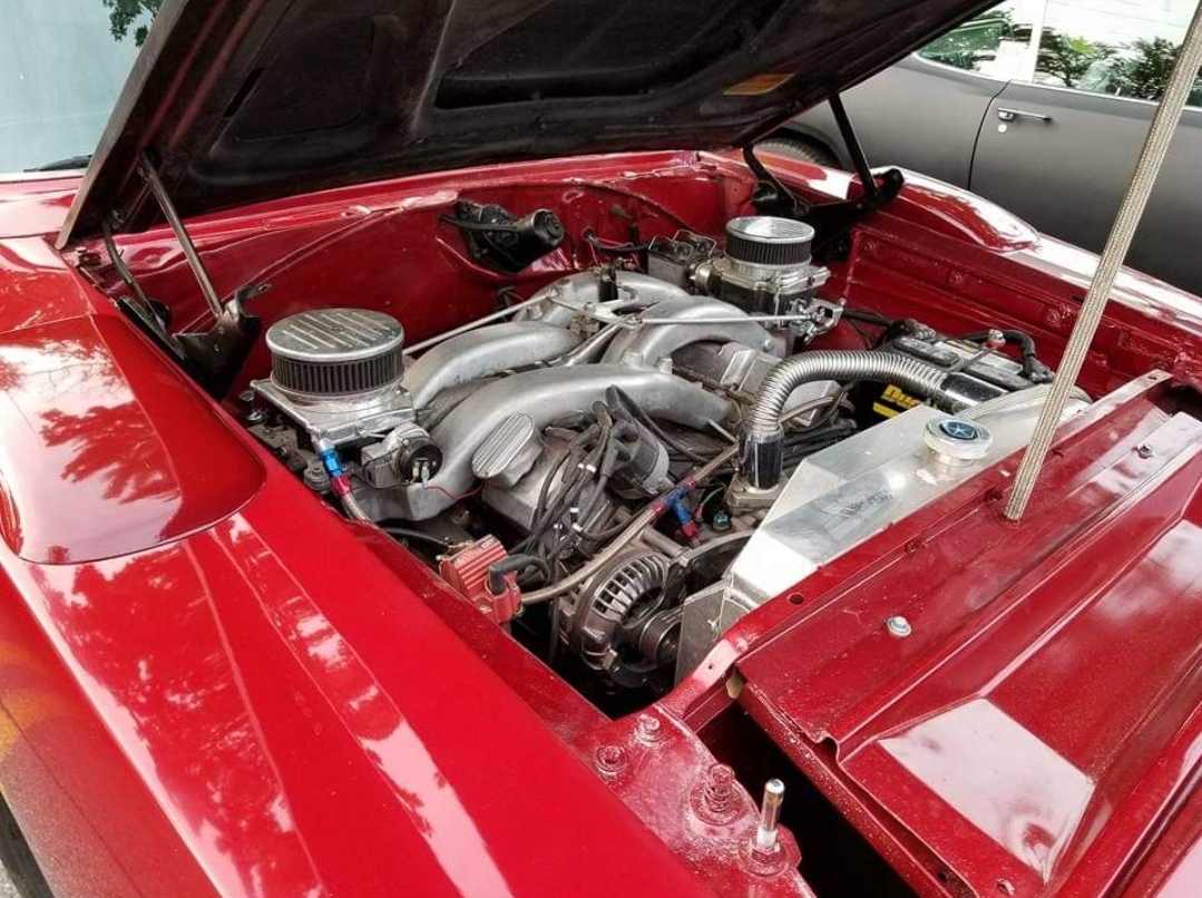

    This one is a 413 in a dodge Daytona clone, certainly unexpected when he lifts the hood

    A crossram 413 in a Charger Daytona is definitely unexpected. But being fed with a pair of Carter ThermoQuads is really the icing on the cake! With electric choke thermostats on them no less. It mustn't be too troublesome to run true spread-bore carbs on them.

    There have been aluminum adapters that change an intake square bore carb pattern to a spread bore carb around for years. The early versions also worked the other way by flipping them over, turning a spread bore intake into a square carb base. I believe the latest versions you bought to go which ever direction you wanted to go. Those adapters were cheap back in the 1980s.

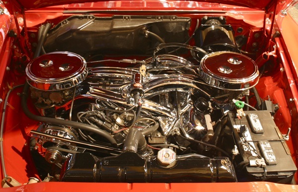

    This picture gives a pretty good illustration of clearances.
    Definitely pushes the limits. Carburetors are almost into the inner fenders. Obvious why they use the small diameter low profile air cleaners. Looks to me that the carburetors are roughly the same height as if sitting on a typical high-rise four barrel intake. The whole thing is just about 4' wide with the air cleaners.
