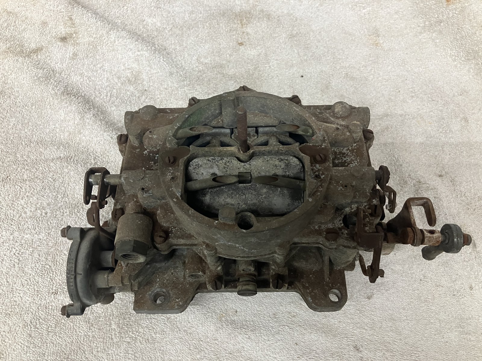

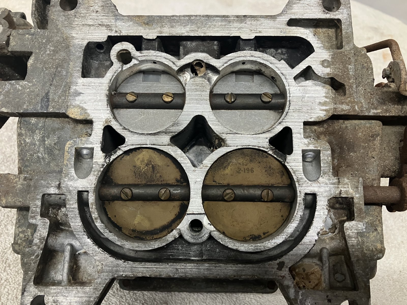

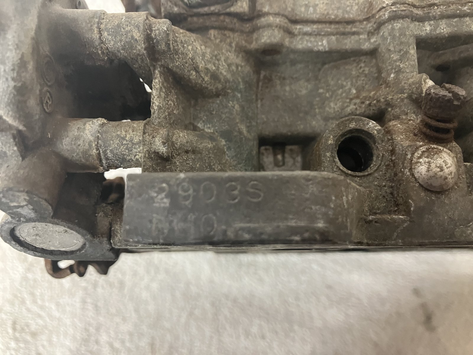

    Pics of a 2903S I have showing the bores.

    The primaries and the secondaries are definitely not always exactly the same size on the AFB carburetors. But they're considered to be square bore.
    @carbking suggested that maybe they should be called "almost square bore".
    Having the original carburetors isn't as critical as I feared. There are other models we can make work. And in fact, I found out that there's at least one minor shortcoming with the original AFB 2903S carburetors. Apparently, the idle adjustment screw is actually an air bleed needle valve located in a spot that's difficult to reach. But that port can easily be closed off and a standard type idle adjustment screw added to the more common location, contacting the actual throttle.

    The majority of factory AFBs have a .25 inch difference between the primary and secondary throttle plates (1.44 vs. 1.69). A lot of the late '50s/early '60s Mopar AFBs had the same size front and rear.
