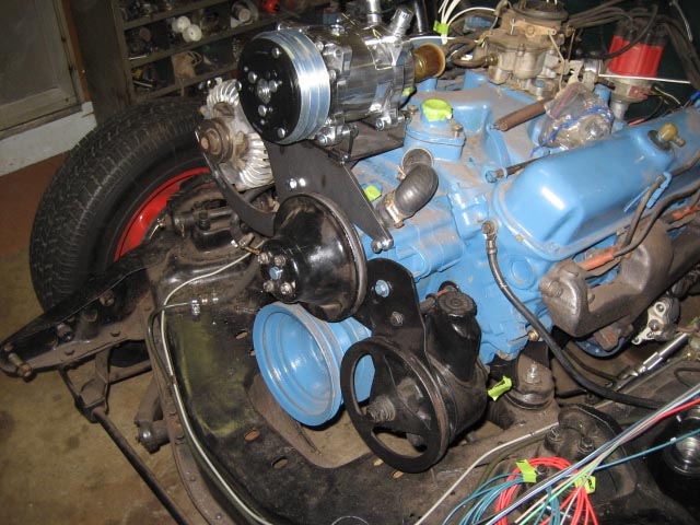

    I had to shorten up the power steering pump bracket on my 318 (from a 70 model) that I put in my 48 Dodge. Trimed it and put new a new slot and mounting hole in it.

    41 C28,
    That bracket and pump looks like the unit I have. My rear bracket bolts on the block very low though. I will need to bring it up higher to clear. It looks like you fabbed up an alternator bracket as well. l picked up a "generic" chrome one at a swap meet last week but it sits too close to the valve cover. I will probably bring it out with some simple spacers.
