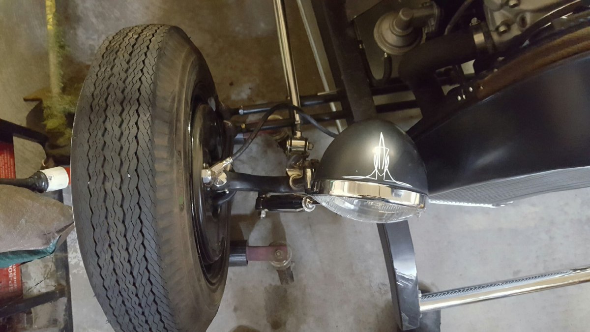

    Here is what I'm working on.

    I take it that it is bent. Hard to tell from the picture.
    My reason for recommending a heavy truck shop is that bending an i-beam axle is how a semi-truck is aligned.

    I don't think that is a hard fix outside of you or who ever does the work will have to pull it off and strip it down to bare axle. I doubt if it can be pulled back while on the rig.
    There should be several shops in the Tacoma area that can press it back in shape though.
    Here is one possibility http://gittspring.com/
    Another one might be right way spring in Tacoma https://www.yellowpages.com/tacoma-wa/mip/right-way-spring-co-inc-6469099
    Most of the rod shops aren't going to have a press that they can fit the axle in to press it back straight.
    What's going to have to be done is that it will have to be laid in a press and straightened back out and then set up and checked to make sure the king pin holes are square with each other and have the right setup for correct camber. That can be set with the axle on the car though.
