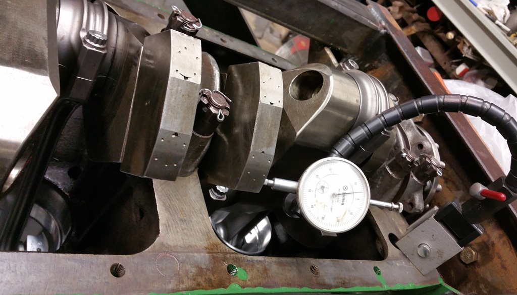

    Forged Steel Crankshaft with bolt on bob weights. A really nice piece of machine work. Here you can see the polished rods and an early "4 bolt" main cap! The car's engine # ("J" number) is stamped into the crank, but we had already moved it around by the time I took this picture. (trying to take pics AND get work done)
    This is "J-476"
    302GMC and falcongeorge like this.

    Here is the "secret"(?) of how/why these Duesenberg straight 8's were so smooth. The piece with the two dowel pin holes is one of two mercury filled canisters that act as a harmonic dampener! The other is hard to see in this photo. this is on the very front crank throw. you can also see how/where the bob weights are attached with bolts that are made to break off (the heads) when fully torqued. all cool stuff from a time long since passed....

  15. Mr Weps,a question for you....In the photo in post #10.it looks as there is a filler plug(and also staked)in one of the crank throws..Was this where maybe some heavy metal was added for balancing? I know we did this back in the 50s for cranks that needed it.

    Also,you are correct about the "heavy metal" used on the crank throws.
    I am not certain that it is "Mallory metal", I will have to ask.

    I'm late on this, but I just ran across this thread. What look like a plug is actually the remains of a shoulder bolt that attaches the counterweights. After the weights are bolted on, the heads are removed when the outside diameter of the crank is machined. The remaining shoulder of the bolt is staked so it doesn't back out.
    the attached pictures show a bolt, and the bolt on weights.
