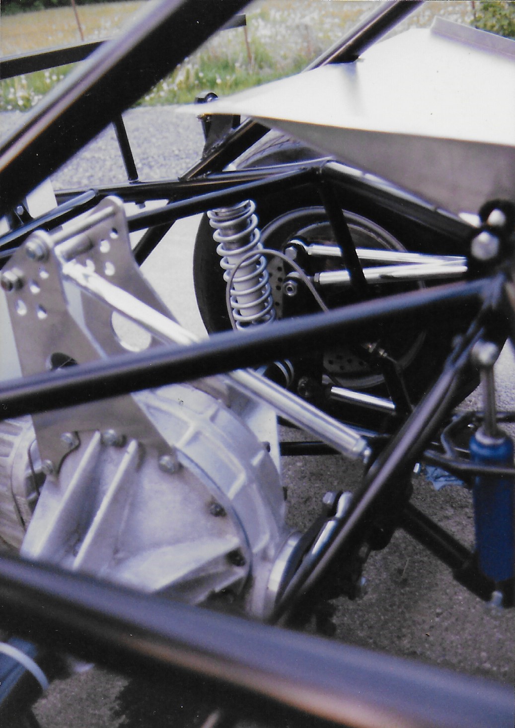

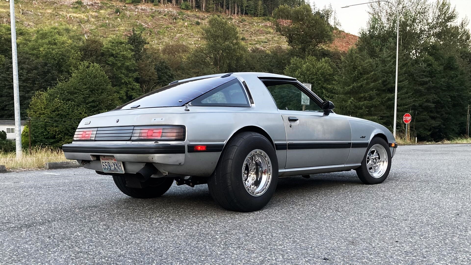

    I used to race dirt latemodels, decided to put wide-5 wheels on the back of my current hotrod...
    Currently using wide-5 adapters, only reason it doesn't have a quickchange is I got lazy and didn't want to modify the gas tank.
    I built this double engine dirt latemodel back in the early 90's, the front had '70's Chevy pickup spindles that I made wide-5 spindle adapter sleeves for. I didn't bother making them screw-on, red Loc***e kept them from spinning and the stock spindle nut on the Chevy spindle kept them in place...
    An old Frankland that I refurbished for the rotary powered latemodel above, it was pulled out of a brier patch...
    Grant
