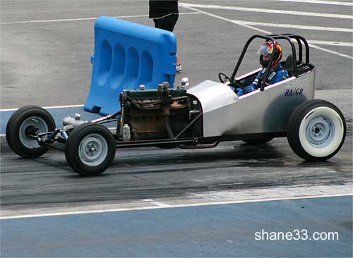

    Now for something you'll really like, my friends from Clovis sent me a picture of their latest mods to the Pontiac Straight 8 of theirs, wish the picture was larger...............

    Holy ****, that's beautiful! :cool:
    We're likely going back to an iron exhaust manifold at some point (for several reasons). Damn, I'm gonna miss the stacks. :(
