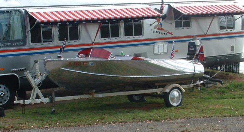

    Heres a test i did with the port-a-walls...
    they looked fantastic at first, but on one wheel if made a flap that i could not remove.
    So i went to the grinding you can see in video above.
    Here are results.
    Now the port-a-walls wotked great on the boat trailer.
    Those are 12" tires.
