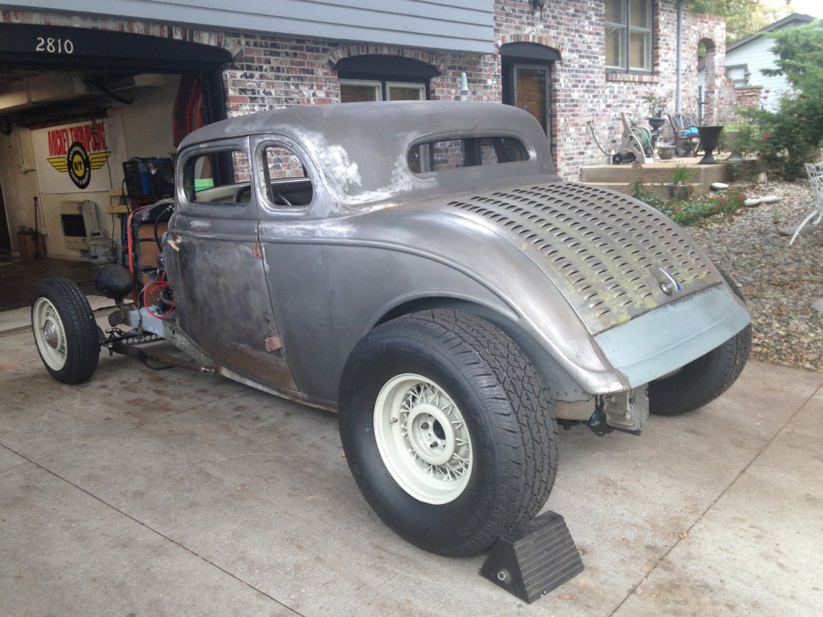

    Suggestion please got a set of tires from a nice guy on here. The car had 10 inch racemaster piecrust on it but were so far gone from sitting. The guy sold me 775-15 radiir slicks. Tell me what you think guys because it totally changed the look. Before is in the driveway and after is in the garage!!! Go bigger or stay that size. Also, there was only maybe a pinky finger gap between the rear quarter and 10 inch slicks!! Thanks guys!!![​IMG][​IMG]

    If your going with fenders you need to install them beforehand.
    It looks as if your trying to fit into a 1940’s50’s timeframe with that engine so my opinion is to not use them and go with a set of bias ply tall and skinnies.
    Don’t mix your decades.

    Are you gonna run fenders?

    that was my first thought. that coupe is a long way from the road.
    leave the rollers on there, till it is done, while keeping your eye out for a deal.

    Well, the old ones were too wide for the wheels= handling issue. The new ones fit the wheel better.

    Spencer: These cars have HUGE wheel wells and need tall tires. I think you'd like it better with tall ones unless you can lower the back a lot.

    8.20-15 tires and a heavy channel

    Thanks guys really appreciate all the advice. The tall ones made the car look mean. These once make her look like a cl***y broad. I think i am going to use them for a roller and then when she is ready for the road in june cough cough...i am going to order some bigger ones because everytime i walked out into the garage before i would smile. Now i am like wtf. Is it cool or ewww. You guys definetly have a point. It should make me smile!!!

    Welp, first off, I'd HAVE to bring the back end down with the wheels/tires you'll be running. Then, with only a pinky finger of clearance, I'd either get some wheels with more positive offset, flip the centers on your present wheels or score a pair of 1" wheel spacers.

    Remember, if you build with the wrong tires as your templates:
    You will have the wrong rake, caster, ride height, fenderwell clearance......unless you are building on a ch***is plate with adjustable ride height when finished.

    My tire sizes are:
    Fronts. Firestone "560" in 145/15 and
    Rears..BFGoodrich 285/70R15 from Coker tires. Fronts are about 24" and rears are 30.5" tall

    Rocky has it right. His rear tires match the body wheel arch perfectly
