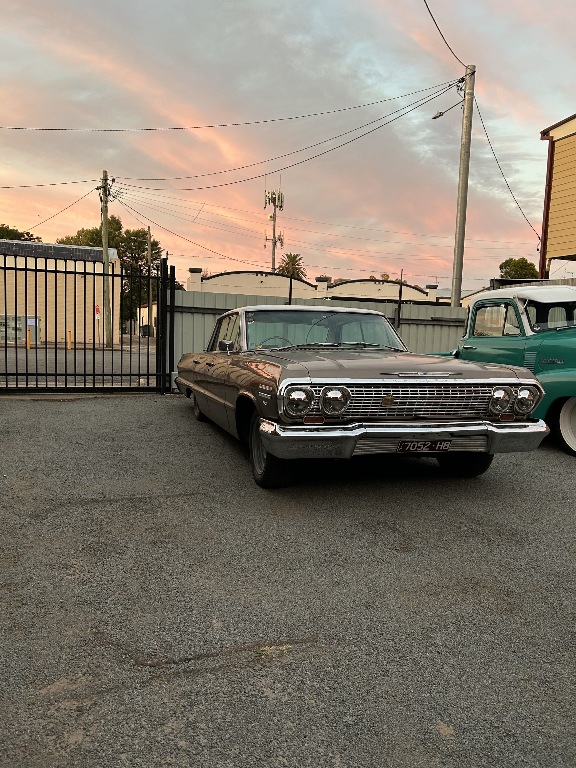

    trying to get more into the drag racing aide of things with my 63 impala, with my 350 chev just looking for some tips/ways to get as much horsepower i can while keeping it naturally aspirated?
    Theres alot of knowledgeable people on here so any tips would be great on where to start. Its already got a cam and 650 holly.
    Cheers heres a picture of us at the 40th annual rod run in narrandera australia
