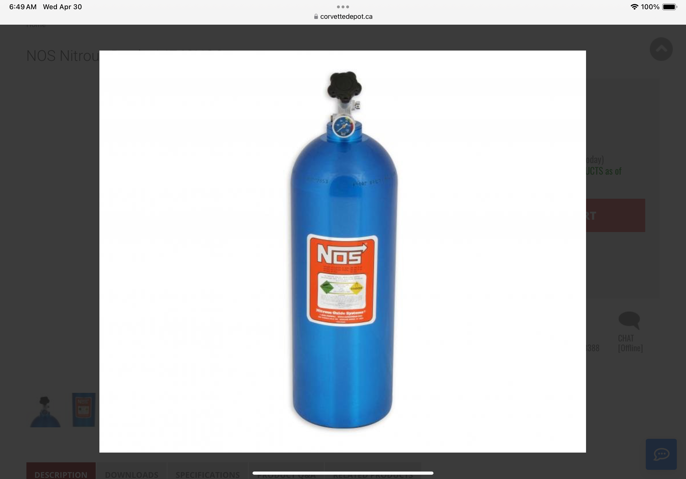

    Like @RmK57 said
    Euro for Euro easiest is
    H-P in Bottle ,
    H-P per Euro
    Not that Hard with supplied instructions /recommendations
    For non experienced wanting to go faster with Limited funds,
    175 shot ,:cool:
    Just a Gas!

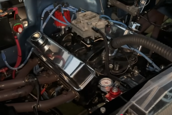

    with the existing set up a good tune and gears
