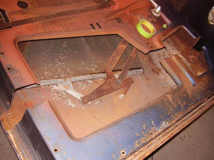

    got the drivers side fender cut, fitted, and tack welded,,,,,,and got the drivers door done also......i separated the lower skin from the door frame, removed my two inches from the frame, slid the frame up two inches, tacked the frame in place, reattached the sides of the skin, cut two inches from the bottom of the skin, and folded it back over,,,in doing it this way, i have no weld seam across the doorskin,,,,,i wasnt sure if it would work,,but it worked like a charm,,,,,ill do a few minor things differently on the other skin,,but it turned out awesome,,,,,,,,nice to see the full profile of the car again..........tomorrow, ill tackle the other side,,then its on to the inner fenders, the hood, and sectioning or moving the radiator support,,,,,,,,,,,,here are some pics,,,,(with some closeups of the reskinning of the door)

    looking good, nice idea on how you sectioned the doors, will have to put that one in my files

    sonny daout (hamber, and owner/builder of a BEAUTIFUL sectioned kustom dodge) gave me the tip on doing the door that way,,,
