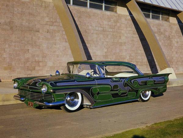

    for some reason i feel that this car is craving some nasty goopy peaks like the maze
  11. Kustom7777
    Posts: 5,188
    Kustom7777
    from Austin, TX
    huh?
  12. Dago Red
    Joined: May 22, 2002
    Posts: 314
    Dago Red
    from Delaware
    The Maze.
  13. Kustom7777
    Posts: 5,188
    Kustom7777
    from Austin, TX
    oh,,,ok,,,
    there will some SUBTLE scoopage (is that a word?..it is now,,,hah)...
    not like scoopy doo,,,(joe bailon on crack),,,,
    this build was actually partly inspired by a bailon car,,(but his wasnt chopped and sectioned)...
