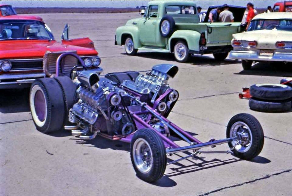

    As we can see above these twin engine where side-by-side...front-to-back...many
    combinations in a quest for more 'scoot'.
    One question I have is.... how were they connected(side-by-side) a chain OR gears OR ??
    The front-to-back pretty much same question... A coupling...a clutch set-up....WELDED crank !??
    The side-by-sides....all the power was focused through one clutch. Was it twin disc....multi disc?!
    When they 'fired 'em up'...I wonder what happened IF one engine didn't 'catch' and didn't fire ?
    Did they start with just ONE starter...or were they all still push-started !
    The gear ratio in the diff.....Did they run a taller gear to take advantage of DOUBLE the horsepower OR did they still use the same gear ratio as single engine rails and depend on the tires to "try" and bite enough to propel them down the track?
    How critical was it for the tuner to get BOTH engines to make the same power ?!
    (Prudhomme was just a kid here.....wonder how old he was when he got into pro drag racing)

    On the front-to-backs I remember seeing sprockets with a double roller chain. But there were probably other ways too. On the side-by-sides, I think they meshed the flywheels which means one engine had to rotate opposite direction, so a special cam (or marine cam). Can’t answer about clutch or gear ratios.

    Several WW2 era engines had this format (GM Model 6046 is a good example) so maybe some racers with a military background took there ideas from that.

    I’ve seen pics of a WWII tank engine that was produced by Chrysler….5 inline flathead sixes connected at flywheels, stacked up in a weird circle. Imagine doing a tuneup on that monster!

    I would have recommended a bigger chain.

    Not sure about the one pictured, but Eddie Hill's twin Pontiac dragster actually "used two complete and separate drivetrains all the way to the rear axle. Each engine had its own flywheel, clutch, driveshaft, and ring-and-pinion. The ring gears were bolted solidly to a huge rear axle that was machined out of oil-field, drill-stem tubing".
    more:https://www.motortrend.com/news/vintage-twin-engine-dragsters-from-the-1960s/

    And back in the 60s, there was that twin engine show car on the cover of Hot Rod magazine. Twin Pontiac engines, and 2 Jaguar rear ends. Short shaft between the two differentials.

    Ivo had some radical rides back in the day. The Wagon Master had 4 in that creation.
