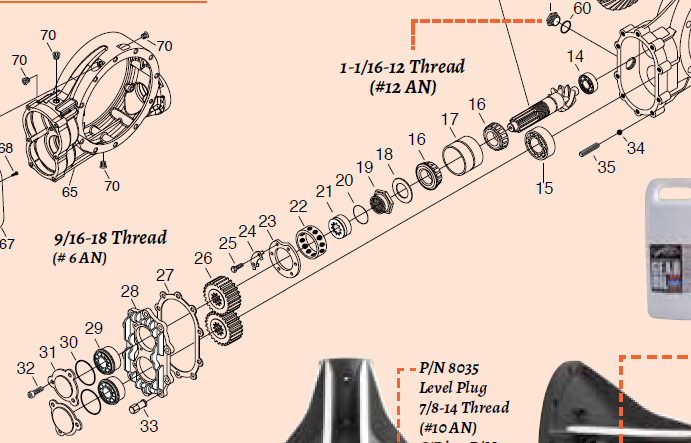

    resurrection of a older thread. Today I opened the rear cover to inspect and found that the PO had installed Winters Helical cut gears. All ok with the exception that the top gear can walk between the case and rear bearing. Is there a shim/spacer which goes on the top gear shaft> There is a spacer on the bottom shaft.
  5. Yes the shims are available from Winters.
  6. gimpyshotrods
    Joined: May 20, 2009
    Posts: 24,516
    gimpyshotrods
    Helical gears are a popular upgrade on the street. They are quite a bit quieter than straight-cut ones.
    Yes. If they are 1" gears, then they must use a spacer. If they are 1-3/8" gears.
    The spacers are Winters 1372.
    Also, make sure that the shoulder on each gear is toward the bearing.
